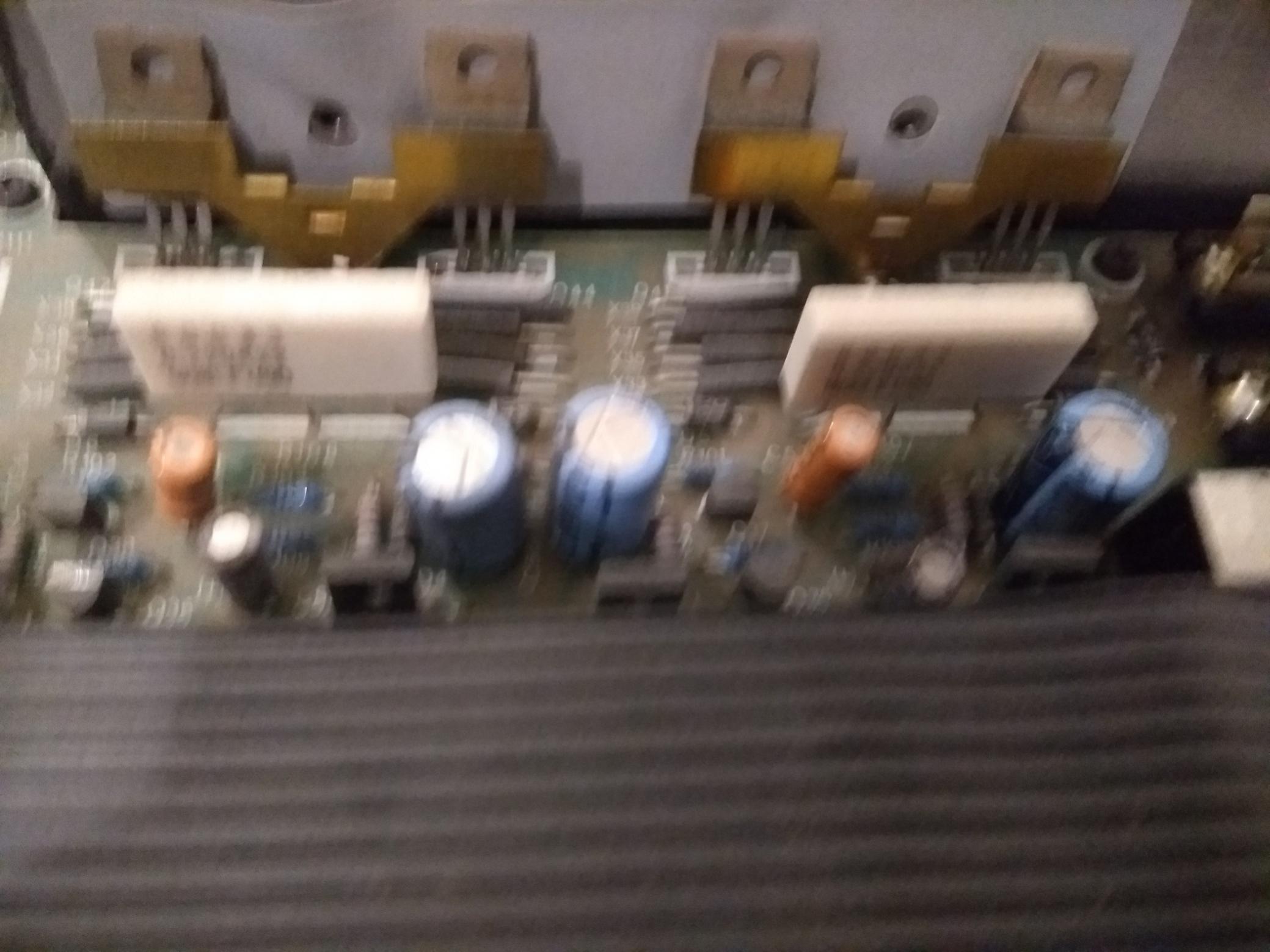

I have an old Rotel amp that failed probably driver or pre section, tried to fix with help of this forum many years ago but completely failed and abandoned :eek:

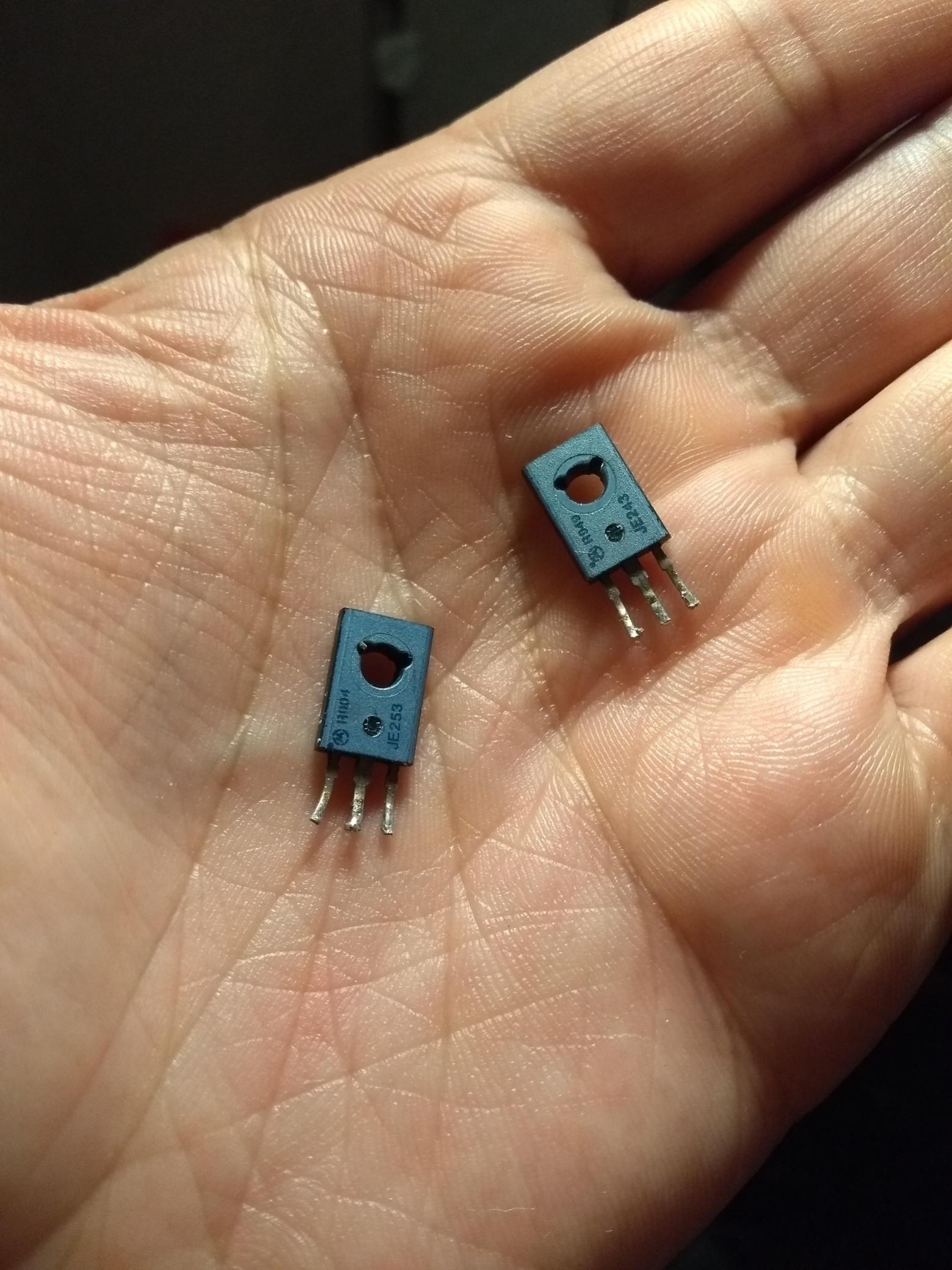

I not only managed to find working D1047's but also one pair of used (god knows where I got them from) MJE transistors for drive section!! There are 8 D1047's 4 of them should be working at least and the MJE works as I just tested them, they didn't beep :) gave me like 720 result on both legs. Have no idea what that means but from what I read it should be ok. As long as I didn't blow the other channel powering it up I have everything I need right here!
I really hope I'm right about all this. Any advice appreciated.

Original BUV28 transistors are only a TO220 size package and I think we are aware, just by catalogue illustrations, what that looks like but the recommended replacement type is TO218, now TO247 size, as fitted in later models. Look again at the pics of Cyrus 1 and 2 at Paul Kemble's site. Notice the different size power transistors? Pin spacings are doubled too. You can always use your browser to check the package type in seller's catalogues if you can't find datasheets with the specifications.

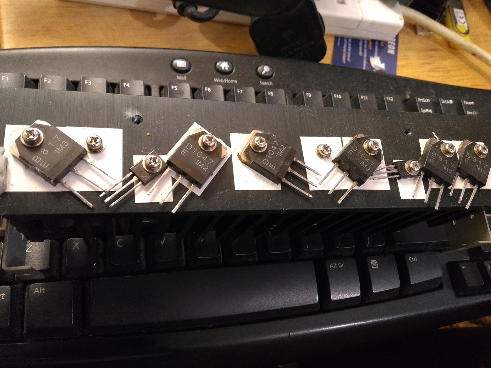

As advised earlier, I would not plan to use those TO3P sized 2SD1047 types even if they can be squeezed in, BTW. Since you can't source the original size and type transistors, it occurs to me that Naim used NA005 (a house code) switching transistors in all their Nait series integrated amps, incuding NAP90. These were TO220 size, similar to BD743, now replaced by BD911. The latter are really tough and probably one of the few T0220 sized transistors that will be up to the task, provided you use correct thin mica/white grease mounting insulation. (Some cheapo mica washers are sliced like slabs, 5 times thicker than they should be).
I hate not having the amplifier in front of me! I will take it out of the bedroom and have it ready for tomorrow nights tinkering :) As the famous saying goes if fits , I sits lol for me cost is an issue. 4 x new transistors = £10+ and drivers £5+ and new caps perhaps = £ infinity! and waiting for delivery. I have CPU paste here and maybe thermal pads that fits. At least if I can check it works fine I can give it to a mate, he can finish it off.
I'm a bit confused now Ian are you saying I can use BD911? Instead of D1047? If so why are all these transistors compatible? I thought you couldn't do things like that!?!

Your PCB will be drilled for TO220 spacing, same as the drivers in your pic - that's tiny! The legs on larger transistors can be carefully crooked to a narrower spacing too but only with some types that also have narrow pins. A lot of recent power transistor manufactures seem to have very wide pins which may fracture if tortured to get the device low enough to the PCB to clamp correctly at the point where the heat spreader on the rear is evenly clamped to the heatsink. Well, I'm just saying that they'll sit too high off the PCB.
I'm suggesting a rethink, depending on the actual part dimensions. I've already emphasised that the original transistor type is a power switching transistor and that is the characteristic you'll see on datasheet headlines if you read them. That brings to mind other switching TO220 switching types like BD911 or MJE13009, FJ13009 etc. which I've also seen as replacements in Naits, since only Naim agents can access original factory spec. and probably matched parts.

I wasn't aware that that both those tough drivers had also blown. That must have been one mighty blowout and I'd suspect more than just the output stage was damaged.
I doubt your forum source was talking of lower distortion meaning measured distortion. Perhaps it's a subjective assessment based on a memory of how the amplifier sounded earlier? In any case, the suggestions seem to say that any cheap power transistor in a TO220 case is OK to use. Well, they may work, but I suggest not using a slug like MJE3055 if you expect better than passable audio. Use types with at least similar characteristics if you can't afford the appropriate ones.
Don't use silicone rubber washers or CPU grease - its often conductive to some degree, regardless of claims and you need mica for maximum heat conduction with small transistors. Just consider that if you are on a tight budget and make one slip-up, you have nothing left but another box to stow somewhere :(

I'd like to add that for a TO-220, the On-Semi MJE15032 is rated at 8 amperes and should work well in that amplifier. The 2N6488 is another tough transistor in TO-220 that should also work well and is rated for 15 amperes.

I know for a fact I have the below and will add to the list:
D1047
2SC5359 - Suitable for use in 100-W high fidelity audio amplifier’s output stage

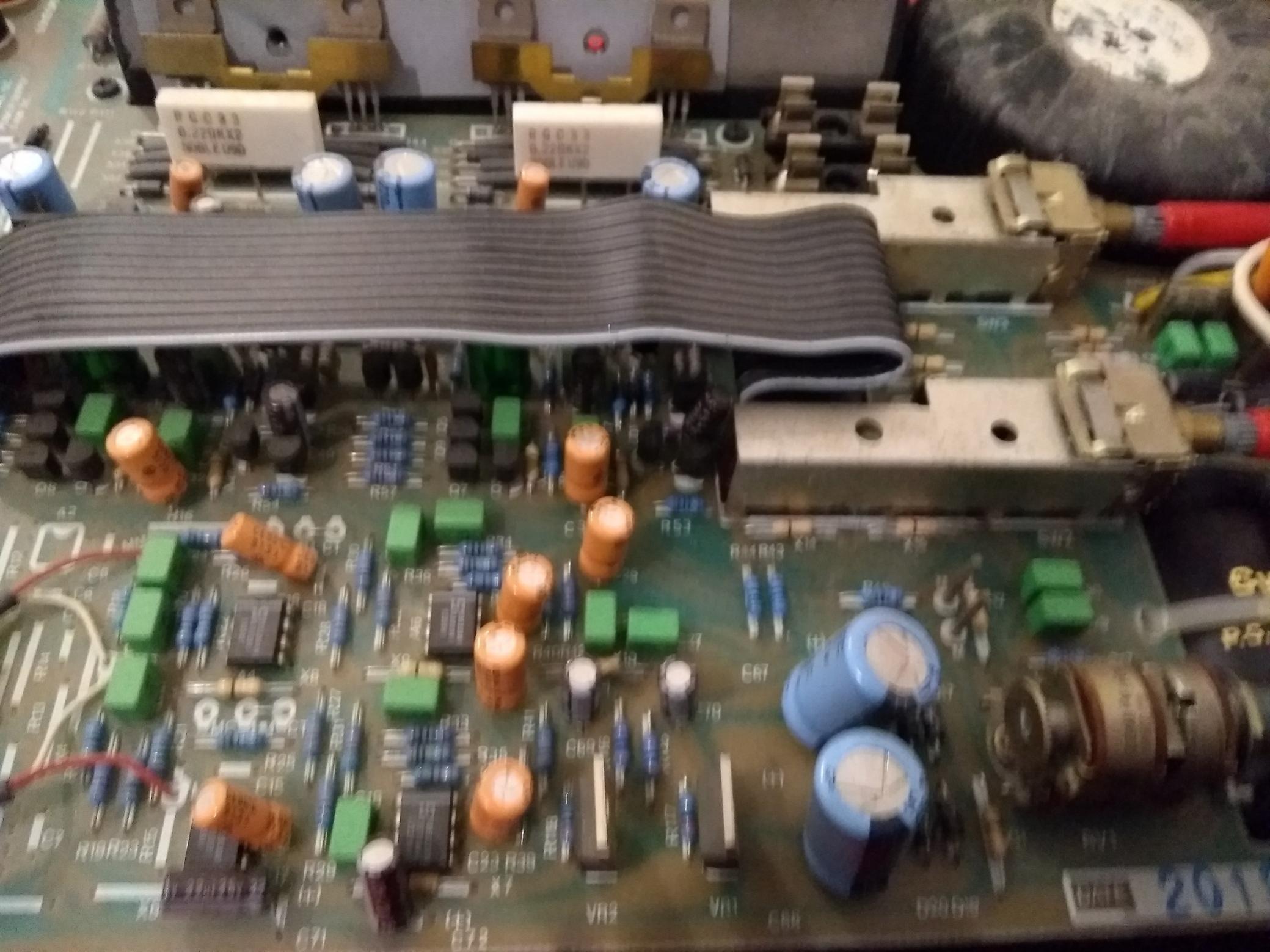

I got it!!
After inspection I check the external fuse and it was blown. After replacing it it blew again. After replacing it with a higher wattage fuse because that's all I had it blew the internal fuses.
That is definitely advanced technician fault finding mode you were working in :D Keep increasing the value of the fuses until the actual fault makes it presence felt by components exploding or catching fire.

Kids in bed and the amp is out!
