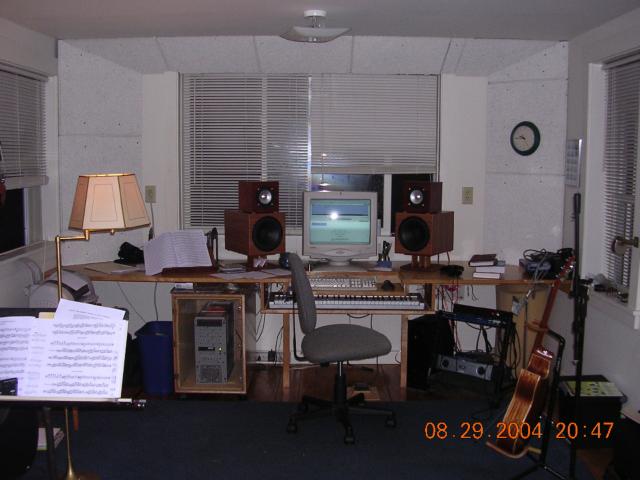

Hi dvdwmth - Here's my 2 cents worth. I run a project studio where I produce music of a variety of genres, but especially classical music and related acoustic styles. I struggled for some time to find monitors that would reproduce the broad tonal and dynamic range of orchestral music. I have to dissagree with a few things said in this thread. One, that low end is not important to symphonic music. One of the prime ingredients in an orchestral recording is the ambience of the hall. Large spaces have low modes which distinctly color the character of recordings made in them. You simply can't hear a space unless your speakers can reproduce low resonances, however subtle. You may also miss some low fundamentals in pieces by composers who use organ pedals as sub-bass instruments. Another essense of classical recordings is honesty of sound, accuaracy of reproduction of the live event. You can't experience that without a flat system that approaches the full range of hearing. I feel you also need a system that presents fundamentals and their overtones from the same location - full range drivers are the only speakers that can accomplish this. To me, crossovers that seperate overtones into tweeters may handle a rock ensemble ok but can fall on their faces on a wind quintet and often simply sound like grit. The other major problem you face is the interaction of your speakers and the listening space. Even if your speakers produce a good sonic image of a concert hall, your room will make it sound like it's in your room - confusing. There are many ways to work with those problems but it can be complex and expensive. My solutions were not too difficult since I don't listen to music on a sofa 12 feet away from my speakers against the opposite wall. I do all my auditioning in the near field. My speakers are placed so I get very little early reflection (thus reduced comb filtering, etc). I have given basic treatment to the corners of the monitoring end of my room to kill the most problematic bass modes. My system is PC based and includes:

Jordan JX92s drivers in small closed cabs, actively crossed over at 110hz to 8" peerless Subs in small closed cabs. The limits are that I listen at moderate volumes (by rock standards, still quite loud in forte passages) and the system is not intended for lounge listening.
Another JX92 user! Great! Can I pick your brain? I am hoping to use 5 JX92s in a shallow wall mounted small sealed cabs of about 10 liters each. My typical use for this would be music (classical, jazz and rock) and HT. For the bass I have 4 audio concpets 12" woofers.
The Jordans would be driven by the AV reciever (Marantz SR7000) and the sub with a seperate sub amp. The sub XO freq is 100Hz (from SR7000).
1. should i roll of the Jordan drivers at all?
2. would the 12" woofers mate with the Jordans?
3. what kind of SPLs should I expect at 3m (10ft)?

Hi N - I couldn't find much info about the Audio Concepts subs so I'm not real sure how they would mate with the Jordans. I think it's important that they have similar sensitivities, but otherwise with a low XO point and bi-amped you have considerable leeway - I like biamped systems. I'm a little confused about how you intend to use 5 drivers - two per channel and one center?
About the high end of the Jordans, Ted has a Zobel-like circuit with resistor and coil that is supposed to flatten out the response in the top end. I built them and tried them but ended up leaving them out. Not a big difference I thought. You may want to try it and see - it's partly a matter of taste and it's pretty easy to add in line EQ of some sort if you need to (though I try to keep the signal path as simple as possible). One thing you should realize is that the Jordan's highs are not as good off-axis as a good tweeter will be, so placement is important and your sweet spot may be tighter. Conversely, as a result they may not sound over-bright in an in-room type installation. Unless you have bad hard surface reflection issues in your room it will probably sound good.
Since it's based around a PC recording studio, I tested my system with measurement mic, tone sweeps, and spectrographic analyzer and found it pretty flat despite room modes. The whole room thing is really tough, so unique to each situation and system. You just have to see. I'd recommend at least doing the math and testing it with a tone generator to identify the modes clearly. I like acoustic ceiling panels for DIY room treatments - cheap, easy to build with and some perform extremely well acoustically. The manufacturer's specs usually list their sound performance - usually the more heavily textured, the better. Wall junctions, especially vertical corners, and vertical centers of walls are the main problem areas for bass modes which are usually the principal culprits in room problems.
Not sure what I'd recommend for the Jordan enclosures if in wall. Ted thinks in-wall is optimal and has a variety of designs posted here: http://www.ejjordan.co.uk/ which seems to be down right now, not sure why. As you can see in the picture I posted, I used the smallest cubes he has for these drivers. My subs are in closed cabs too. I like closed cab sound and the response seems flatter than with ported cabs. Not interested in trying to tease response out of a driver it doesn't want to do, especially when the subs are working the low end. BTW I think stereo subs are great. Despite the conventional wisdom about non-directionality of long waves, my ears told me different when I tried a mono sub in various locations and my sound came to life with stereo subs. Sorry, but not sure what you'd get for spl. Monitoring nearfield I have only been concerned that my system is loud enough up close. Since they are mildly inefflicient, you will need an amp that can put out some power without distorting itself - if you have enough power to drive 5 Jordans you should be pretty damn loud!
Not much help here but I think you're on a good path. I'm very enthusiastic about the sound of fullrange drivers actively crossed and bi-amped with stereo subs. To me, its a whole different world from the normal passive XO vented-box all-in-one speaker thing. I'm sure you can make it work in an open-room listening situation. Let me know how it works out.
