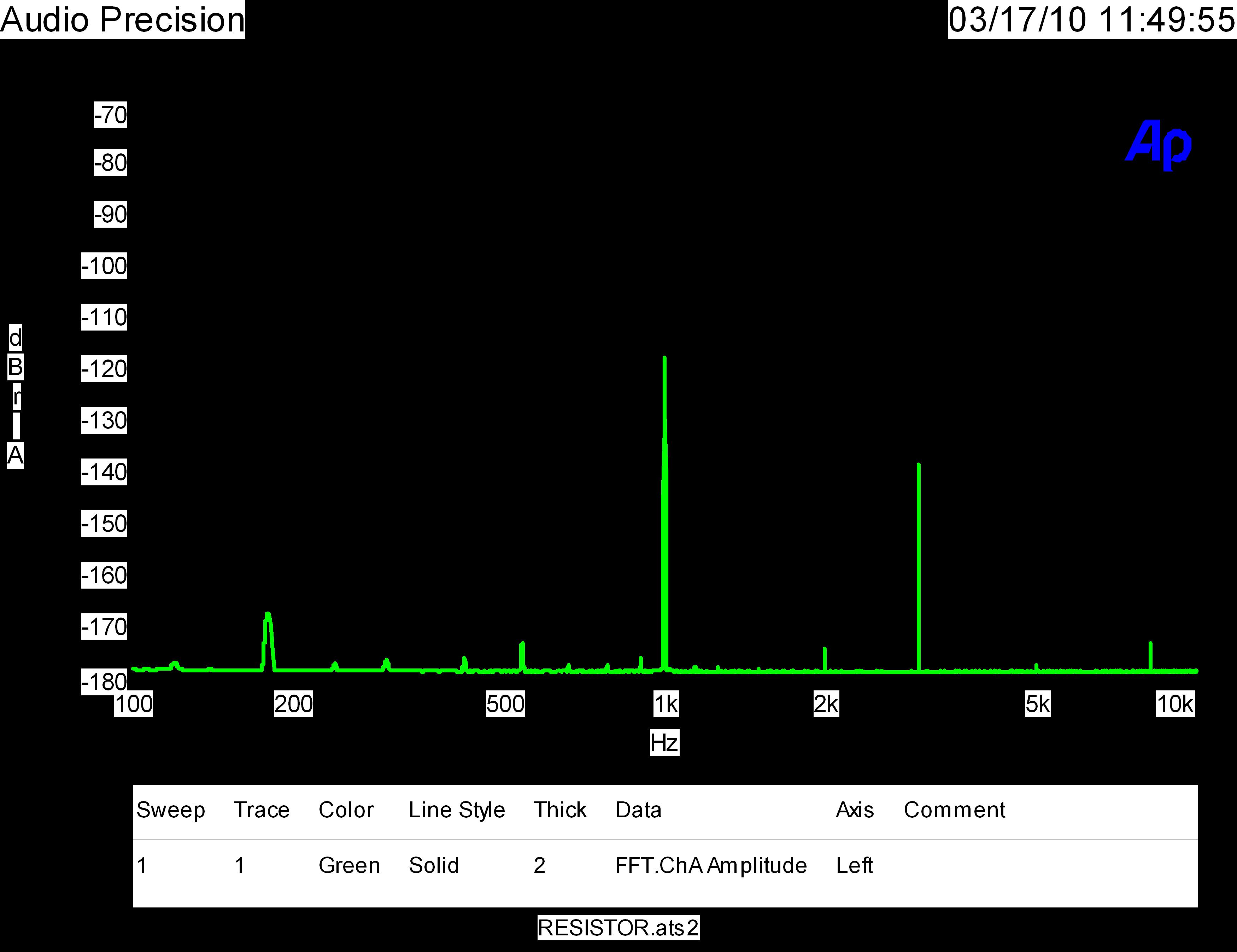

This is the distortion produced by these resistors in my tests as shown in Linear Audio Vol. 1. The 0 db reading is at 1/16 watt. The 1k tone is suppressed by the measurement method. There is very little 2nd harmonic distortion and more 3rd. The third drops by 6 db for every halving of power. It increases by 3 db for every having of test frequency. DC will increase the even order harmonic distortion. Excess noise is shown in the spreading of the base at the 1K test frequency.
So the results you get will depend on the voltage across the resistor.

I believe that most of this distortion is caused by heating of the resistor interacting with the non-zero tempco of the part. These parts had a tempco of 250 ppm, while the very best Vishay parts ($8 each) are only 2 ppm.

The third harmonic on these resistors certainly is a thermal issue. What is interesting is the 9th harmonic also shows up! One of the few resistors that show that high a harmonic!
Most of the resistors measured had third harmonic that seem to related to the tempco, a few did not. The notable cheapie had virtually nothing but third so used at low power should be a low cost cheat.

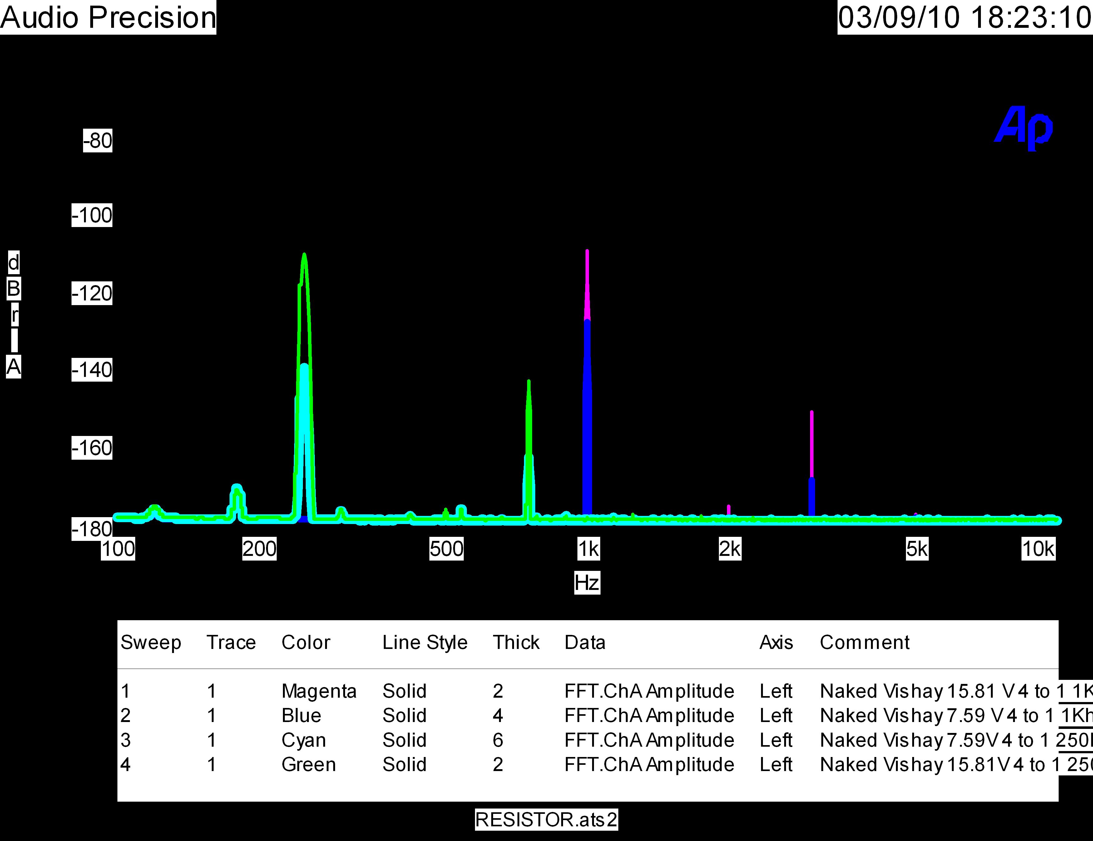

Also note on the bulk metal tests the thermal issues track as expected but are higher than they should be if it were tempco alone.
