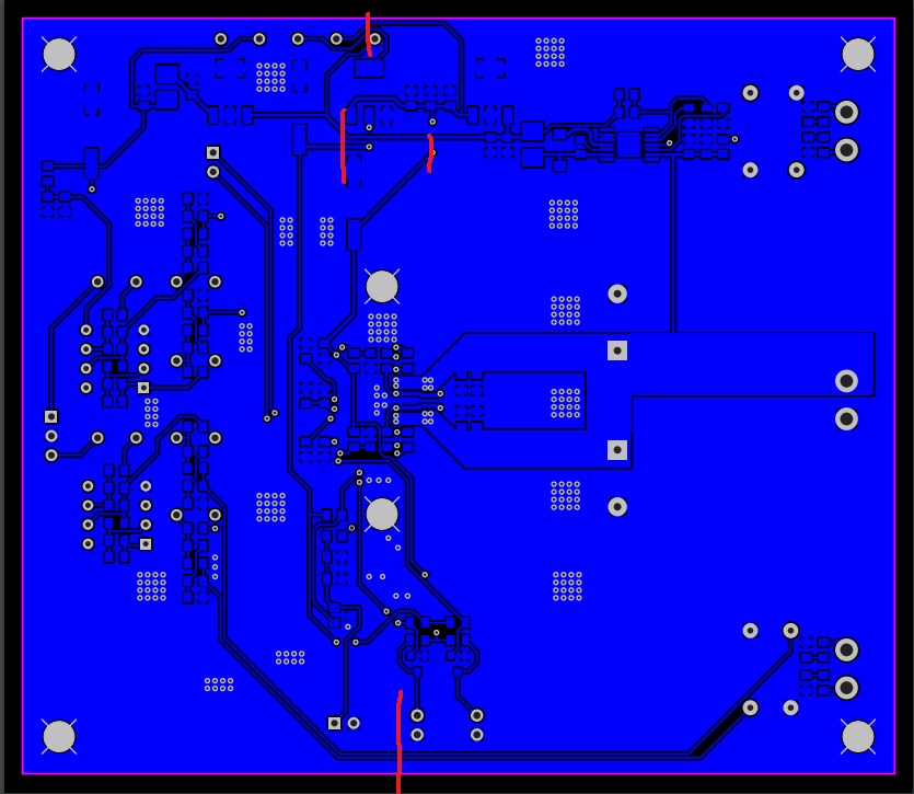

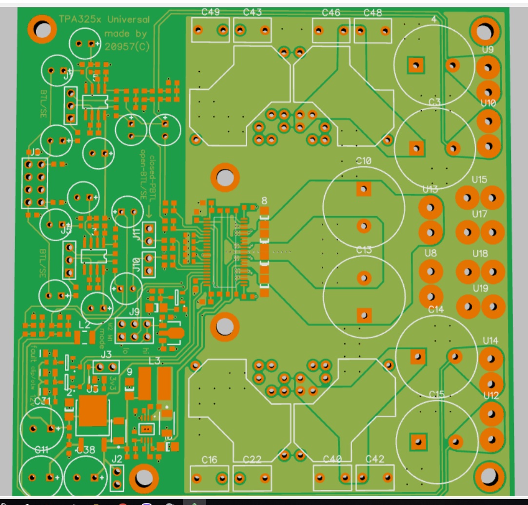

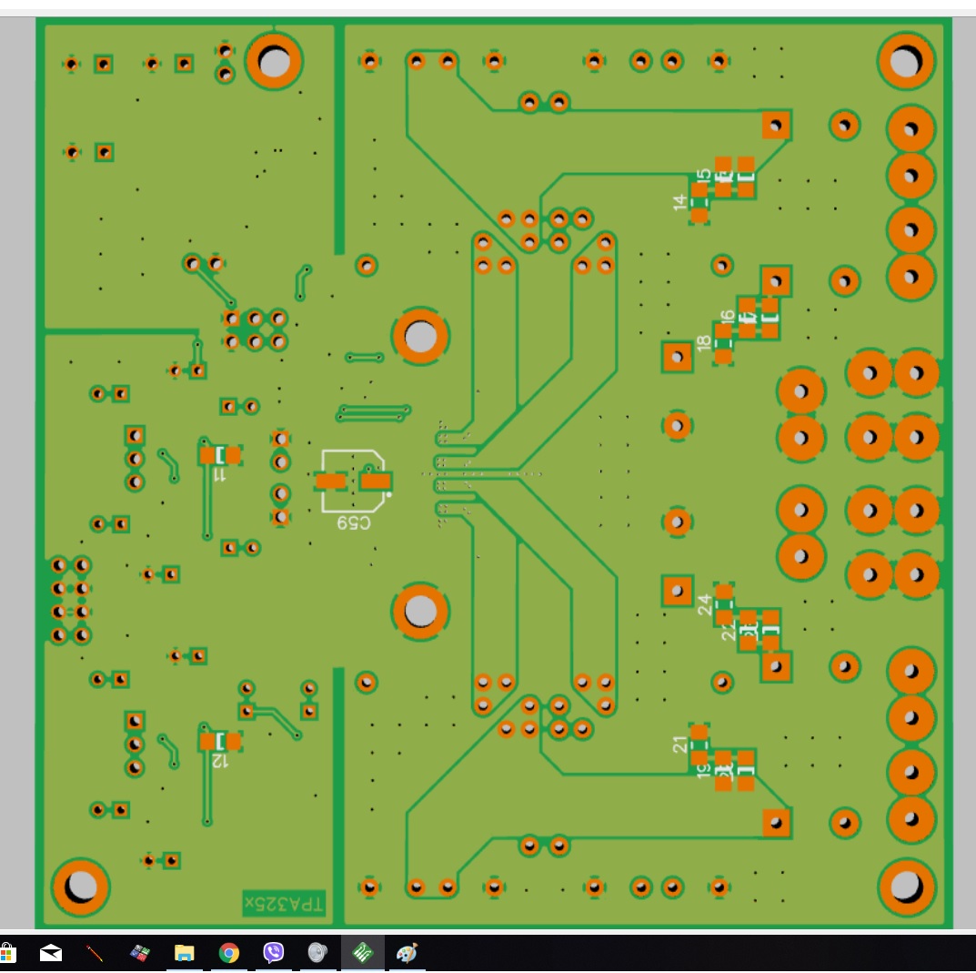

I see you tried to close the gnd-plane as much as possible. As there may circulate big ac currents through it this can cause noise on the analog input area of the pcb. For that reason on my design there is a separated AGND island on the left side, connected once via a 0R resistor with the power plane.
delete a loop
Thanks for suggestion, but it didn't help
chip is not damaged?
I have 2 prototypes, both identical. I was wondering if there was a wrong batch produced. I'm usually the "lucky" one if it comes to wrong batches and other hiccups. All chips were bought at Mouser, so I expect them to be genuine. I have different batch of TPA chips on hand, but I'd rather sell them than experiment further (and come back to my great sounding class AB amp)

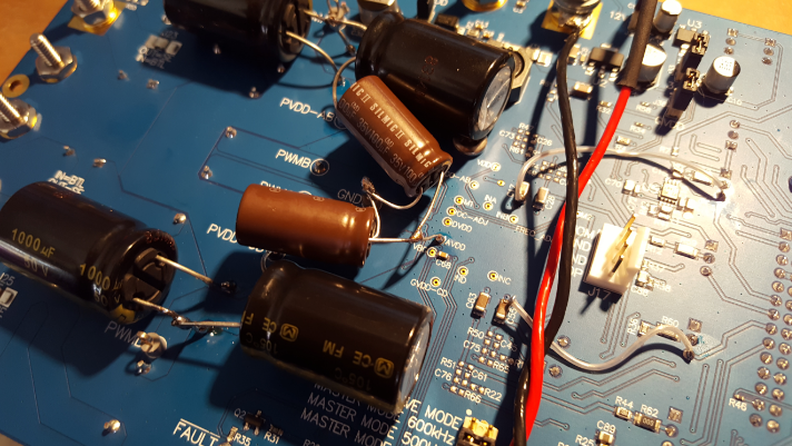

Couldn't wait longer and made this modification. I was not courageous this time and added only 2 small Elna Silmic II 35V 100µF in //. Still much bigger than onboard 1µF ceramic. At first start the fuse of additional 12V psu blew, sign of some additional current flowing unfortunately through tpa chip. After changing to a stepped up one, the amp start to sing.I will be interested to hear from greinedo if adding a big cap to AVDD achieves even more improvement.
Definitively another improvement with those caps decoupling AVDD. There is certainly a burn in time, but right now there is already more consistent bass, more autority, improved stereo image. Seems to me more balanced and easier listening. Will listen a bit before trying to go further.
Thanks guys for these very good ideas of improvements.
Thanks for the report. Without doing a before/after comparison myself, I think I will just go ahead and add a 1000uF/16V Nichicon HZ cap to AVDD. Or maybe two?Definitively another improvement with those caps decoupling AVDD.

That sounds like a serious layout issue. Beside that, the Foilcaps seem to catch up some radiated HF which gets demodulated in the front-end.
Schematic would help. May you also upload some pics of populated PCB? Is your heatsink grounded on both sides?
