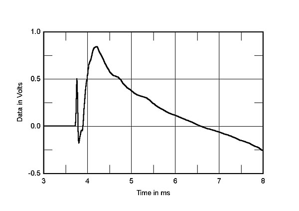

Here is an example of a rare transient-perfect (hence, time aligned) speaker measured by Stereophile. According to John Atkinson, he can count the speakers that he has measured as transient perfect and time aligned on one hand. It is the Dunlavey SC-IV and this is what transient perfect looks like - the tweeter rising edge coincides with the mid rising edge and the woofer rising edge and they form a sort of right triangle. All the leading edges go in the same direction:
The impulse response also shows a single peak that shows all impulses aligned in time and in direction:

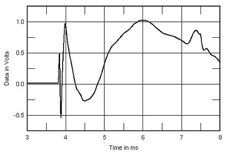

A LR 2nd or 4th order cannot do this. Examples of highly acclaimed speakers using LR2 and LR4 crossovers generally look like a mess. An example of the step response of one is shown here:
Note how none of the peaks align in time and the sense of up and down are all mixed up. Use of even order LR2 usually requires one of the drivers to be in anti-phase so that the tweeter is usually the one going down while the woofer goes up. This is the highly regarded B&W 802D.
Here is a Sonus Faber Venere 2.5, a little better but not perfect:
But move into a higher bracket 4 way model like the Sonus Faber Stradivare and you get a mess again:
