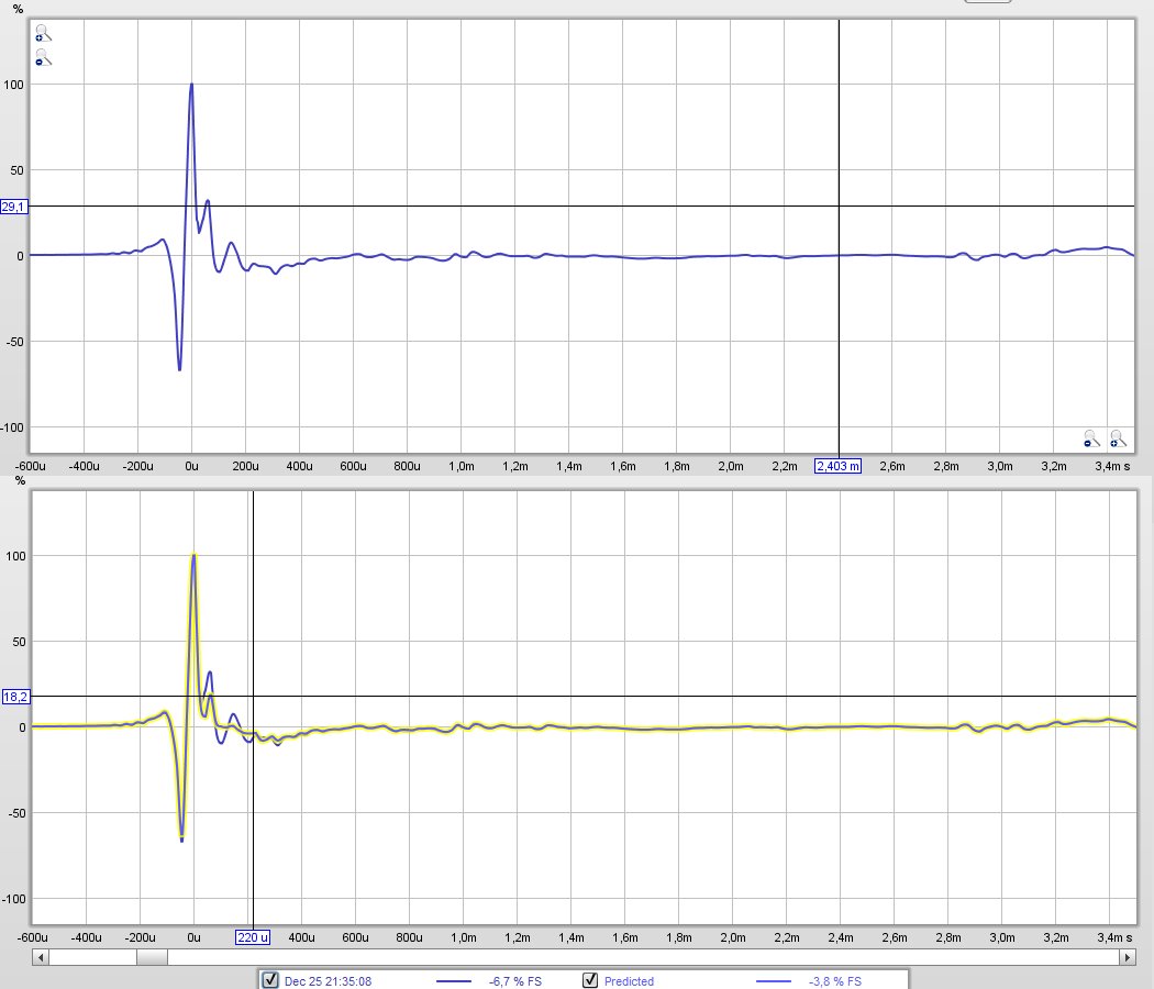

Let's figure out what those wiggles in the tweeter IR are. First I hope we all can agree that the up/down peak is a consequence of the phase rotation of the tweeter, part of it is caused by the filter on the tweeter. However the short waveguide will play a role too.

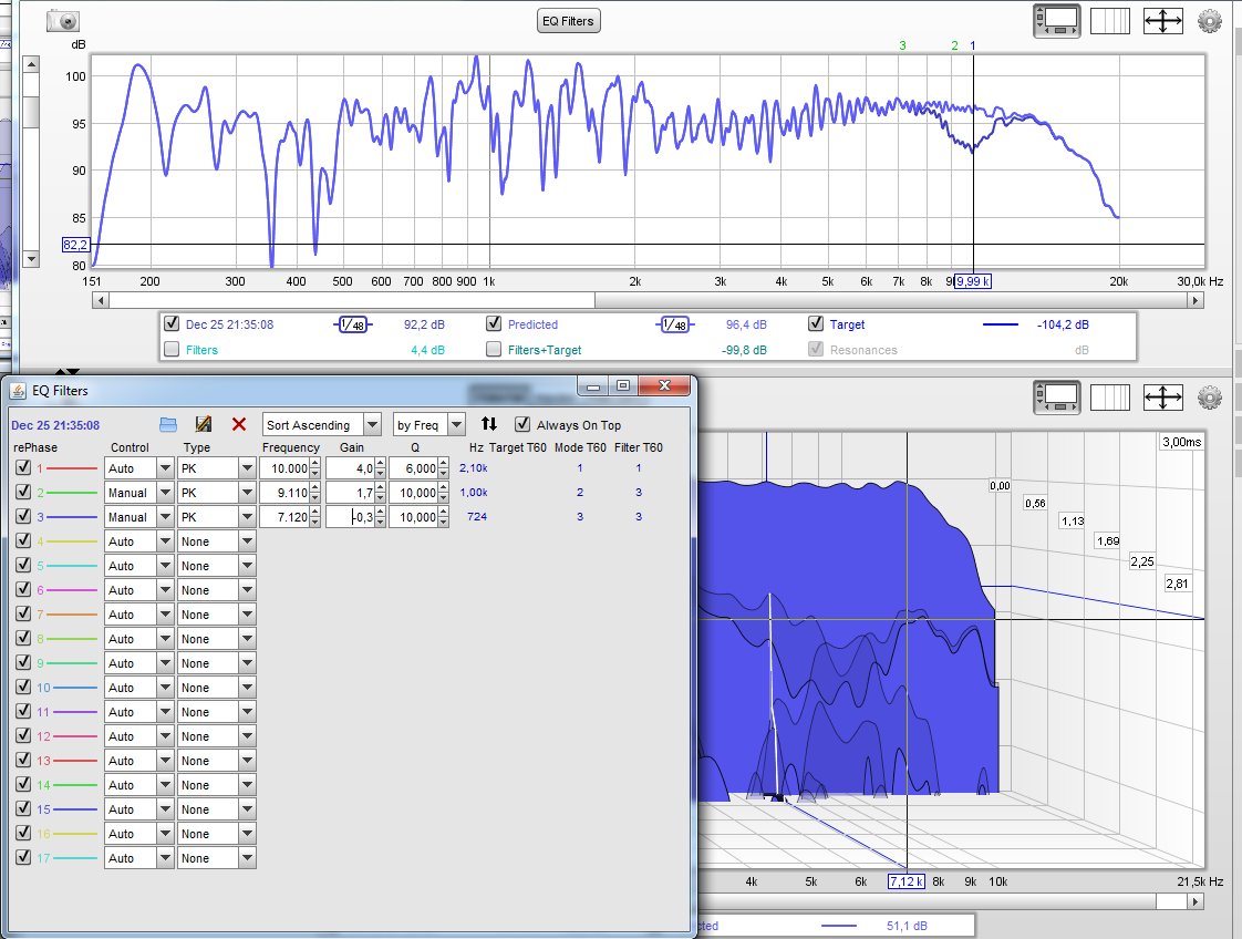

What I did to find out if the wiggles are related to the dip is the following:
I opened the EQ within REW, and set the bottom view to present the waterfall. As settings for this waterfall plot I chose similar settings as presented before in this thread, though the "Window (ms)" setting was set even shorter at 1 ms.
That gives us this look:
attachment.php

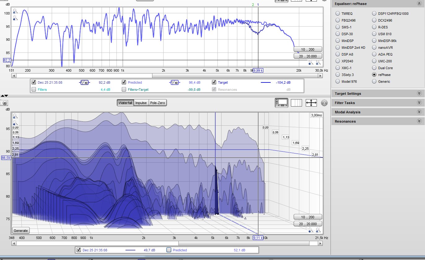

Yeah, the top graph already shows the EQ :), however to apply my EQ I actually use the waterfall plot as my guide. The objective: fill that complete dip to restore it into a decent response.
Here's what it looks like with the actual EQ numbers (I chose RePhase as Equalizer):
attachment.php

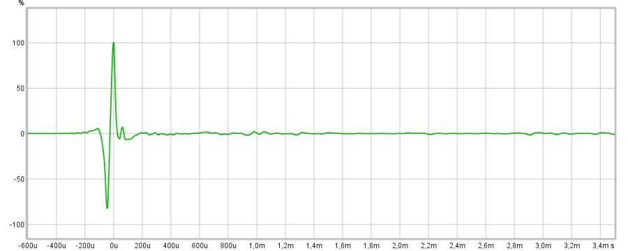

Going with the notion that speakers are largely following minimum phase behaviour this should fix phase as well, and clean up a decent amount of my IR.
Let's look at the IR tab, instead of the waterfall plot in that bottom window, lets see what result I got:
attachment.php
See how this cleans up the majority of bumps in the IR? If I work harder at it, I just might be able to clean it up entirely. :)
Now this isn't meant as an advertisement for using EQ to clean up the result. This is merely a demonstration that if we took action to get rid of the dip (flush mount the tweeter, maybe that short waveguide would/should benefit from a bigger round-over), the IR will look more clean as well.
Using EQ on something like this would only work if off axis measurements showed the exact same dip at the same place. Fix it acoustically would be my strong recommendation(!)

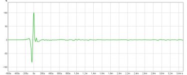

Some other priorities came along over here but a few more tweaks got me this:
attachment.php
The first peak has been reduced from 32% to 6.6 %, the second is completely gone. Relevant? Only to show all these graphs are linked no matter what. That's what you should take away from this short example.

P.S. One more thing to add, by mistake I actually EQ-ed the complete speaker (Woofer + Tweeter, that's the first blue IR)
The last graph is just exporting the EQ and importing it, to apply it to the actual tweeter IR. See how these 2 IR's differ?
That's the woofer's low frequency part added to the tweeter IR.
Nice work wesayso.
Doesn't surprise me at all the eq helped clean up the peaks past the main impulse.
Like you say, the graphs are all linked...completely I say, to no more than mag and phase ;)
If you can get rid of the downward peak prior to the main pulse, I'd love to see that...I haven't a clue there other than adjusting time/polarity.
