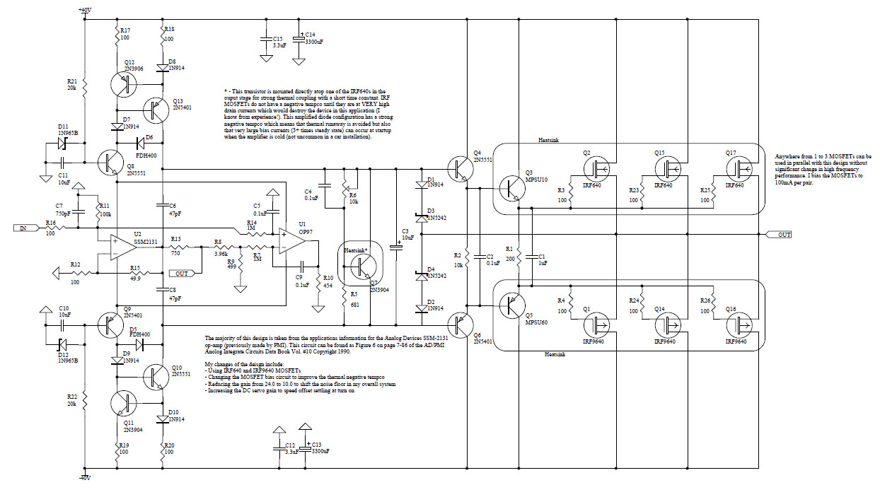

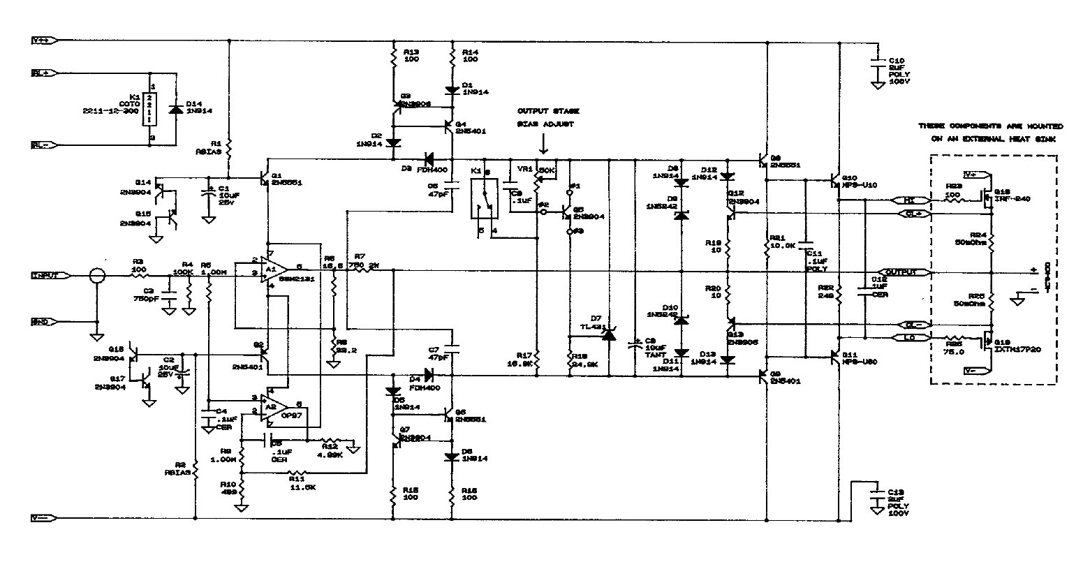

Excellent question indeed, and courageous. Try designing a 2 x 10 Watt amplifier operating in a sort of Class-A, having its quiescent current governed by the volume pot position.Why does this readership not exclusively use class A power amplifiers? This is one of those questions that is so basic that I’m almost too scared to ask.
Hooked on a pair of 87 dB SPL / 2.83 Vrms loudspeakers, it should dissipate less than 10 Watt when running for providing a moderate domestic listening level, say 80 dB SPL on your ears.
Mount a heatsink able to dissipate 60 Watt when the fan is on.
Design the heatsing in such a way that the fan can remain off when the amplifier is dissipating less than 10 Watt.
There are more and more diyAudio projects basing on prototyping boards featuring a microcontroller like the STM32F4 and STM32F7 Nucleo boards. Nowadays, it takes almost no money to rely on a simple remote control, and it takes almost no computing power to hook a 36 kHz infrared receiver for managing the listening volume. You can rely on a STM32 PWM output for generating a DC voltage that's proportional to the volume pot position.
You can rely on a LED+LDR combination (this is called a Vactrol) or an opto-coupler for emulating a variable resistor around the Vbe multiplier transistor that's governing the power amplifier bias current.
Some people will battle against this, saying that the variable quiescent current prevents optimizing the high frequency response (high frequency stability). Let them say. Don't argue.
In case you dislike building a power amplifier using discrete components, you may rely on a modern integrated circuit used as differential amp and voltage amp, followed by your preferred power transistors.
Search for "LM4702 Audio Amplifier Module" on eBay. You'll find plenty, some with bipolar output transistors, some with mosfet output transistors.
You may also hook your preferred audio opamp as differential cascode transconductance input stage, followed by a voltage amp using a pair of discrete transistors, followed by your preferred power transistors pair.

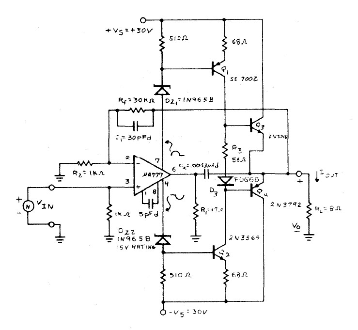

Such arrangement went public as soon as 1970 through the publication of the RCA µA777 application note.
Few people could understand the working principle because of the use of the opamp, as differential cascode transconductance input stage.
Still today, few people can understand the working principle, because the spice simulation of such arrangement requires a proper spice opamp model, what's regarding the opamp power supply pins.

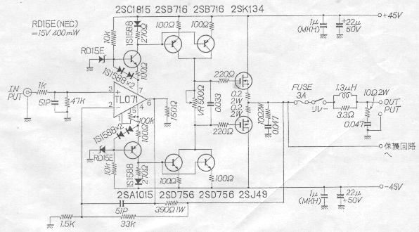

It reappeared as "Kuroda amplifier" in 1983.

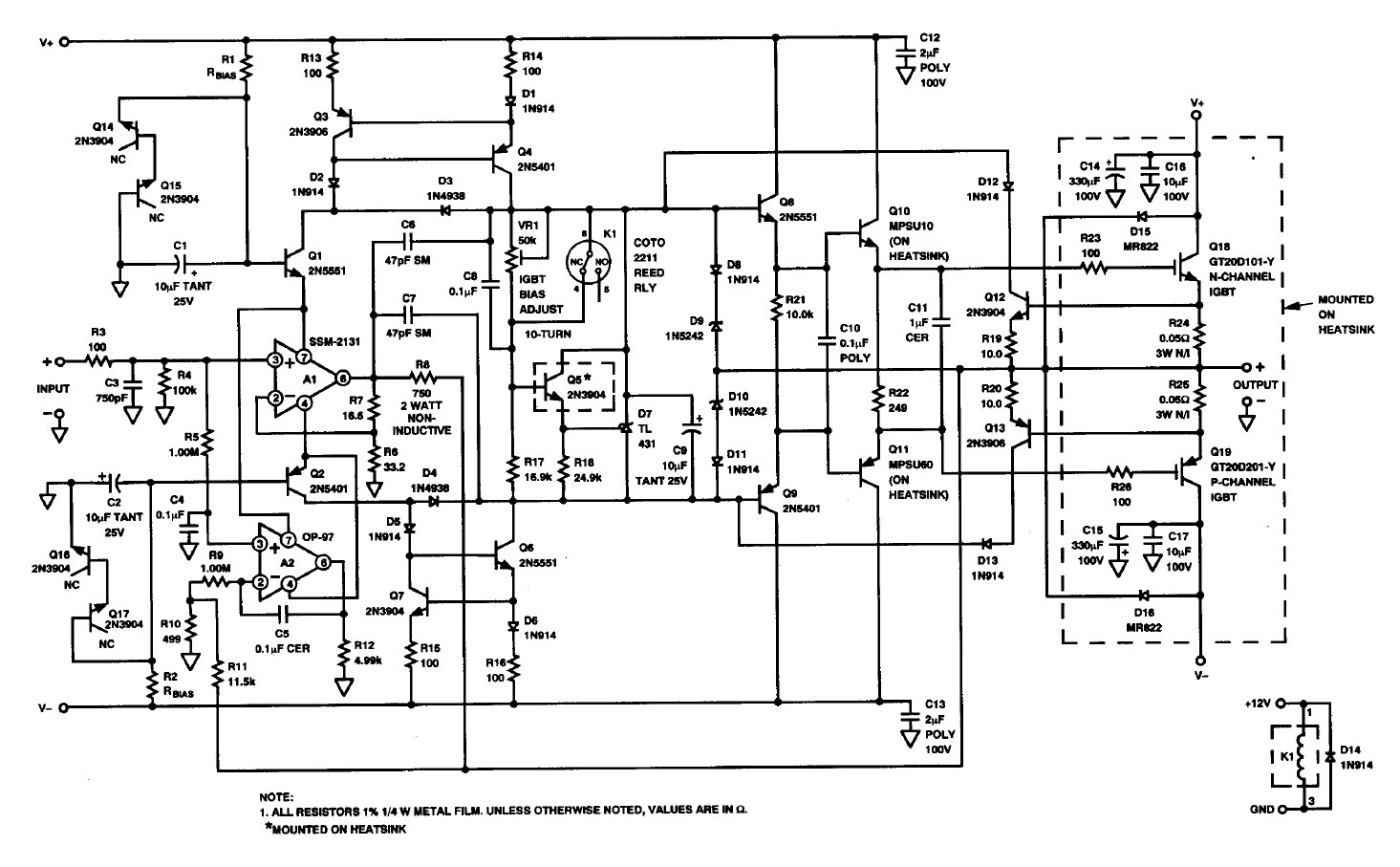

It reappeared as "Mark Alexander Current-Feedback Audio Power Amplifier" in 1990.

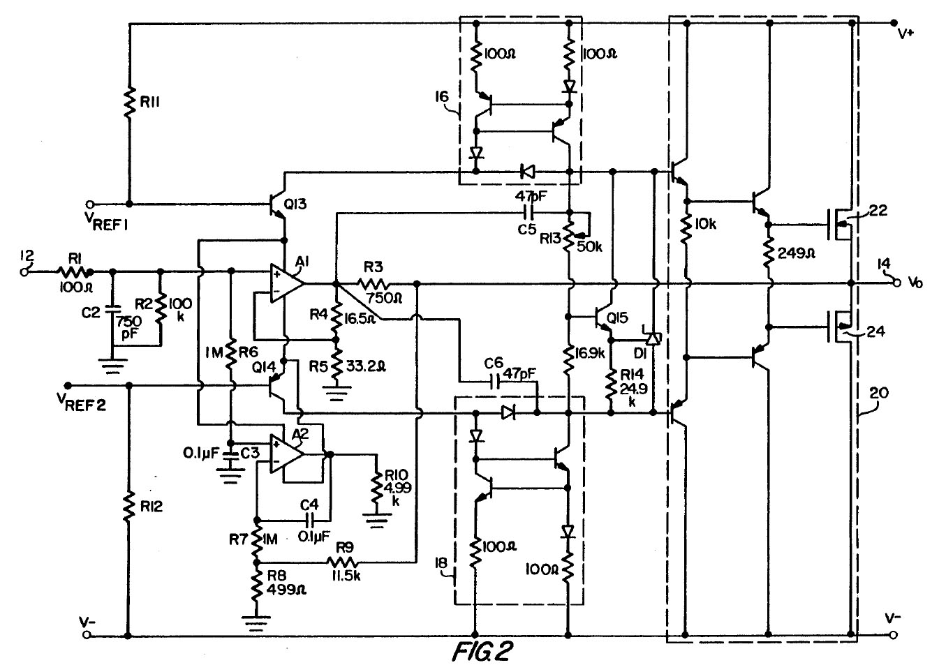

The US5097223 patent got issued to Mark Alexander in 1992.
It reappeared as "COLBY SSM-2131 Current Feedback Amp" in 1997.
See the attached .jpg files.

1970 - Fairchild Databook 1 - The complete Linear book - µA777 application note.jpg84.3 KB · Views: 597
1990 - AN-211 Analog Devices - The Alexander Current-Feedback Audio Power Amplifier.jpg231.8 KB · Views: 605
1990 - The Alexander Current-Feedback Power Amplifier - AES 88th Convention 1990.jpg201.4 KB · Views: 577
1992 - The Alexander Current-Feedback Power Amplifier - US5097223 patent.jpg197 KB · Views: 569
