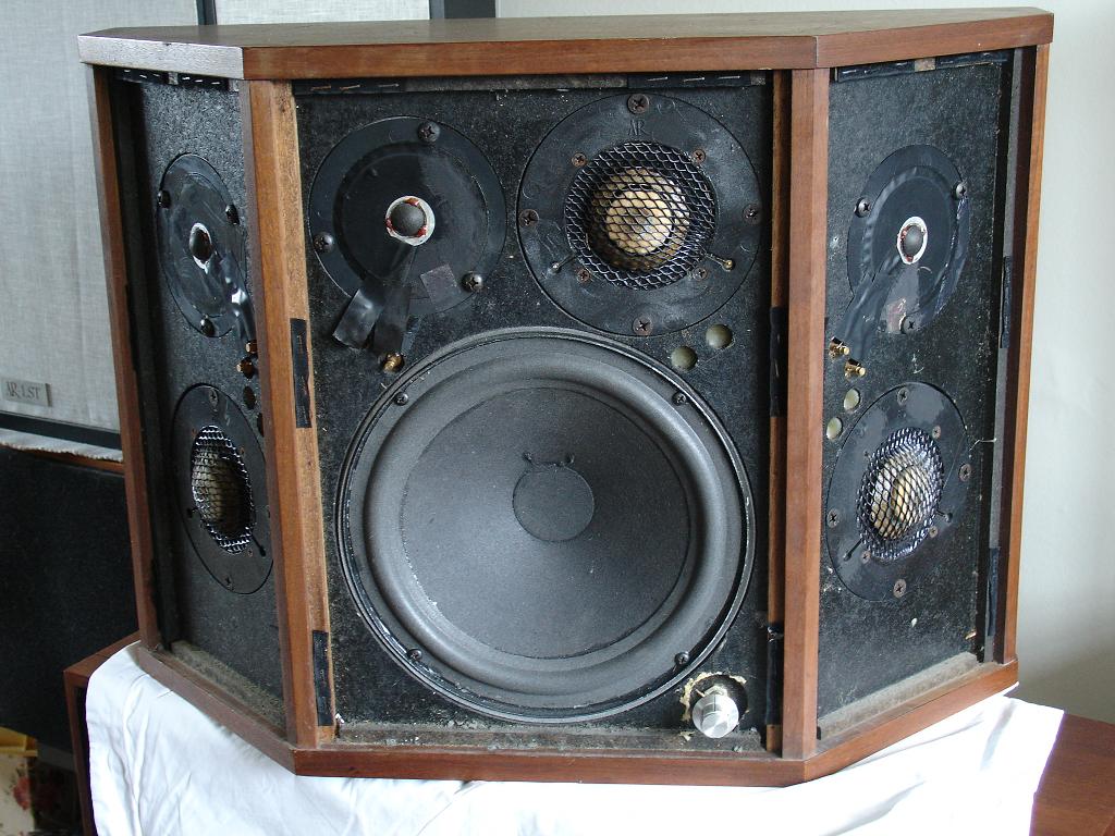

AR came out with a speaker many years ago (the LST2) that got rave reviews, apparently because it sounded real good anywhere in the room. Imaging may not have been the best there is, but as a tradeoff with horizontal dispersion, I think they designed it for most people rather than techno nerds like me who are obsessed with image localization clarity at the sweet spot. It has angled side panels that have additional mid and tweets aimed outward about 45 degrees to the sides. The center front has woof, mid and tweet (see pic below). (Thanks DB).
Looks like a good candidate for a beveridge placement
