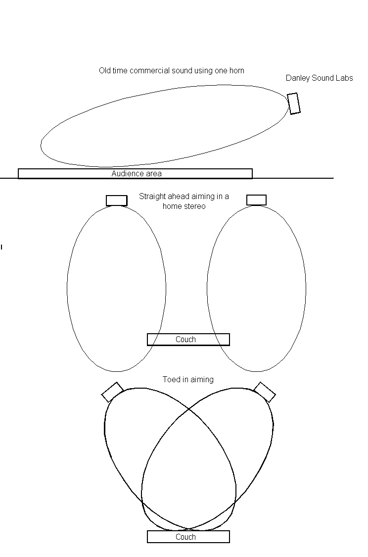

The purpose / reason for toed in aiming has it’s roots in old time commercial sound. Back when a single voice range horn would do, it was normal to have it aimed at the farthest seats and to use the bottom of the lobe shape to make the SPL more constant vs distance than the inverse square law would suggest.
Here I have drawn the lobe as a simple ellipse to approximate the equal loudness contour that is a real polar plot.
The idea is you aim the loudest part of the beam at the farthest seats and one can imagine how this would be relative to aiming it at the center of the audience.
In hifi, when you have a speaker with directivity, one also finds the center of the beam is normally the loudest and so a more constant loudness is achieved across the seating area (couch). The illustration shows the straight ahead aiming vs toed in. One can also see that far less energy would be hitting the side walls when they are close to the speakers.
In both cases, commercial and home, the more one has a consistent beam width vs frequency, the more effective this trick is. In commercial sound, the problem had been that one often wanted more bandwidth and more acoustic power than a single driver could produce. Multiple sources normally produce an interference pattern and radiate lobes and nulls depending on the frequency and so the trick isn’t as effective.
Our success in commercial sound is partly due to having a single lobe over a broad band and then this aiming trick works over a broad frequency range. It is how one can fill an entire stadium with one speaker with the closest seat only +4 dB louder than the farthest seat. See story #4 here;

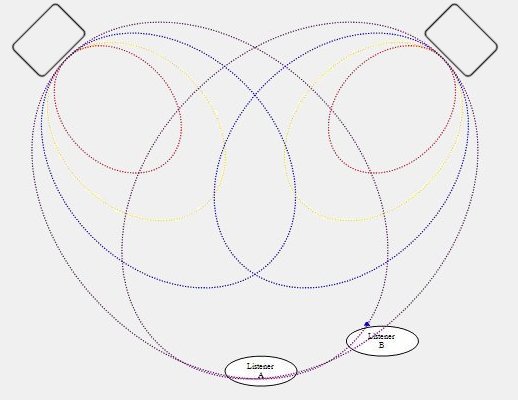

More information on the crossed-axes configuration can be found in the article below. It also has information about multisubs and flanking subs.
Any discussion about directivity indoors should include a mention about multisubs, since the LF pattern is set largely by room placement and damping. No matter what kind of speakers are used, the room and its layout set the pattern below the Schroeder frequency. Below that (around 200Hz in most homes), multiple subwoofers can be used to create a uniform sound field. Flanking subs (aka helper woofers) work best above 80Hz, and more distant subs work better below that.
Also see the illustration below, taken from the High-Fidelity Uniform-Directivity article referenced above. This helps further illustrate how the crossed-axes method works. Each oval shows areas where SPL is uniform from side to side, when a speaker having constant directivity is employed. Where those regions intersect, there is stereo balance, or equal volume between speakers. It makes a very large "sweet spot" where sound is balanced and imaging is good. You see listener A and listener B are separated by some distance, yet each enjoys good stereo balance and high-quality sound. No more "head in a vice", the sweet spot covers the half the living room.
Crossed-axes configuration
