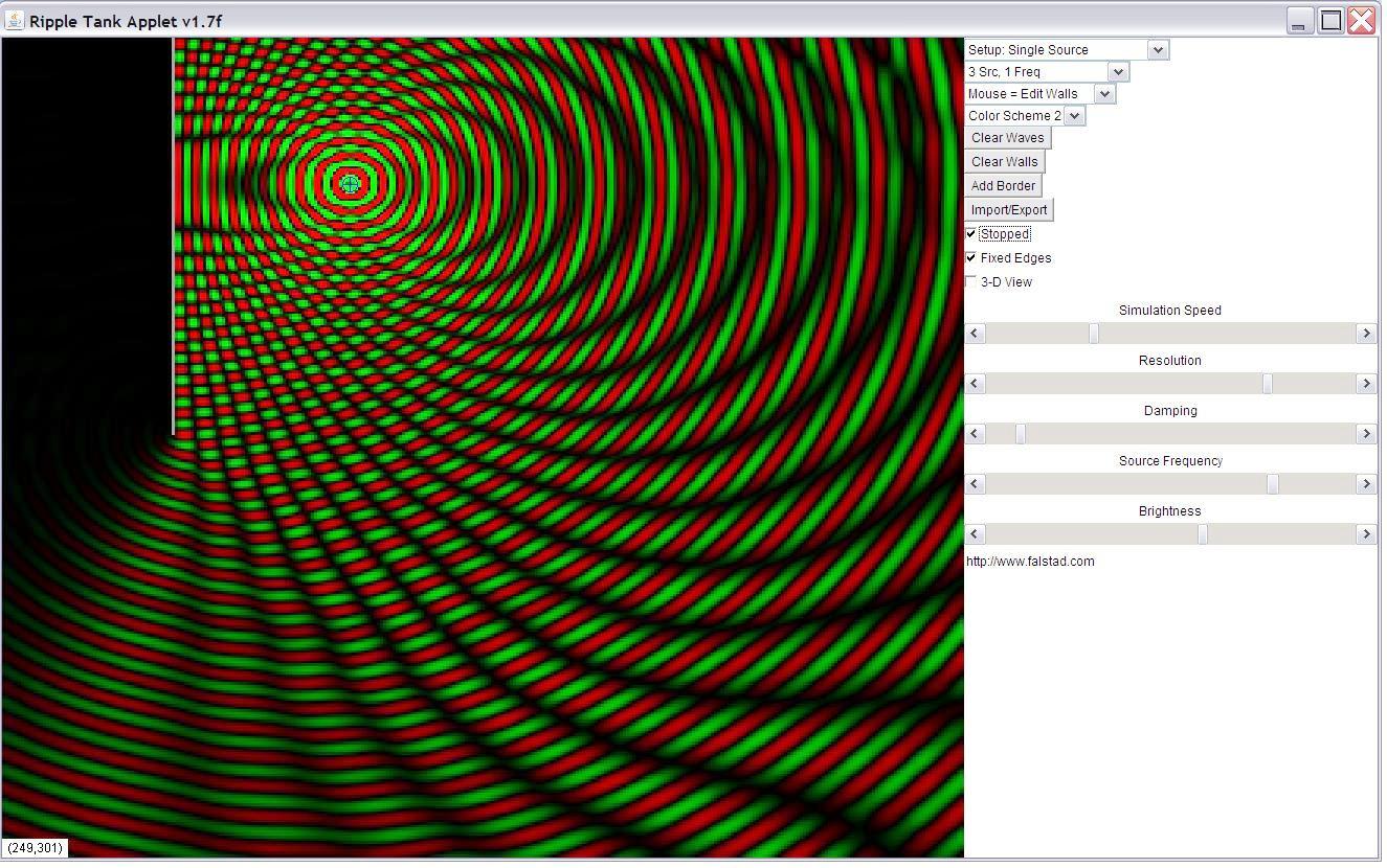

A "sweep" signal and the resulting interference pattern, due to a single adjacent wall.
The interference pattern actually moves with frequency.
Since the pictures are just snapshots in time, that effect is resembled by the curved
shape of the zones of destructive interference.
1. picture: Single point source
2. picture: 3 point sources ("lateral array")
A listener could be imagined e.g. in the lower left of the picture.

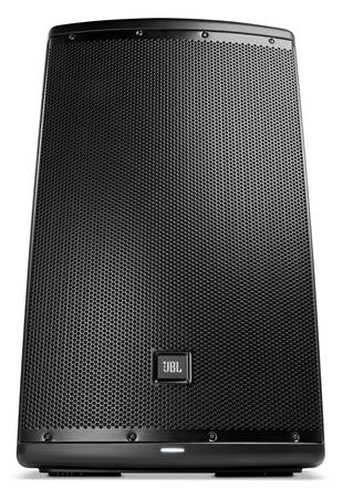

Another recent example is the JBL EON615
The 15" is probably used very high, like 2kHz, so they had to do "something" to widen directivity...
I know this kind of difraction device works well in widening the radiation pattern. I have done very similar myself long time ago. This is a good method if wide radiation is what you need.
The only problem with such kind of slot loaded woofers is, that it makes up a helmholtz resonator by enclosing a volume behind the slot.
It has to be used sufficiently below that resonance, at least if the driver is assumed to act (like) pistonic there.
On the other hand, with such a large bass driver possibly used in the Khz Region - i could not find the manufacturer's crossover frequency - cone breackup could even mitigate excitation of that helmholtz resonance.
Could be be a beneficial fusion of of two things regarded as being nasty otherwise ...
Nevertheless looks a bit like a "coarse" PA-Concept to me. Using 2 smaller woofers - potentially in 2.5 way
configuration - or going 3-way, would be the more expected way to go in a high quality system.

The issue was crossing a 15" woofer > 2Khz in the JBL EON Series, which may be due to saving cost in the tweeter's compression driver and horn.
The systems you mentioned AFAIK cross one full octave lower, which changes things a lot. Nevertheless i regard even those systems you mentioned as "overstretched". Neither the Tannoy systems - especially with larger Coax drivers - nor the JBL 4430 could ever fully convince me in terms of "transparency" or "low coloration".
