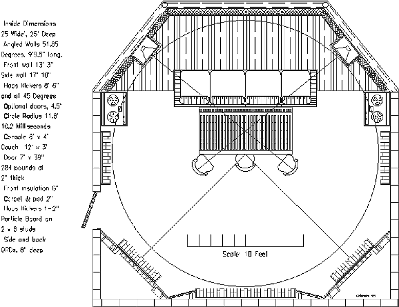

believe me or not - actually the "redirecting panels + diffusion in the rear" solution is the one I find the most reasonable and convenient in a domestic listening environment, I always recommend it
Yes. A more uniform speaker response will lead to less coloration from the room. The CBT is probably the first speaker I think sounds very well with reflected sidewalls. The image suffers obviously.
..I don't think those who have experienced this find stereo to sound unatural or lacking much in a spacious soundfield.
This is simply far better IMO then only reflected sidewalls because one completely avoids the negative effects such has.
But does the image suffer as a result of those reflections?
The critical part here is that most assume this to be the case, and yet the research on this not only does NOT support this, but rather disproves this notion - at least with respect to a "reasonable" distance from those walls.
Instead go with the experts conclusions: just look at the direct sound's behavior (in its entirety).
I've listened to setups like the control room (including control rooms). The best have been private home theaters - but even they have uniformly had limited sound-field expansion beyond the walls of the room. I tend to "hear" the room or it's lack of reflections with substantial absorption and it creates cues that make it impossible for me to "suspend disbelief". Also, the images are often "pin-point" regardless of position - essentially having "size" problems.
