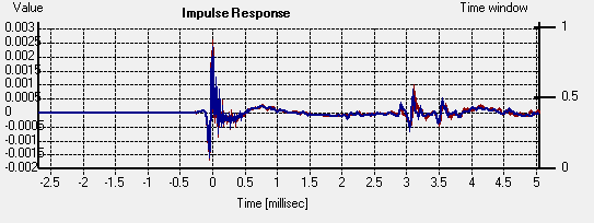

I have a wide dispersion system and I get satisfactory results with a time gap of just 3ms. I don't claim my setup is optimal and there's certainly limits of how loud I can play until room reverberation gets in the way. All in all I get a very good sound and imaging.
My point is that there might be something else going on and the ETC (energy time curve) might not be the single defining factor. Furthermore, ETC is given in 2 dimensions and I think we dealing with 3 variables - time, intensity and frequency. Also I speculate that the ETC will be relative and not imperative as Dave suggests in the previous post. For example if the room is bigger it can be more reflective, if it's more absorbent it can be smaller.
I would never claim that you can't get satisfactory results, any more than I would tell someone that dipoles can't work, or omnis are never any good. The question is whether you might get some improvement with a more optimal dispersion speaker or whether pushing your reflection at 3ms down in level or further back in time wouldn't make a noticable improvement.

The 10ms time gap between the direct signal and the first reflection was already mentioned earlier in this thread. Linkwitz suggests >6ms. In reality that translates to a big listening room with a pair of speakers in the middle of it. I think many will agree that this is a hard to accomplish luxury.
10ms to first reflection is a complete fantasy for anyone living in Europe, even 6ms is impractical. :(
As you say, 3ms can give a satisfactory result, if overall reflectivity and reverberation are kept down to a manageable level. With such short time delays it would seem that direct to reflected ratio becomes a lot more critical factor, thus room damping, speaker positioning and toe in all become more critical and influential.
