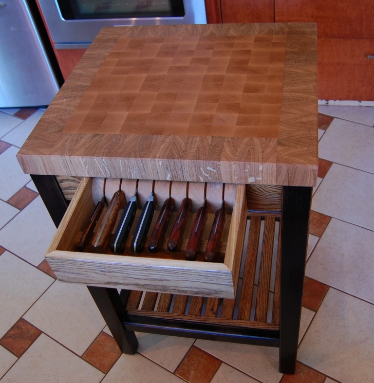

Not trying to be too picky here but to make sure you guys are identifying the same things: Butcher blocks (good ones) are end grain. End grain is used as it feels good, sounds good and doesn't dull your knife as quickly.
Laminated cutting boards (good ones) are edge grain and cheap ones are off-edge or flat grain.
This is assuming we are talking standard hardwoods like Maple and not bamboo.

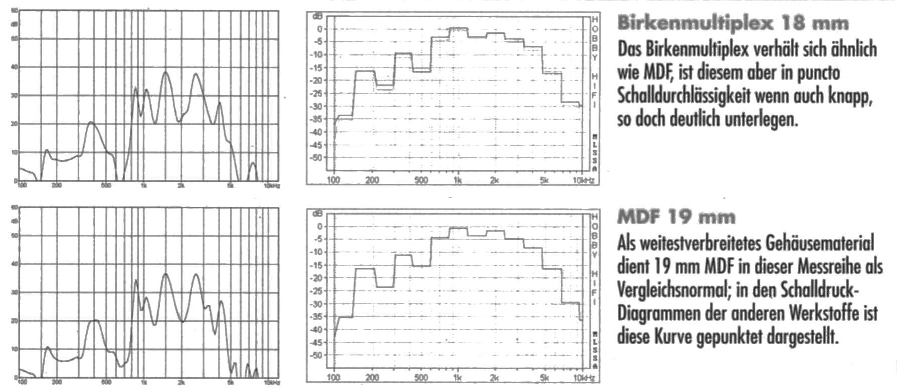

Is the resonaance actually that audiable even for full range (multi way, I meant to put this there!). Is there a great amount of difference?
Simply, no. The material used for constructing the enclosure is one of many factors. The way you are using it, the construction of the box itself, bracing, damping of the walls is very important. Properly build box from solid wood can definitely be better than average MDF construction. In my humble opinion if you design and build the box very well, the differences will be under your recognition.
For a cutting board
Oh man, I shoulda known.
Is the resonaance actually that audiable even for full range...
Yes. The surfaces are large compared to the drivers.
'It is a well established fact that MDF and particle board loudspeaker boxes resonate in conjunction with the woofer and radiate nearly as much sound pressure as the driver itself at certain frequencies.' - Vance Dickason, Loudspeaker Design Cookbook, 4th. Ed, P79.
Bracing and wall damping are probably more important than the absolute choice of material, but the choice of material has a significant effect and should be taken into account when planning a design. The general approach is to both damp the vibration and shift the resonant frequencies higher where they are more amenable to damping with specialist materials such as are used in cars.
w
Note that the kind of damping here, reduces the resonant frequency, The prime reason for raising resonances is that the higher they are the less likely they are to be excited.
With energy to excite at least decreasing by the square of the frequency, and with some assumptions arguably decreasing by the 4th power of frequency, raising panel resonant frequency is a pretty powerful tool.
