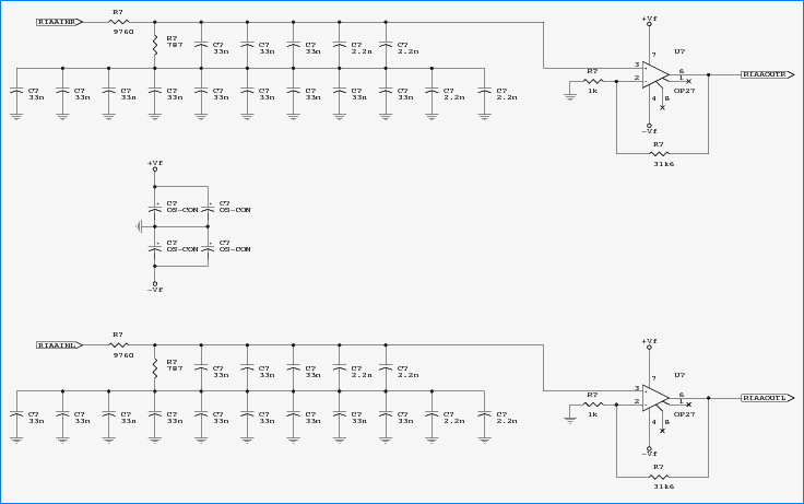

analog_sa said:
This is only the linear input stage.
It's followed by a passive network and an opamp.
Okay.
Here is part 2.
With RIAA filter and an OP27 amplifier. See attachment!
( I would have used an OP37 as the gain is way above unity in this stage )
Today there are modern variants to replace OP27(unity gain stable) and OP37.
Still OP37 is no way a bad audio op amplifier ......
Improved modern Replacements are
OPA227, unity gain stable, and OPA228 stable at gain >=5
# LOW NOISE: 3nV/(Hz)
# WIDE BANDWIDTH:
* OPA227: 8MHz, 2.3V/µs
* OPA228: 33MHz, 10V/µs
# SETTLING TIME: 5µs (significant improvement over OP-27)
# HIGH CMRR: 138dB
# HIGH OPEN-LOOP GAIN: 160dB
# LOW INPUT BIAS CURRENT: 10nA max
# LOW OFFSET VOLTAGE: 75µV max
# WIDE SUPPLY RANGE: ±2.5V to ±18V
# OPA227 REPLACES OP-27, LT1007, MAX427
# OPA228 REPLACES OP-37, LT1037, MAX437
# SINGLE, DUAL, AND QUAD VERSIONS

lineup said:
Okay.
Here is part 2.

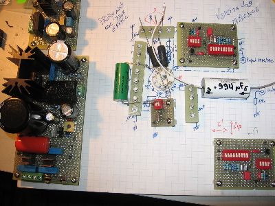

Working for the last 3 month on the FVP5A from Allen Wright ; A hybrid MM/MC
http://www.vacuumstate.com/schematics/fvp5a_s.gif
At this time following John Broskie I have built 2 of his his new HV PS
with great success. HV 250 Volts with IC LT356
http://www.tubecad.com/2006/11/blog0087.htm
Custom made toroid 120 VA from Sumr with 2 secondaries 250volts at 100 mA
2 heater circuit for 6.3 DC at .6 A
1 circuit 12 Volts for mute at the output and delay HV PS's at 30 seconds
The input 2SK170 BL have been paired at 2 and 6 mA for about 0.002mA delta
Have added a dip switch for input impedance MC matching with:
25 / 56 / 100 / 200 / 400 / 800 Ohms resistors
matched at le lower range of my 37Xr Meterman
added 30 / 60 / 100 fP caps
Got 2 set's of nice EH 6922 paired tubes
And already designed the position of components...
Last week got 2 nice SRC 0.22 uF FEP/SN teflon caps at Solen
and have all the rest...
Time to build a nice wood chassis...
Regards.
Alain.
