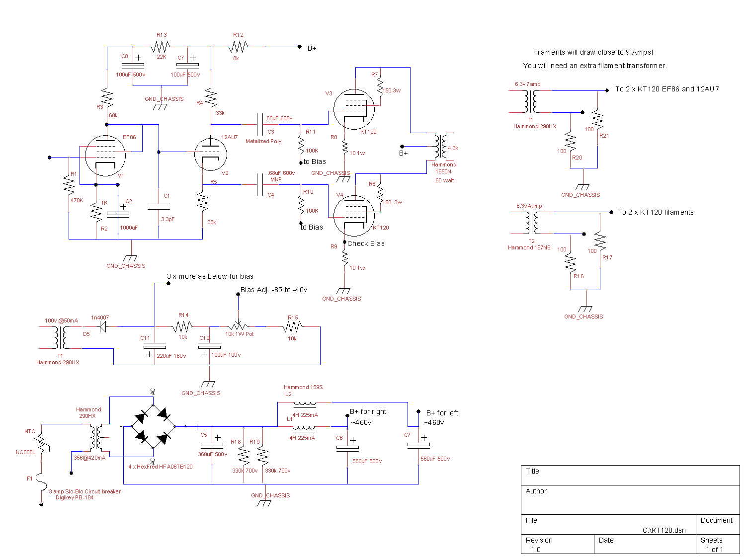

The best circuit for an amplifier that you could use a 6L6 in is on page 696 of the RCA Receiving Tube Manual RC30.. although the circuit uses a 7027A (these are hard to find) a 6L6 would do the job just as well. see below circuit....I will send you the parts list if you want. Note I built this amp about 15 years ago and it is really a great performer.
That is a 'Williamson' type topology; with a lot of NFB. Interestingly the OPT is not very good quality; the local NFB is needed to maintain stability. You could run that circuit with an EDCOR or organ amp OPT. LOVE that late tube era all pentode design though. The regulated G2 supply provides great performance also.

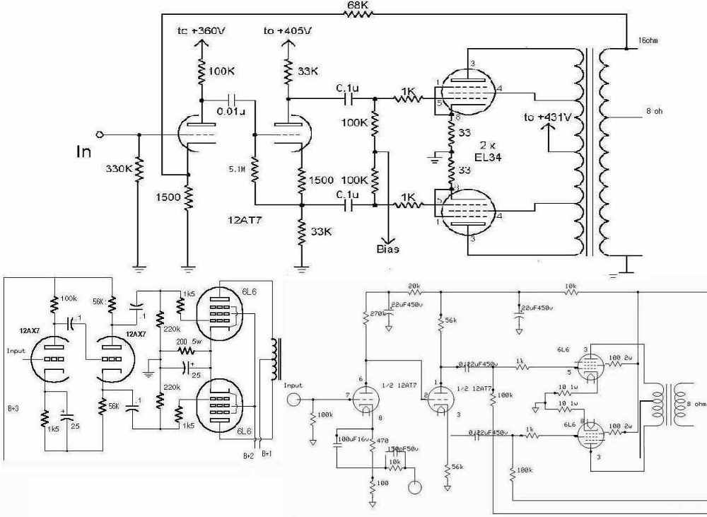

Simple and tested circuit. OPT is 6k6. Output power with 450 V supply voltage is some 30...35 W.
GNFB is set with R5 and frequency response with C3.
If the transformer has low leakage inductance, then C3, C8 and R21 are not necessary at all.
This circuit looks very familiar. Can you explain where you got your inspiration?
That is a simple cathodyne circuit. It is not direct coupled so now one is dealing with an inherently unstable situation. That is why traditionally the practice was to use direct coupling from the voltage amp stage to the phase splitter. A pentode front end is able to swing lower and it has higher gain so that is why they did it that way. Cathodynes also have the advantage of not requring matched tubes. The only other front end that share this trait of not requiring matched sections is one of my faves...thefloating paraphase. That 6si7 would easily drive the 6l6 ouyputs in a floating paraphase because both tubes are ground referenced and see the full b+

I have built a lot of 5881/6L6 pp-amplifiers with different different topologies.
Now I wanted to make simple and all octal-base version with good performance. The gain of 6SL7 is sufficient for typical line-level sources giving up to 1 Vrms signal and some 10...12 dB GNFB.
I made a pcb. for this amplifier and it can be directly used with 6V6, 5881, 6L6 and EL34. The output transformer and supply voltage must be of course
selected according to the used tube.
The direct connected cathodyne is usually a compromise in terms of high output level and low THD. If the direc connection between voltage amplifier and phase splitter is used, then one or both stages operate in not optimum condition. When the THD of 1st stage is optimized then the anode voltage of this stage is a bit too high for optimum condition of the phase splitter.
Therefore I use ac-coupled cathodyne only.
If the required voltage level is 20 Vrms or lower then direct connected cathodyne is fully OK.

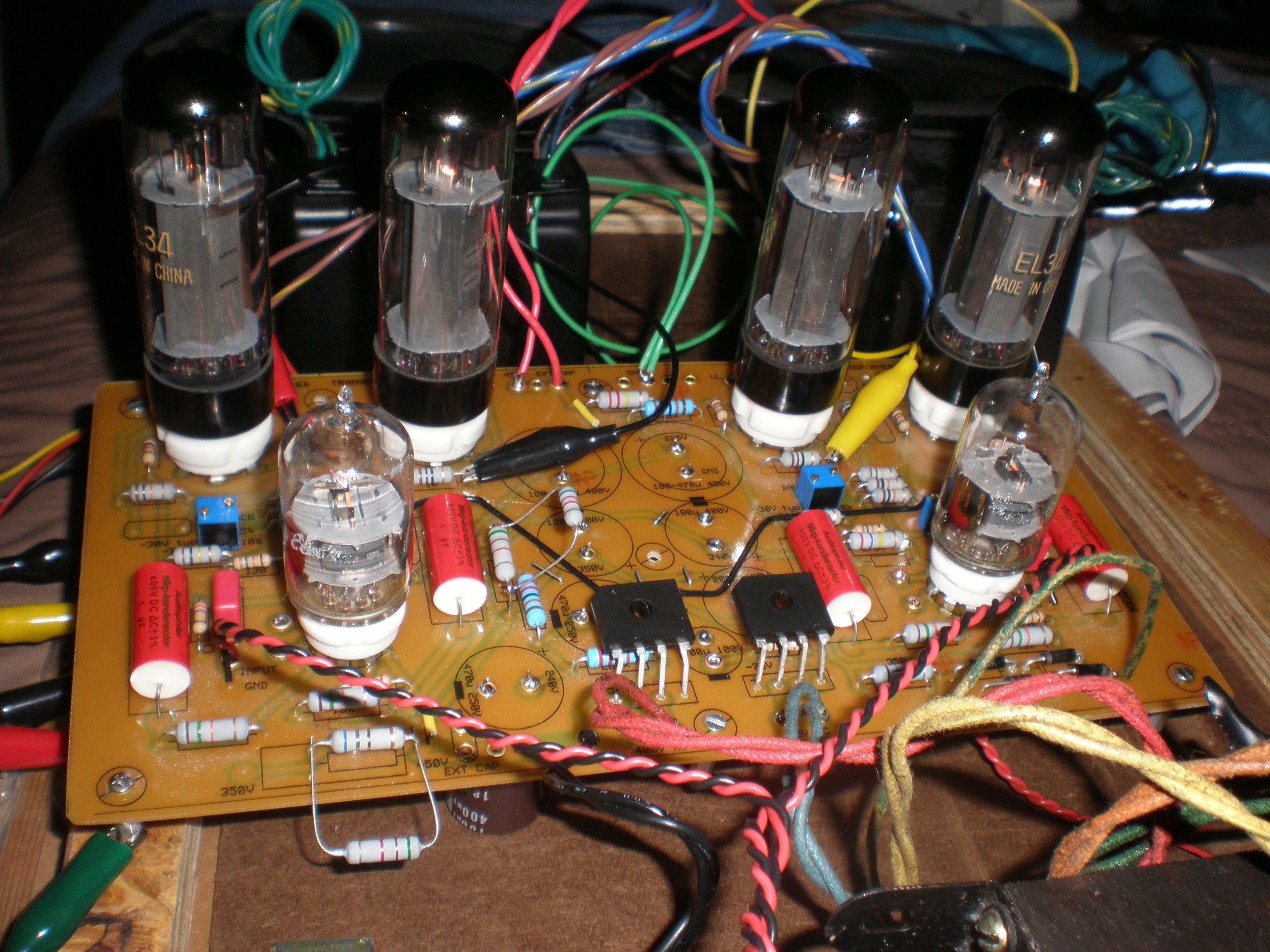

Below the amplifier pcb. with 6P6S (6V6) tubes.

After thinking about this some more there is another way to get very good performance with a relatively "simple" build. I have been tinkering with a pair of Pete Millett's new driver board, using a wide variety of output tubes.
He built a PPP amp using 4 Loctal 807's per channel which are a 6L6GB variant. They are triode wired and run very conservatively for 40 WPC. The circuit looks rather complicated, but the build is rather easy because of the driver PC board.
