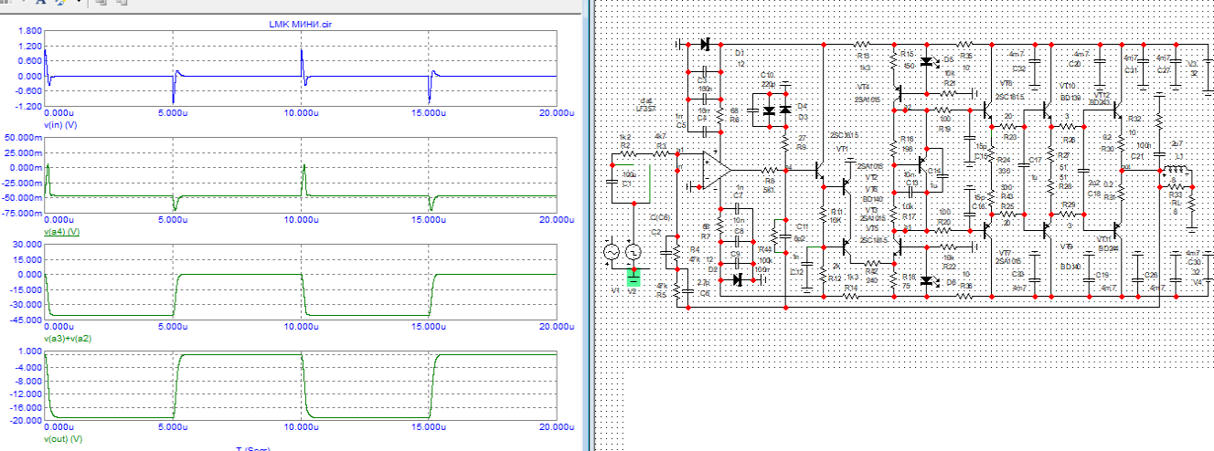

Hi Hans,
I am not sure how simulate settling time, attached LTspice file of one of my built by quite a number of DIYers here.
BR Damir

This is what I got on the amp I attached .asc file some post before.

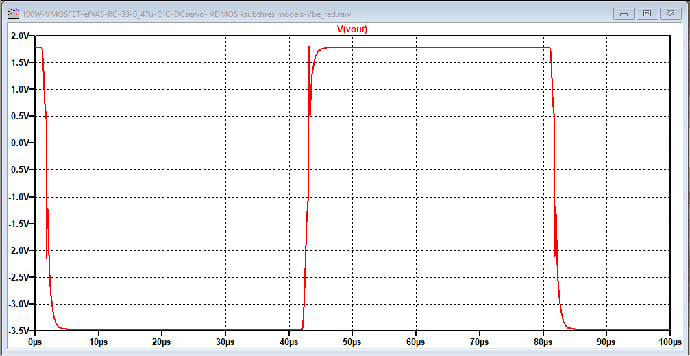

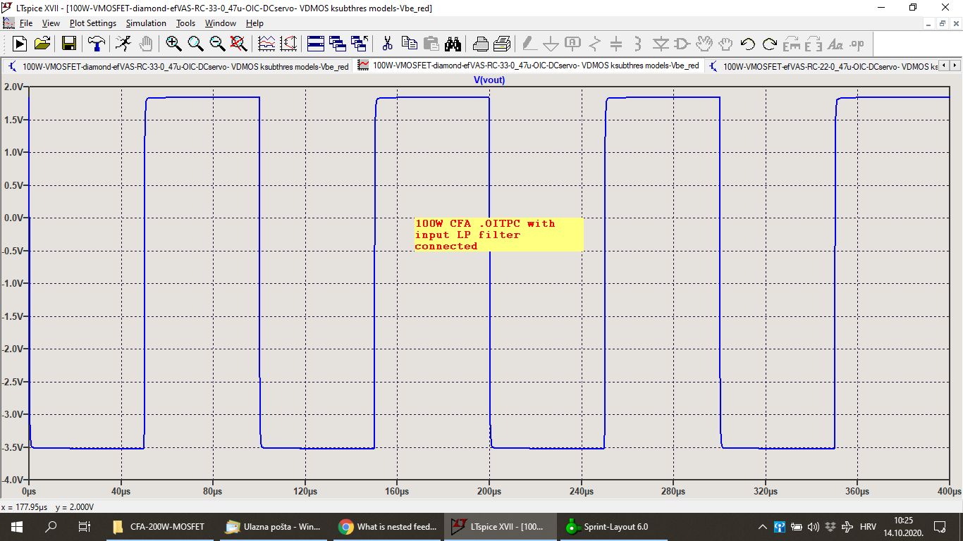

I use input LP filter with 220R/680pF and no overshoot, see second plot.

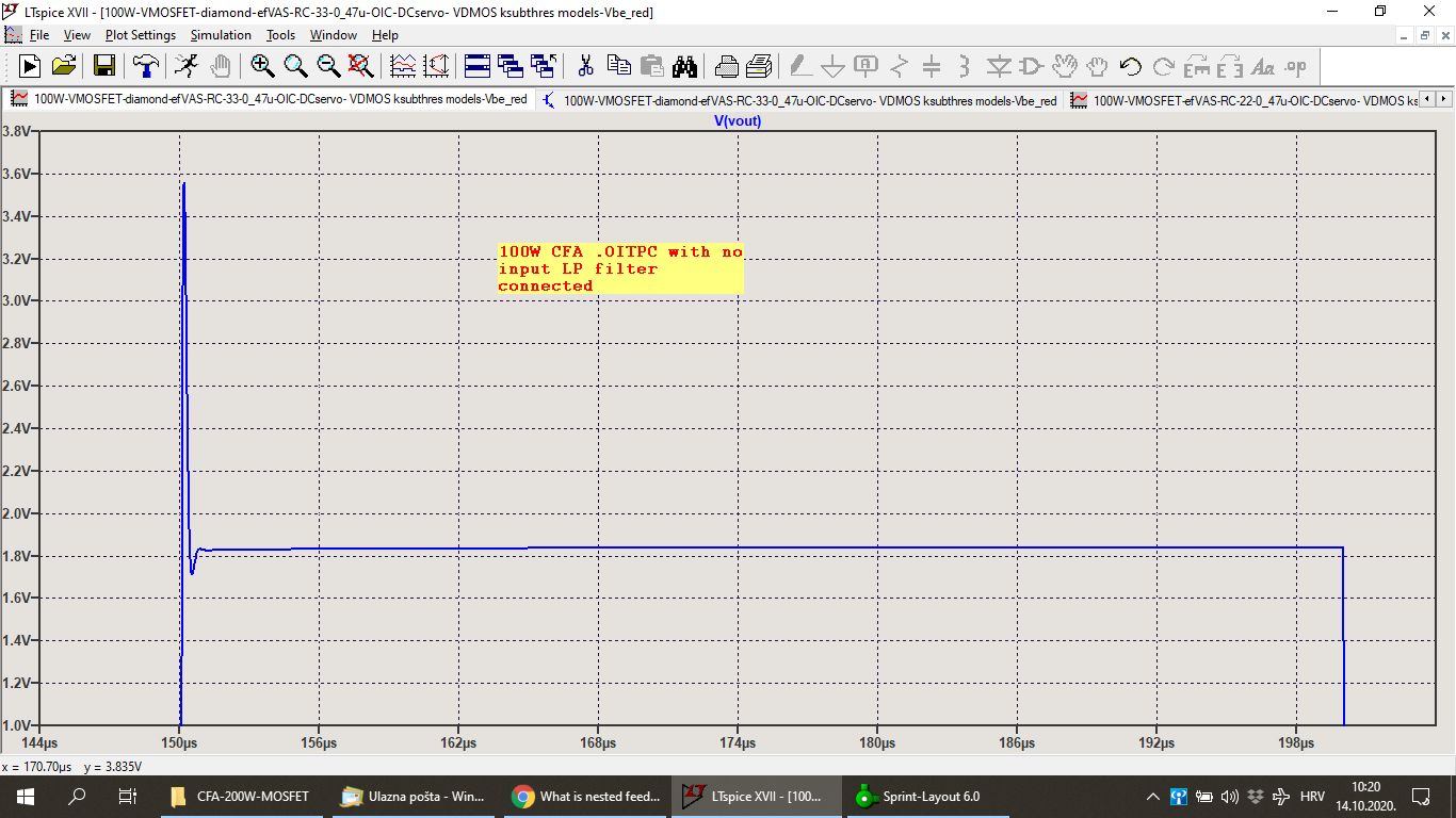

First one is with no input filter cap connected and 10nS rise-time square wave.

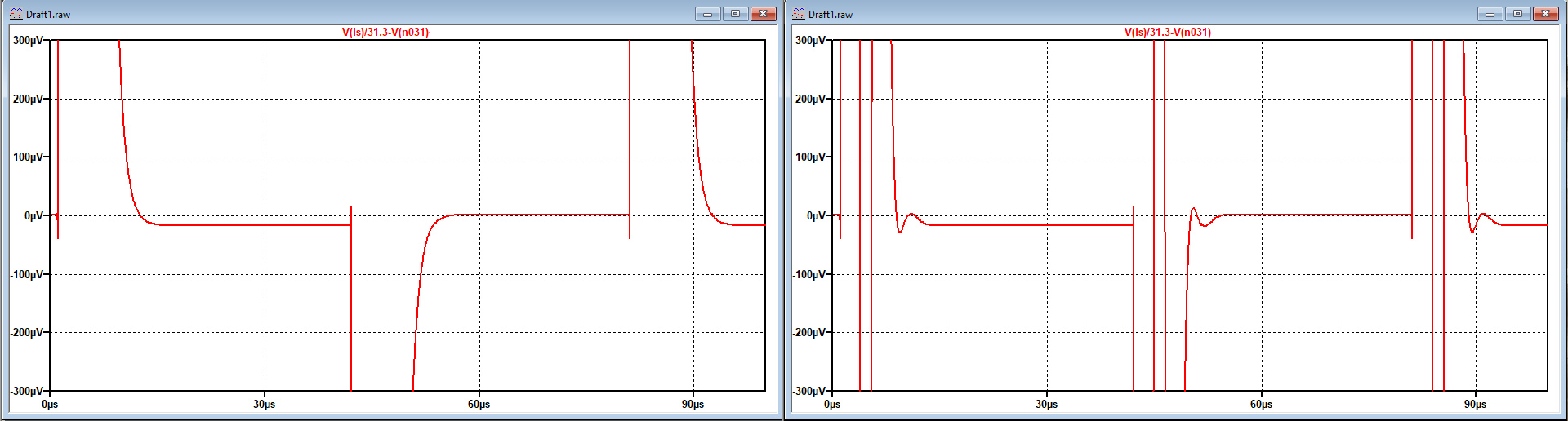

Divide the output V(ls) by the gain and compensate for the time delay.
Then V(error)= V(ls)/gain -(V(in)-delay)
In LTspice I watch the signal at what point V(error) has settled to within 0.1%.
See here as an example of the amp that profdc9 presented.
Simulating single pole vs. Transistional Miller Compensation (TMC)
Single pole against TPC, where there was in this case no sign of a longer settling time, but only of a more violent coming to within 0.3mV or 0.1%.
So let's see what Damir's amp is doing.

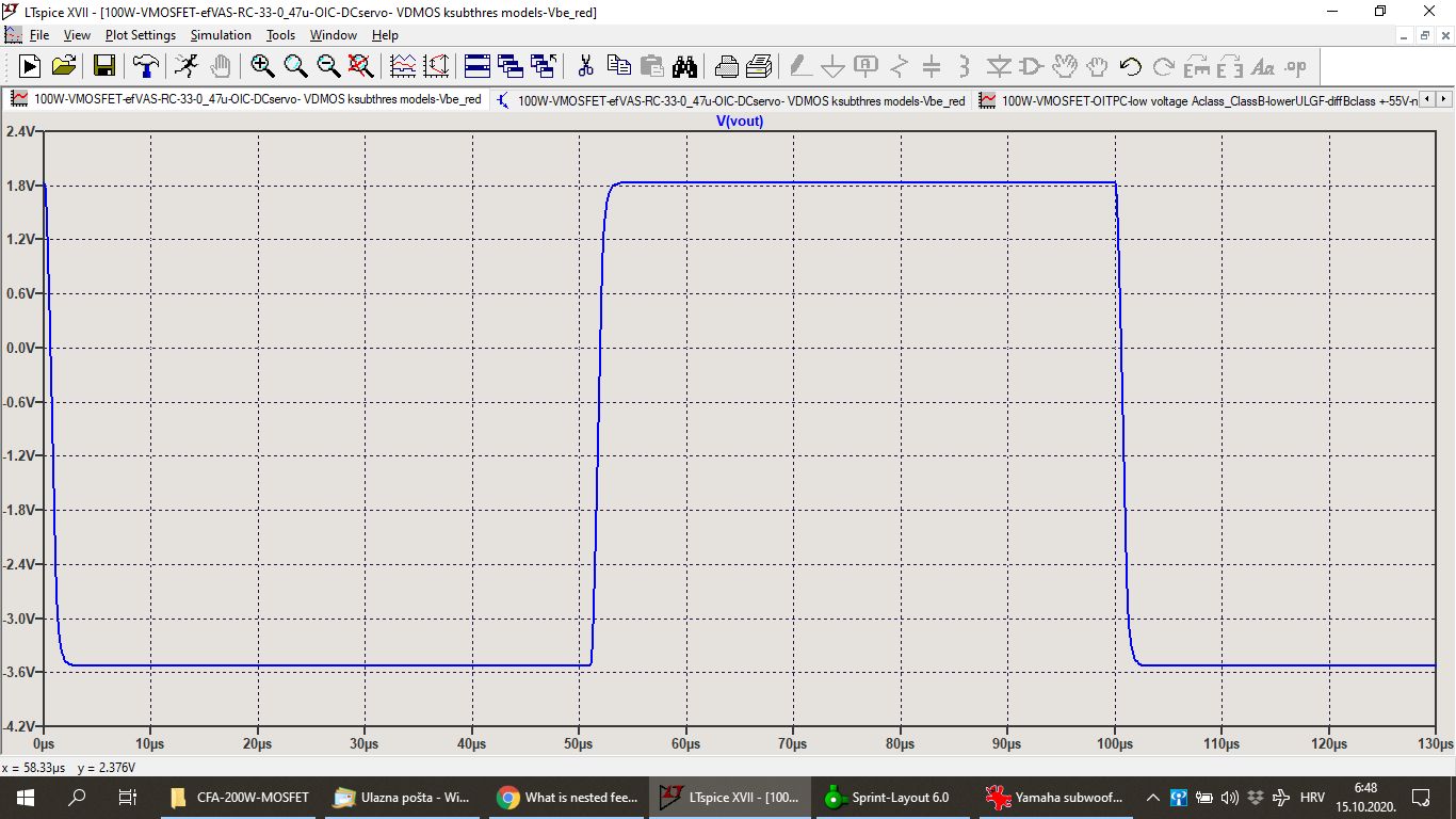

Damir,
Thank you for the text files.
When offering a +/-0.1V square wave signal with 1usec flanks at the input, I get a weird output signal with the model as supplied by you.

Hi Hans,
I don't have that. Attached .asc file again, just run it and I suppose you will get the plot as attached too.
