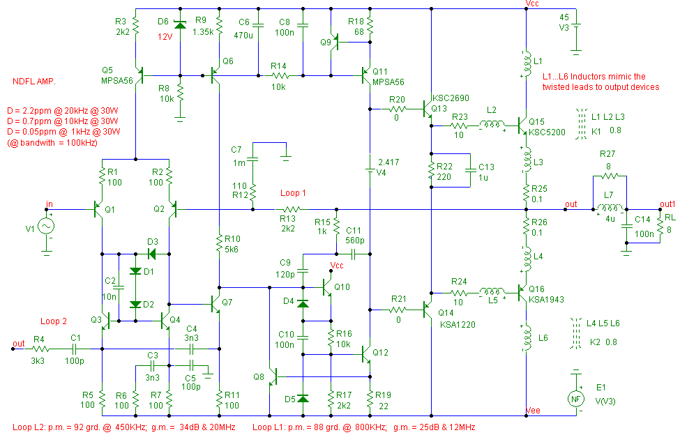

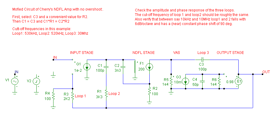

Edward Cherry's NDFL
See attachment for an other example of Cherry’s NDFL. I have changed some component in order to approve the step response and also changed the global feedback loop to a more common topology. Furthermore, I included some simple rules to calculate the specific NDFL components. Please feel free to contact me for a complete circuit diagram.

Hi bogdan_borko,
Here is another example of a NDFL amp. Notice that I have also applied the transitional Miller compensation (TMC) to avoid possible instability that might occur when C9 is directly tied to the output. The NDFL components consist of R4, C1, C4, R11 and Q7. R6, C3 and C5 restore the balance of the current mirror.
Also note that the Rush PNP/NPN pair (as in Cherry's implementation) has been replaced by a single transistor (Q7). As there is already a current mirror, we can use just this one to create the 2nd stage lag compensation (C4). For more info, please contact me and see my previous post, but don’t ask for a formal analysis, as the critical component values I just figured out by fiddling with a simulator.

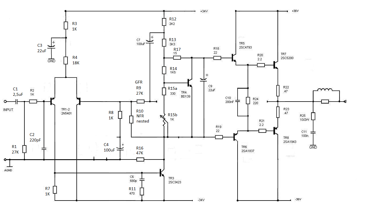

Hi all.
My question is how the value of the resistor (R10) is calculated, neested feedback resistor. Global feedback is 28. (R9/R8 +1= 28).
For the feedback level calculations you can asume that R10 is connected to the output, it has (almost) the same level. So the total feedback factor can be calculated by taking the // value of R10 and the 'normal' feedback R.
If you want to split the feedback equal between the two loops you just make the two fed back resistors equal.
Jan
As a close approximation, and assuming we are using resistive fb both for global and nested, the ratio of nested fb resistor to the global feedback gives you the ratio of the global feedback. So, for example from a quasi we are examining at present, 68k/1k8 = 37.7 which 31.5dB. The closed loop gain is the paralleled 68k and 1k8, 1k754 factored with the 68R feedback shunt resistor, which is 26.8 which is 28.56dB.
HD
HD
