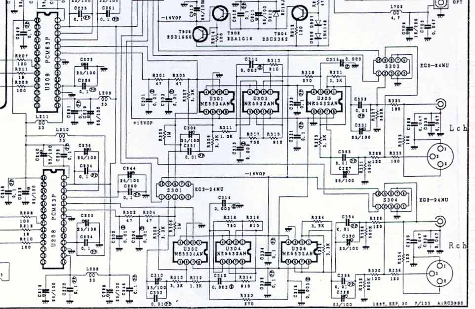

I still try to get it out of this burned DAC board, out of a Classé DAC-1.
I will use the dremel, as I cannot unsolder it (litz wire and pump dont work) up to now...
Hopefully, it is still working! And I will use secondary fuses for every voltage supply!!!
Franz
I will measure the "1M" resistor
Looking a second time at the circuit: 1M will be O.K., as this is a parallel circuit to R307 (3.3K) and lowering the value just a little bit to achieve the wished higher gain for CD reproduction.
But one question still remains: what is the purpose of the caps C301/C331 in the feedback path using CD-mode?

What I/V conversion on BB PCM63K gives more natural , and transparent sound .
Active (AD847) , or passive with high quality , precision resistor (100ohm) connected from current output of DAC to ground?
I am currently using a 10 ohms precision resistor on the current output of my PCM63K. The signal is fed into an instrumentation amplifier followed by an open loop buffer. The sound is quite good.
