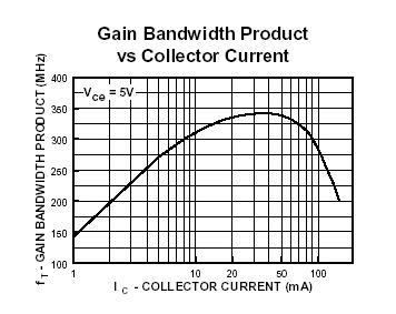

Transit frequency as a function of collector current:
Stay to the left of the peak.

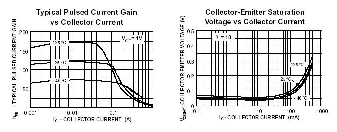

DC current gain as a function of collector current:
Stay to the left of the point where the hFE is 3dB below maximum.
Apply (if provided) the graph best matching your expected junction temperature and Vce
Collecter emitter saturaton voltage as a function of collector current:
Stay below the Ic, where VCEsat is about 200..300% the minimal VCEsat

Transit frequency as a function of collector current:Stay to the left of the peak.
The only frequency related graph from a transistor datasheet I can found is about bandwith. Is this the one? If this is the one, then when I use MPSA06, it should stay below 40mA

DC current gain as a function of collector current:Stay to the left of the point where the hFE is 3dB below maximum.
In the HFE-Ic graph, the curve is quite flat. If we look for 3db below maximum it will be very small figure. How to solve this?
Also I cannot find any junction temperature graph.
Collecter emitter saturaton voltage as a function of collector current:Stay below the Ic, where VCEsat is about 200..300% the minimal VCEsat
(If there is no minimum, i.e. VCEsat drops ever more for lower Ic, a compareable point is 50% of the Ic where there is a "kink" in the double log plot).
The minimal Vcesat is about 0.07V, so the 300% is 0.21V. It will be 300mA? Off course I will use below this, from the first restriction it is only alowed for below 40mA.
