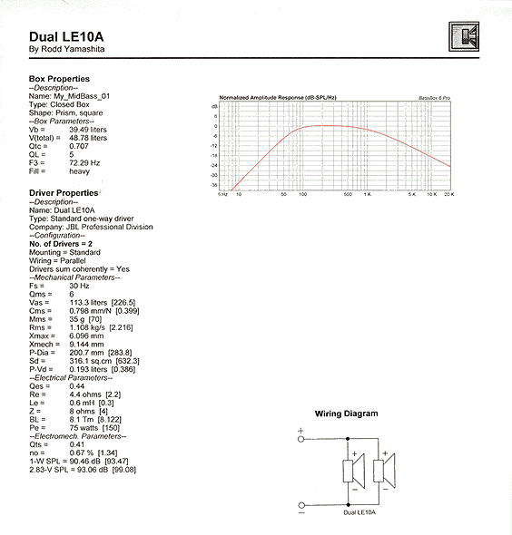

See my LE10A parameters below with the theoretical response. These drivers are available on eBay on a regular basis for about $100 a pair for working units. They will usually have their surrounds replaced and are cheaper if you are willing to replace them yourself. They are designed to be used in a ~2cu.ft. ported enclosure down to about 40Hz, but individually work well in a closed box of ~1cu.ft. for an f3 in the 70Hz to 80Hz range. These driver like to be directly coupled to the output of the amp and perform the best that way.gonefishin said:Rodd...you got me thinking here...two 10" JBL's and maybe a 2420 w/tractrix horn for a center to match my mains. Do you have any more info on these speakers? thanks
Hope this helps.

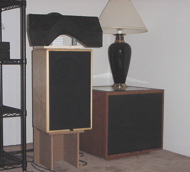

Hey Fish-on,
Beautiful setup. Are you happy with it? Here a link to some pics of my old system.
http://www.diyaudio.com/forums/showthread.php?s=&threadid=4840&highlight=rodd+system
My new setup is similar below. I too am using the TAD 1601a’s in ported boxes.

Rodd...thanks for the link...nice system
Well...I just finished the speakers a couple weeks ago...so I may still be in the honeymoon phase They do sound pretty good tho...I wasn't sure how the 1601a's were going to match up with the horn mid/tweets...but they do pretty well. I was more concerned with matching with the mids than producing the lower Freq. If I could ever get myself to stop listening to music I plan on trying to tweak the system a bit...but it's tough. I do want to try a few more cross-over points...but right now...I'm just enjoying them
