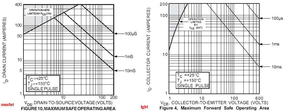

A word of caution - although the SOAR is awesome and the devices are no doubt very rugged, the duration is very small and the case is 25C. You admit to 50C days before the amp is powered up! What's the 1 second curve - same derating as the previous two?
Set up in an amplifier at 80V rails the pkg allows about 5A at zero crossing . That's at case of 25C and continuous. You're opting for 75C and the pulsed region to drive reactive loads. I usually design for driving an 8 ohm load of any phase angle. Then -
Supply Voltage/8 = 10 amps so it should be capable of 10 amps at zero crossing. Therefore 2 devices per half (2 upper/2 lower)

Since we employ dual side heatsinking and devices are mounted using bar clamping with nuts and bolts.
The mounting order is of type ------5mm thick Aluminium bar--> IGBT device --->8mm thick copper slab [3"X3"]--->10mm thick base aluminium heatsink. Nothing sort of insulators between devices and heatsink.
The one second curve is slightly lower than other 2 curves[obtained through special request from APT].
We have tested the amp with reactive energy discharge and found out that these monsters are really very rugged, nothing sort of damage is encountered during driving of highly reactive loads. Although we have plans to boost the output power of our module upto 1800W using 2 pairs in parallell in order to increase thermal safety in long run.

Dear Kanwar
I noticed the lack of second break down in the APT devices. However my remarks were more a general point of view. I think it is safe to say that BJT's (and IGBT's) in general have a second breakdown region. Which causes a mpre or less significant reduction in the current performance.
The real problem of IGBT's is still the turn off delay however. And i would guess also the price per dissipated W .. ? This is just a guess however. Just for fun i checked out your device from APT. Turn on 38 nS, turn off 230 nS. Enough for me to render it unsafe for full range audio. Maybe ok for a bass-only amp though
The benefits on the other hand are more difficult to spot.
You can dissipate 295W at 20 deg C in your IGBT.
In a MOSFET also from APT like the APT50M65LLL (same case)
you can dissipate 590W. Exactly twice.
And in that one both turn on and turn off delays are around 30 nS. Now that's what i call a stable and reliable output device.

Thanks for updating your knowledge. The devices from APT doesnot suffer from second breakdown voltage.
The device may be rendered unsafe for audio according to you, but only in audiophile quality Hi-Fi, because our amp is delivering 50KHz of clean sinewave with no sign of cross-conduction at full power there fore it can be very well implemented in professional audio amps. Meanwhile the switching times of IGBT are still lower than corresponding bipolars used in pro-amps.
We have also used APT20M18LVR , a 200V 100A Mosfet[16US$] with dissipiation of 625 watts @ 25.C which at 65.C temp its only capable of 275W . Whereas the APT100GF60LR [14US$]is rated at 300W @ 25.C , which still has 200W @65.C of dissipiation.Thats because of PLANAR CELL TECHNOLOGY which increase the power density and high temperature operation.
Secondly, We also use 20 X IRFP260N mosfets in our 2400W amp.

Thanks Kanwar, very interesting ;-)
Looking at the datasheets of the MOSFET it can dissipate 625W at 25 deg C with 5W per deg linear derating. So at 65 deg this is 40 deg * 5 W deraing = 200 W derating. Right? And 625 - 200 is 425 W not 295 W.
On the other hand looking at your IGBT from figure 9 you can see it can safely carry 100 Ampere at 100 deg C. From fig 3 you can derive that 100 Ampere will give around 2 V + drop across the device. Even if there is no exact data formula for calculating the dissipation at elevated temperatures, i think it's safe to say that your IGBT can also dissipate 100 * 2 = 200 W at 100 deg C. Which is pretty good for a BJT.
So
IGBT 200 W
MOSFET 425 W
(both at 65 deg C)
So
IGBT 200 W
MOSFET 425 W
(both at 65 deg C)
Hi
Dear Lars,
I agree with you there was an error in my calculation.
Thanks for correcting me.
By the way kindly look at the SOA curve of mosfet and igbt and you will see a vast difference in current-voltage curves for both devices.
SOA curve --> mosfet-->VDS 80V-->ID 12A-->pulse 10mS
SOA curve --> igbt -->VCE 80V-->IC 36A-->pulse 10mS
There' s a huge difference in current capacity at 10mS pulse.
In my opinion IGBT still has the Edge over the Mosfet.
regards
Kanwar
Lars Clausen said:Thanks Kanwar, very interesting ;-)
So
IGBT 200 W
MOSFET 425 W
(both at 65 deg C)
Dear Lars,
regards
Kanwar

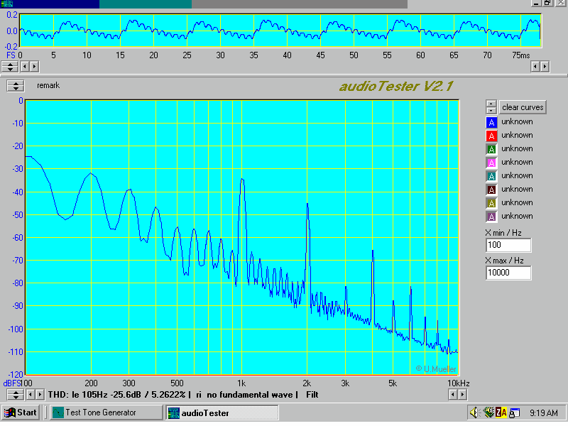

Lars,
Aren't you being a little unfair to Kanwar's IGBTs suggesting a 200W rating due to 2vx100A on the saturation limit. You could equally well have used 4vx200A = 800W on the same curve. This is not definitive for the device dissipation.
Better to consider what it can do practically in an amplifier i.e. at the supply rail voltage of 80V Kanwar is using. Since they are essentially a BJT for power they should presumably be derated from the 390W case dissipation at 25C to 278W at 75C. This gives current of 3.5A at zero crossing for reactive (real) load driving ability. As with most rugged BJTs this can be relaxed due to pulse duration and duty cycle. In Kanwars application we can assume seconds+ and 50%, which could reasonably reliably double the current output ability given the ruggedness.
So I would put it at around 550W giving 7A at 80V rails. But where is that BJT second breakdown?
Can you imagine the hash on the supplies at such current /power levels. Attached is a pic of the supply of my 250W /8ohm amps supply rail on the circuit board when output is 5W rms into 8 ohms. See the induced harmonics due to the Class AB half currents. This is what lurks on every AB supply waiting for a poor PSRR stage referencing to the supplies.
- What every Class AB builder needs to be constantly aware of
