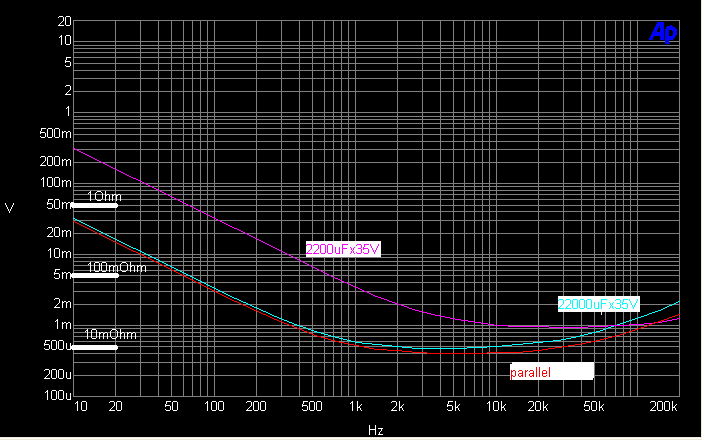

I made quick measurement of 2200uF and 22000uF Panasonic caps. They both are rated for 35V and belong to the same production series. The parasitic resistance of ten 2200uF caps in parallel can be 2mOhm; this is 5 times lower than the parasitic resistance of 22000uF (10mOhm). But for the money spend on 22000uF one can buy only three or four 2200uF caps. May be the price ratio can be different from another manufacturer.
It is common practice to put small cap (220-2200uF) near the output devices on pcb. It is generally accepted that all even hf harmonic current shortened through these small caps. Assume that the main caps connected by two one-foot 16 AWG wires (10mOhm), and the solder joints another 10mOhm. From this impedance measurement one can see that _only half_ is shortened through smaller pcb caps, and for signals _higher than 10 kHz_.
I've been parallelling small value caps since the high 80s in my diy stuff.
For a diy-er this can actually be an advantage, often a large number of smaller capacitors can be bought for far less than a big one.
Another advantage is the often smaller volume required, which in return makes the amplifier chassis a size smaller ; less money, less raw material.
Not so long ago i bought a large box of 4700uF surplus Roe capacitors for 15% of the msrp, they will serve my needs for some time.

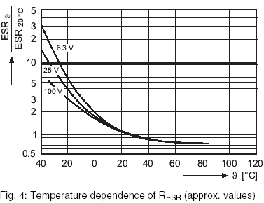

it splits the internal resistance heating over several components and has to bode well for component longevity especially at high current/arduous operation. I even went to the extent of stripping my 16 PS caps in the Eidetic amp of their plastic sheath so they could better exude their self heat for longer life
The higher the operating temperature, the shorter caps life, yes, but the ESR declines two times with increasing temperature from 20°C to 40°C, so better keep ‘em warm.
further good reason - it splits the internal resistance
When caps are connected in parallel thermal imbalances between them is important. Thermal runaway may occur if they are unbalanced which could lead to cap failure.
Thanks for posting that dimitri. But you might note that the ambient temps seen by many electros are already in the significant ageing effect range, especially in 'cooking' amp chassis running high bias AB or Class A!
Perhaps you have handy a similar temp graph for the ageing of electros and we can might just find the optimum in the range 25-50C so you would only want to warm them in cool climes and then it's diminishing returns for the ESR much beyond 25C. Better to desensitise the amp to such vagaries or you will be hearing your Cs warming up.
I'm sure Kanwar would be looking for an icepack for his with 50C ambients and a 75C chassis. That's only 4000 hours lifetime for an 85C cap. And that's before it falls over?
surely I have, inside my poor head
Every 10° C increase in internal temperature halves the cap lifetime.

Dimitri,
On the subject of multiple paralleled smaller capacitors compared with one large one, do you have the graphs of impedance vs frequency to locate the max frequency tey are still acting as a capacitor - before the inductance kicks in! That would be of value here.

that impedance diagram is a surprise.
Intuitively I would expect the impedance reduction to be about 5 times lower or a little higher say 4 times for 5 in parallel.
The gain in impedance lowering is better than divide by 5 over a large part of the frequency range. It even shows better than 10 times lower and over a small range must be about 100 times lower.
The impedance minima shows a trend towards higher frequency as more are added.
Can anyone explain what is happening here?
