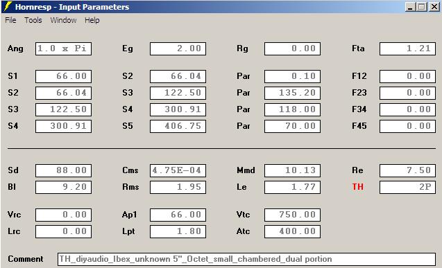

Advanced Tapped Horn versus simple Ported/Reflex
Hi guys,
I'm pretty upset, cause HR was predicting better results for and simple reflex design in comparison to an advanced tapped horn using the same driver. I always thought, that a TH offers less excursion for the same effiency and low end or more spl and more low end for the same cone movement?
Please tell me, that I made something wrong with the simulations, unless I'll get completeley nuts...
Watch out the HR data/plots:
black = ported/reflex
grey = tapped horn

I smell burning coils in a rookie wishful thinking tombola design showing a TH that only would survive frequencies above 100 Hz.
Your 'Ported' (Nd-pipe in reality) is clipping severely for frequencies below ~180Hz.
Compare you HR designs with my(not commented) earlier posted simulation.
What's wrong with the SPL I achieved in my simulation?
It's IMO clear you have little knowledge how to use HR.

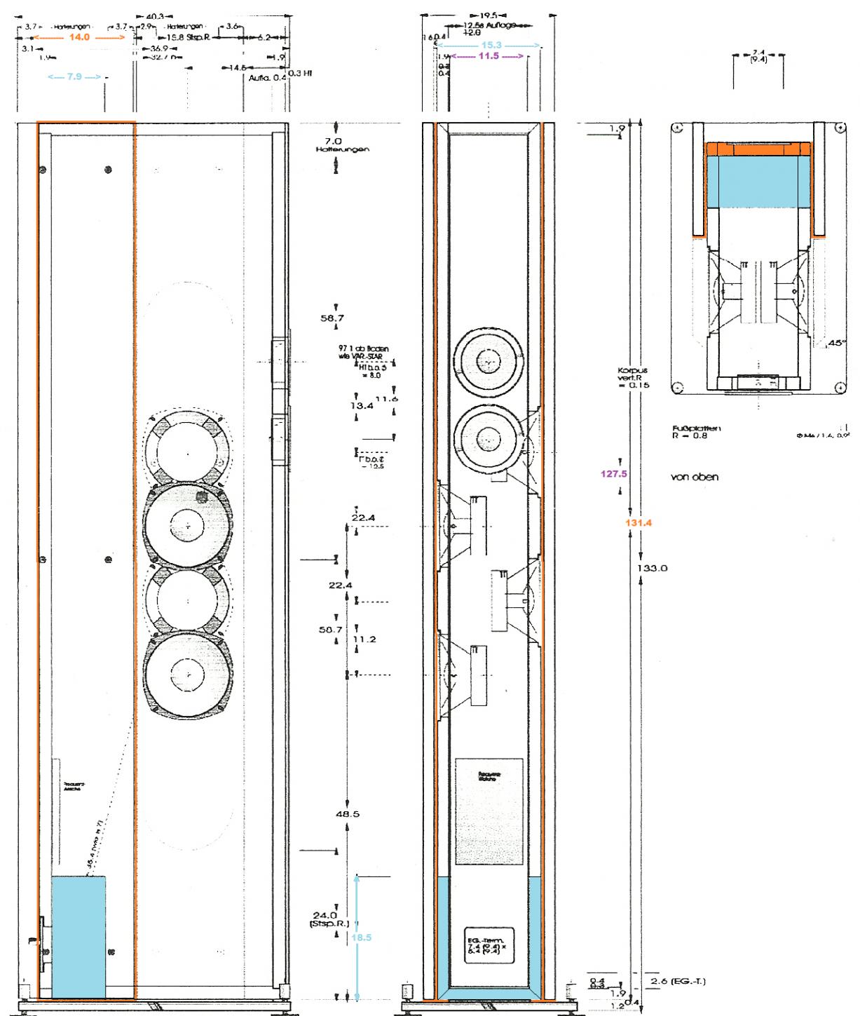

Without having time to really look at this: the BR is not a BR, it is a 163cm long tube with a reduced opening on one end, and the four drivers on the other end.
I have to agree with you, it's not the most accurate simulation. To make it more precise I would have to write a script for Akabak.
I tried to model the original reflex cab, which I got the drivers from.

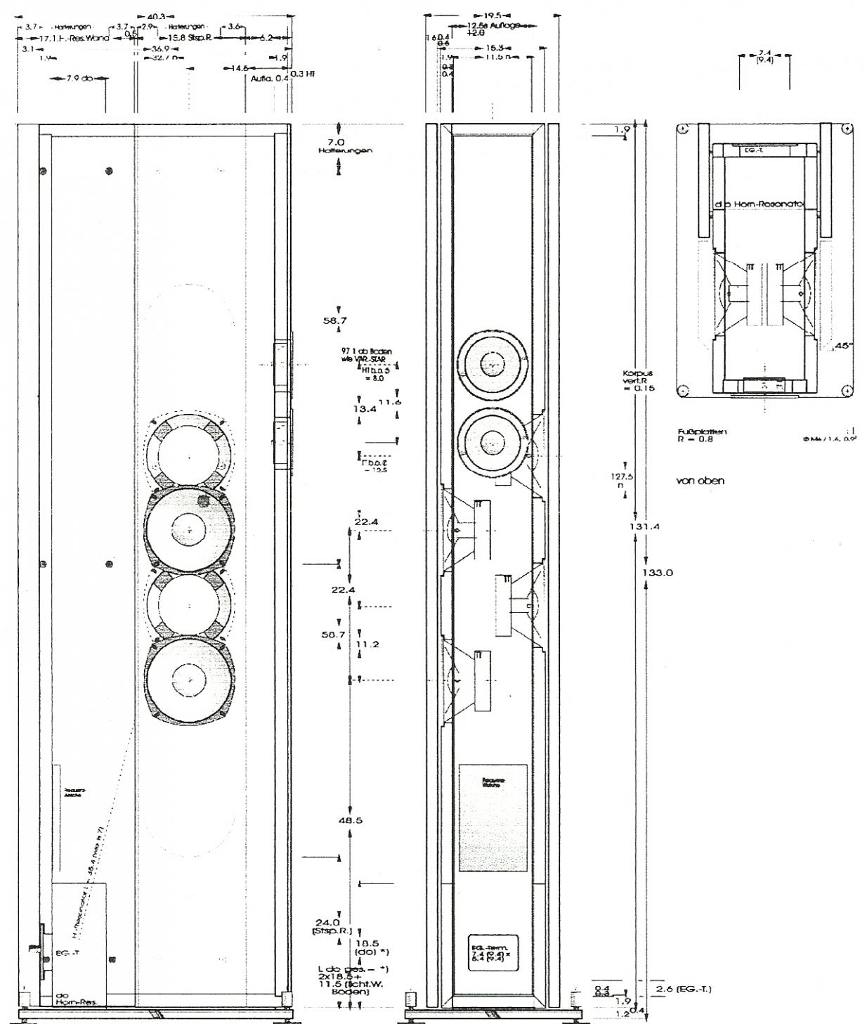

In fact it concerns an enclosure which is 127.5cm tall with an 376cm² footprint, the drivers aren't mounted at the beginning of the line, but in the middle of the whole cab. At the bottom resides the port which offers an average length of 35.4cm and exhibits an cross sectional area equal to the footprint of the cab.
The biggest challenge to make an 100% congruent Akabak model of the cab would be to implement the fluctuating port legth into the script.
Have you got a clue how to do this?
Attached there you have the enclosure design in detail:

I tried to make the drawing more legible and marked the beginning (blue area) and the end (orange area) of the port, I reentered the necessary measurments including the internal width/depth/height as well... (depth = 32.7)
I'm pretty sure that there are no internal dividers, I took a look inside the cab.
Hi Ibex,
Yes, the coloring helps.
It looks like the areas/volumes in blue and the immediately adjacent brown areas/volumes can be treated as part of the chamber volume. From there the porting is through slots leading out between the chamber walls, the base board and a couple of side mounted loading boards. The distance from the chamber volume to the outside at the bottom (sides, back and front) is so short (essentially the thickness of the loading board at the sides), that I doubt that there can be significant loading of the slot upwards. So you have a relatively short distributed slot port tuning a very long vertical column, almost like a MLTL, with the drivers mounted in the middle of the sides.
I wonder whether this was done for the sound or for the looks. It may help to run some impedance and frequency response curves.
Anyway, have fun modeling this.

Indeed, some kind of mass loaded transmission line...
The gap between the main enclosure walls and the side mounted boards measures 6mm.
