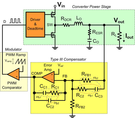

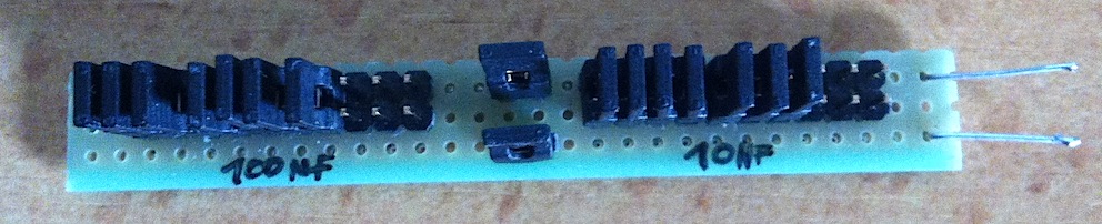

Back on topic, another very useful and simple tool which can help you to trim the FB compensation in order to stabilize regulator or improve transient response on practical implementation, I call this tool "Poor man's decade capacitor box" (10x10nF + 10x100nF SMD capacitors + jumpers) :)
When testing regulator for transient response (mentioned in post #8 and #9), whit such tools simple replace existing capacitor in FB path of regulator and observe the response at output.
Try different combination of jumpers (different capacitor values) until you get the lowest over and under shots and get rid of "ringing". When you find the best combination, simple measure the capacitance of those tool and replace with equivalent value capacitor in your regulator.
It is not the perfect method to do things right but it very easy method and can greatly help to stabilize/improve FB of regulator (or amplifier).
Also with some trimer/potentiometer resistor replace R in FB path and again try to find the best results.
At the end you will have quite close to optimal values of R and C for FB compensation.
Second picture is just for reference on what R/C values I mean. It is usually the same in all implementation, just types of compensation differ (Type I, II, III …)
