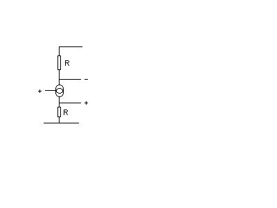

On the isolation between digital and analog
So the idea I'm getting is a balanced phase splitter (Concertina) probably would not be that great when used in analog to analog applications but would be ideal for say inside a DAC?
On that side note, If that's true, would this type of phase splitter go before the digtal signal was converted to an analog signal?
I'd still like to hear what type of balanced output is ideal, which on kills all others?
David

dhaen said:Concertina is not the only kind of phase splitter.
Right. I use the old paraphase myself, with a 250k pot to set the signal pick-off point. I get both sides within <.01V, no matter how unmatched the tubes are.
Re: What do you mean Joel?
The standard RC-coupled "paraphase", uses two triodes. The grid resistor of the 1st triode has a tap which is tied directly to the grid of the 2nd tube. Usually, the point is determined by two fixed resistors, but I use a pot instead, and the wiper is tied to the grid, so I can move the pick-off point around. Look in the back of any RCA tube manual for an example of the (unmodified) circuit.
EternaLightWith said:What I really want is your thoughts on what you would use. If going push-pull.

Re: Question on your schematic
The tubes do not need to be matched. Tube "matching" is a marketing gimmick used by retailers. But the tubes should be of the same type.
They are cathode biased. Do you understand the schematic?
EternaLightWith said:Is the performance of the circuit dependant on the mu of the tubes? Would the tubes have to be matched? Would an auto bias circuit work?
So it'll work if they have different cut-off voltages?The tubes do not need to be matched
dhaen said:So it'll work if they have different cut-off voltages?
Frank? Is that you?
John, in all seriousness, there was nothing ridiculous about it. The triodes in the above circuit do not need to be "matched". They do need to be the same though - ie. both 6J5, or one 6SN7, 6C8, 6SC7, etc.
Matching implies there is no compensation mechanism built into the circuit. I never rely on tube condition to set the operating points of the circuit.
