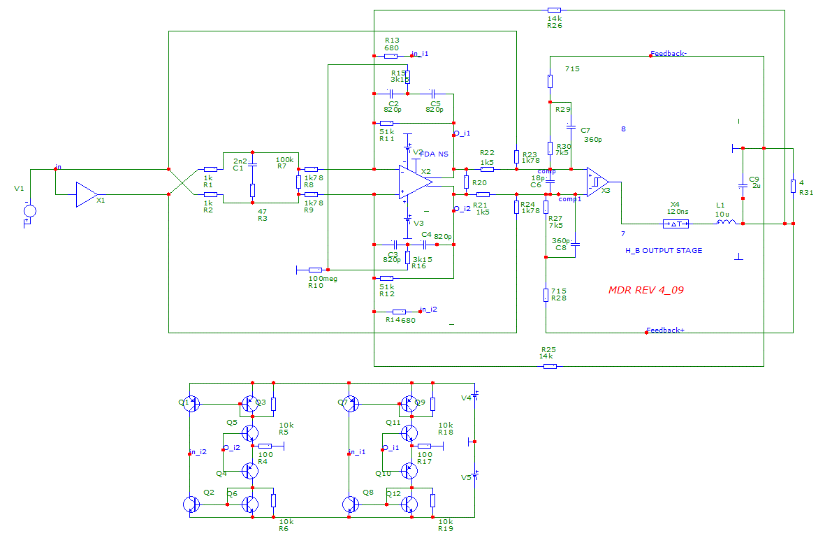

it is from a paper, this idea, I think reinvent the wheel is not needed here, the window does prevent shift down of the carrier when driven hard I did read there. <snip>
Aha Yes, I know now, Well, I think "Russian version" or UCD+ seems to be superipor and much simpler then this.... This is over complicating (just my opinion), probably not that easy to implement in real design.
I thought you were going to try this method I linked from russian forum..., as it seems you did, but I cant follow any more, you implemented many designs, but didnt name them.

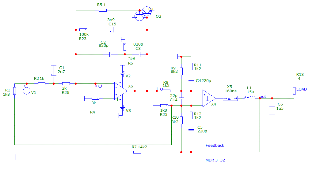

So which design is this on the last three images, last post ? Seems not to be from Osted DTU paper, and also not from "russian forum" I linked. And looks like pre filter feedback.
Becasue this was implemented on "russian forum" in real desing, and with real thd measured 0,001% THD, lets continue with this.. seems very simple feedback.

You are possible right, but I do learn from it, and this is just what I want to do, afcouse together with your informations, I was also busy with a triangle version, who is open loop, making the triangle as precise as possible and with feedback.
I think about the transitor network just make a amp who has much headroom can make things simple, and use good protections, special current, and dc.
the paper is old, and is not a deign but more a studie what happens with multipole designs, who can be unstable.
These are UCS,s self oscillation versions though, I did see the last did best, and looks like yours special the error amp.
Good idea with the antiparallel transistors, works like a limiter, when overdriving sound get limited and bad I see you using a
series resistor so limiting is less hard, avoid trouble getting unstable?.

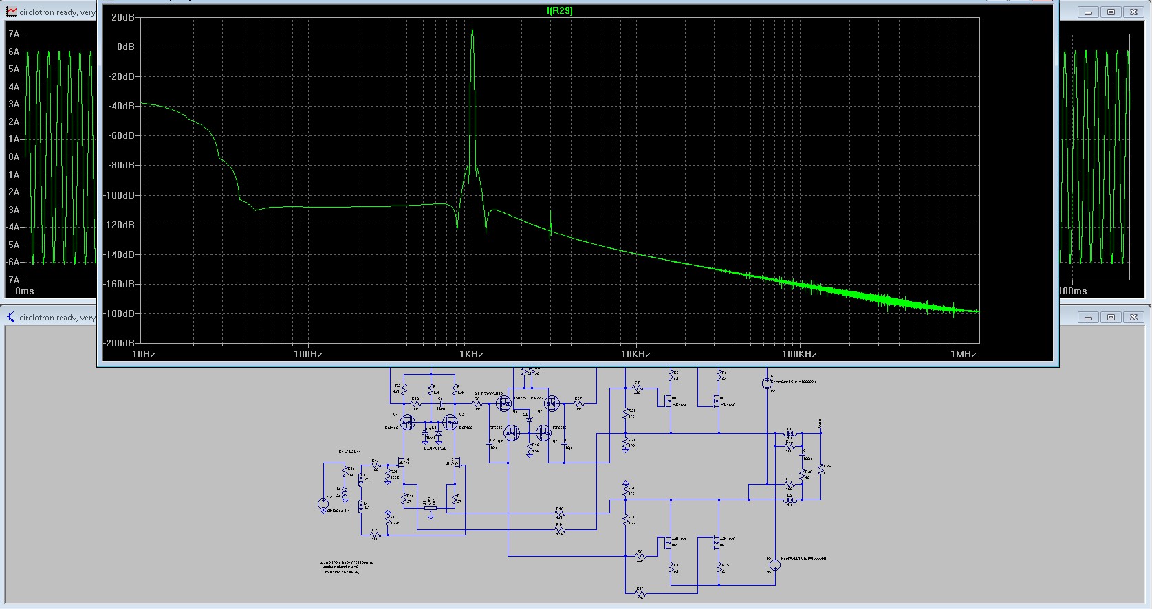

The amp I do work on now has current feedback, I did have such one and did sound very very good, nerver had a better one seen for mine ears, but the hybrid tube mosfet did outperform that one later, so is mine favorite, but learing is always nice ofcourse.
last picture is of present build, a allfet circlotron, busy with pcb and building of a wind machine for the input transformer, last is more work, but I am far with it.

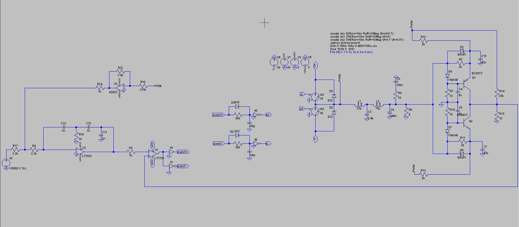

The designs are from IR.com the audiamp or such, and looks like you did, however you have a fase shift class d as I do look good, I have drawn it and look what it does in sim. Also some are from other papers, I do stop the fase lag system, you are right to complicated, now with better parts who are faster, we get more liniarity when modulating, maken it possible to go less complicated.
The simulations schematic is from @grizlek thanks to him, now I can simulate more faster and look at it with dead time. I just try some different designs, it is not mentioned for build, not yet because I am busy with circlotron, after al th days like christmas and new year, I go work further on the amp, I am quite busy also with other important tasks, like helping mother.
But it is fun to see results, I go look and try your design, I have seen it is only post feedback, I do not like feedback, that is also I do look and sim some other stuff, like with a separate carrier oscillator, or even current feedback who is independent of bandwidth and as such give little impact on sound, it stays fast, and IM is very low.

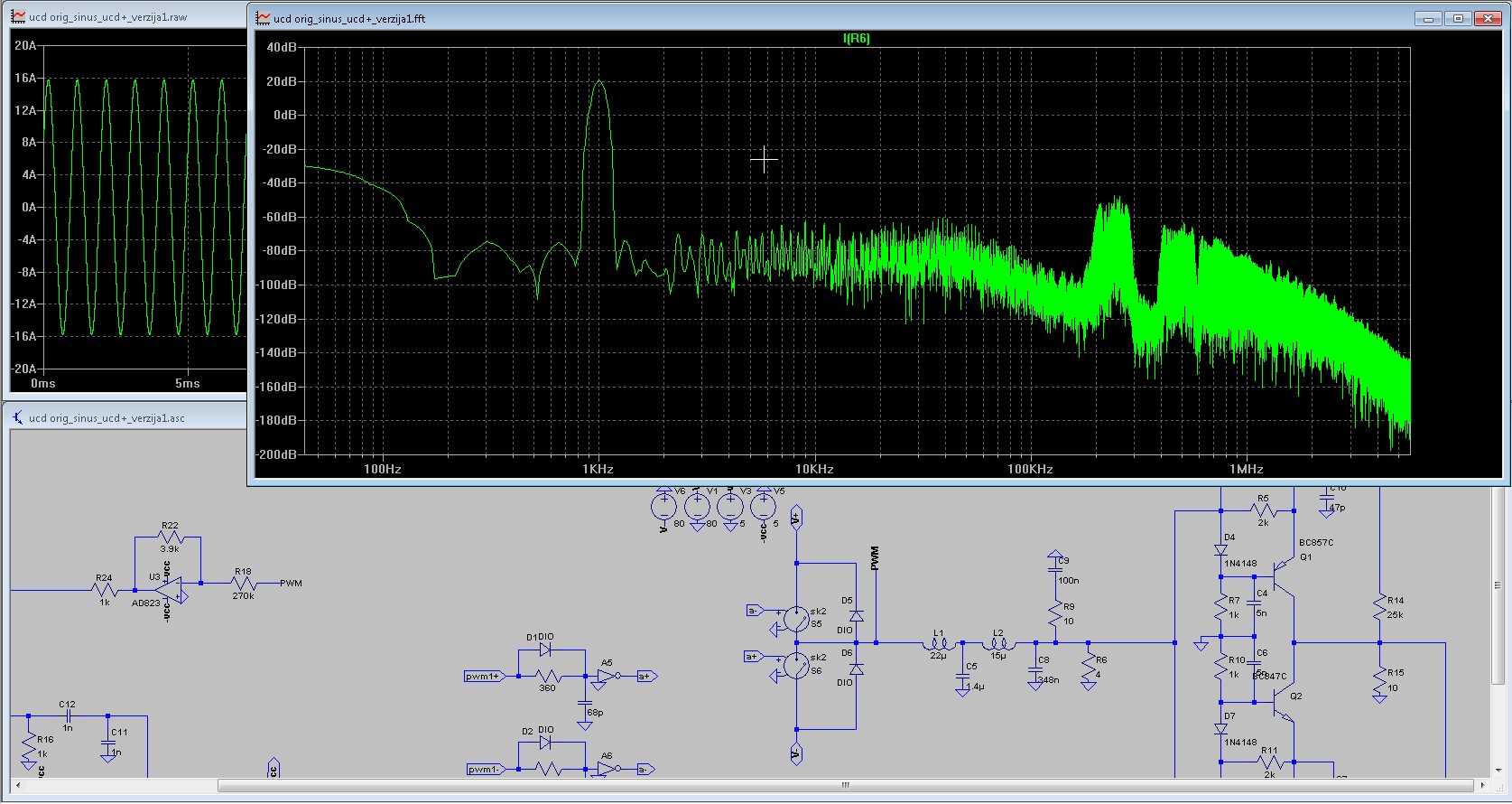

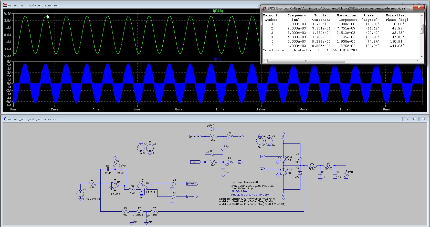

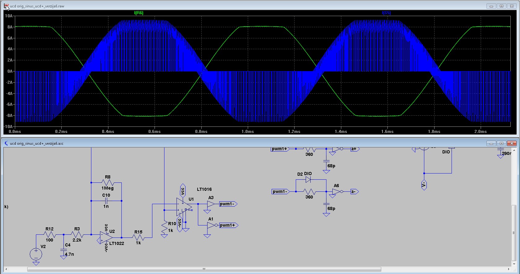

Hi All

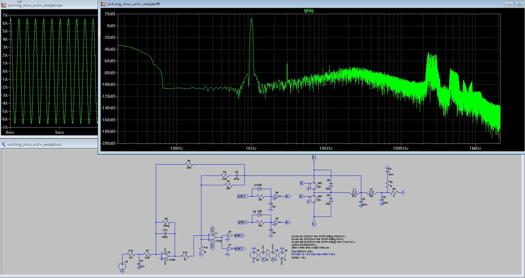

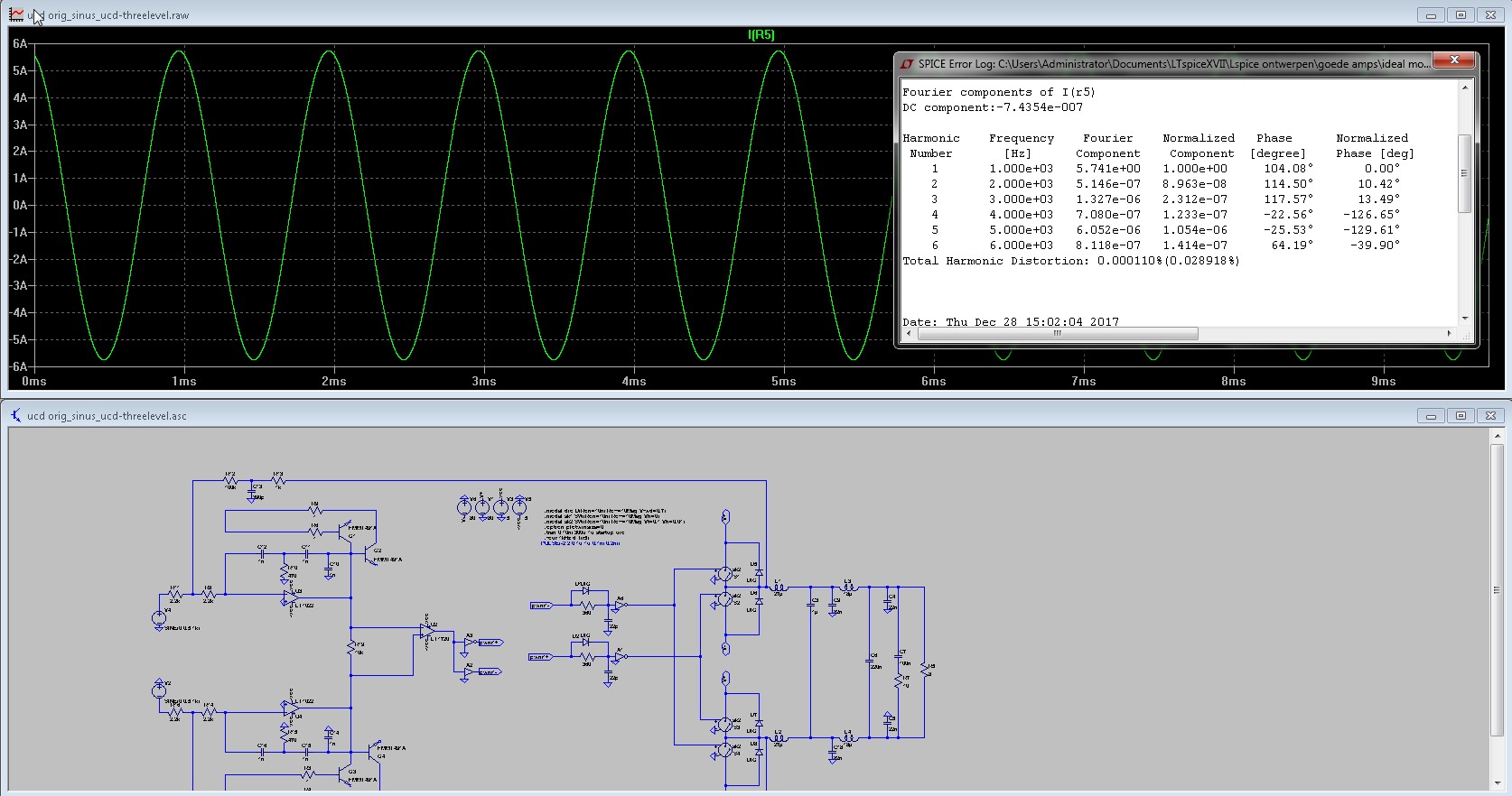

I have done some sims with the russian version and the audiamp from ir.
The transistor limmiter in error amp do rise distortions, because of transistor capacitances, it go from 0.00011 to 0.008 procent, I did use the simpel two transistor version. Yes I know in real work it quite different, the switch models are perfect, I do try it in a model of the power comparator or the IR2010 model to see different, with good coil and caps we can get low distortion with pre feedback.
The UCD can be made very good, but the trianle carrier version also can be quite made better with good parts, a current feedback version is more difficult because of the low pass fase shifting, also post feedback has om the same reason trouble, it shifts the fase, a bessel lowpass do not, maybe that is possible burt then we have not constant amplitude behavior, but fase stays oke.
For such simple technology, it is quite complicated to get a real lineair modulation scheme.

If you want open loop, no feedback, make multiple voltage level class D.. reduces THD very much , and without feedback. Now we have 2 voltage levels PWM signal. we could have many voltage levels, for example 6...

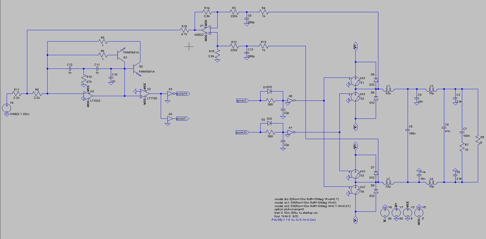

I only omplemented classical UCD in real design long time ago. I did simulated in spice this "oersted paper" versions, but was not satisfied with stability. I actually contacted the autor of this "Oersted Univerity " paper, we had some chat over email. He says this is just his approach, and he agrees that Bruno's Hypesx and UCD+ does not use this method for sure, and that he does not know what method Hypex use becase it is a secret and every hypex amplifier comes with "epoxy glued" electronics. So in Russian forums, I would say they "crached" real Hypes design (using those transistor network for stability). Actually I never tried this design, I am not sure how this transistor networks kills additioanl poles/ zeroes to prevent amplifier to oscillate on different frequency.
But Bruno in his papers mentiones "transistor network" for kissling additioan l poles and zeroes when modulation is high to prevent unstability (something like that)
I am sure DATASHEETS, and MANY ZEROES in THD like 0,001% SELLS hypex. And I am also sure that classic most simple UCD (from Brunos patent with 0,1 % THD from 20 khz to 10 khz (frequency independednt) ,and with VERY stable transient response (square input) and with alsmost 100 kHz bandwidth (no phase shift in audio range) SOUND maybe better then all those 0,001 % amplifiers. 0,1% THD CAN not be heared , but phase shift in audio range and instability of amplifier can.

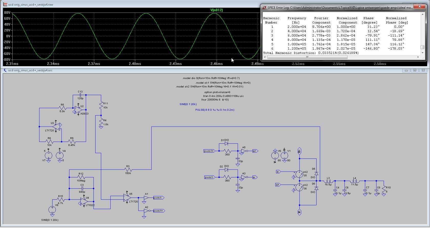

None of those is not mine except spice schematics which can be used for faster simulation (using logic blocks).
Using most simple feedback like classic UCD (from patent) and multiple level PWM modulaton could achieve 0,01% and GREAT stability. Or using this UCD+ hypex "Russian method"

Please send spice file, not just image, so I can try to simulate also. Also I have very little time lately for class D (just not to waste time drawing in spice which I am very low) :)
I dont see schematics good in those screenshots: But this is not "russian version" I see only pre filter feedback version, not post filter feedback.. ?!
I would say that D class when LC filter is outside feedback is not good ?!! In originall UCD you can have 2- 100 ohm load, and LC filter characteristics can not be seen on the output signal near 20 khz..

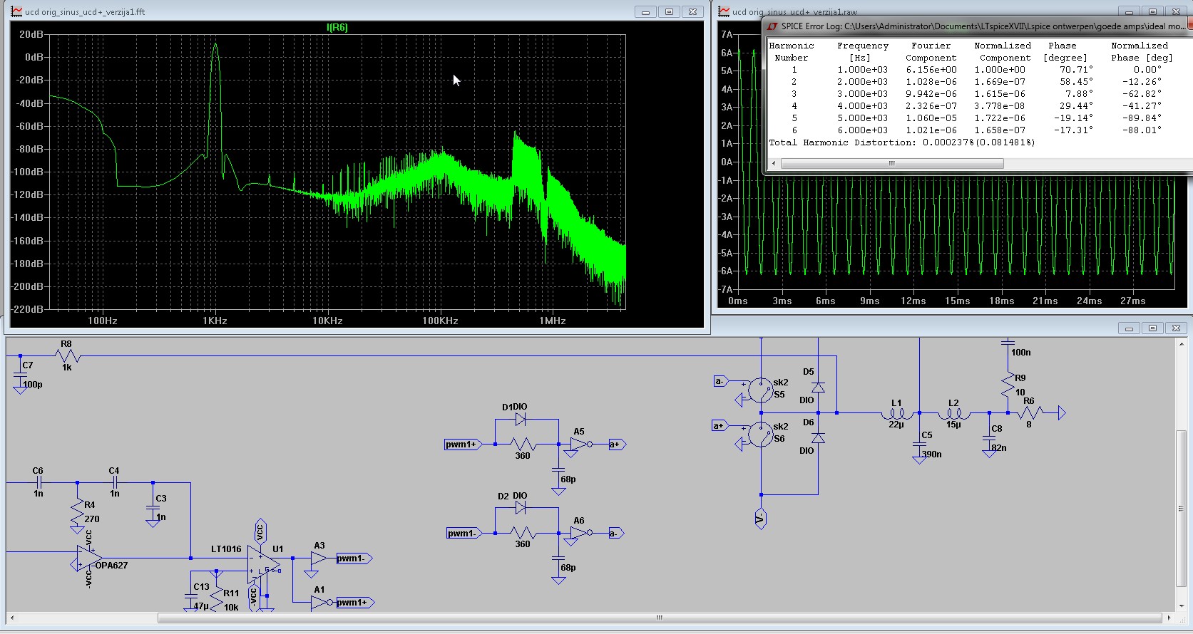

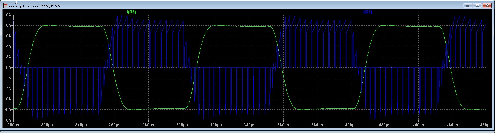

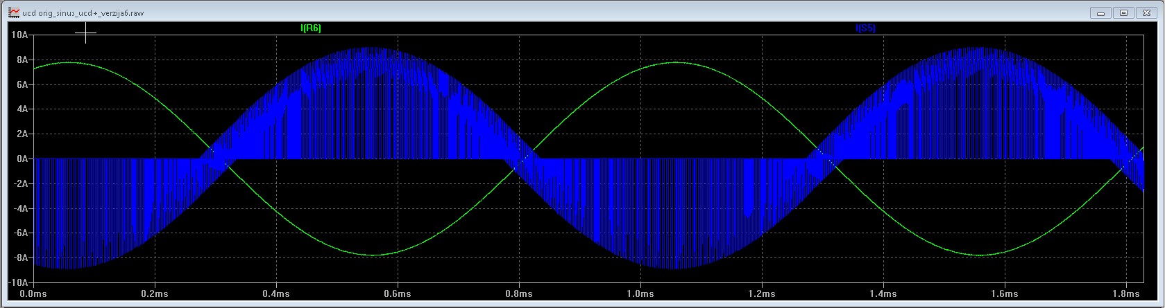

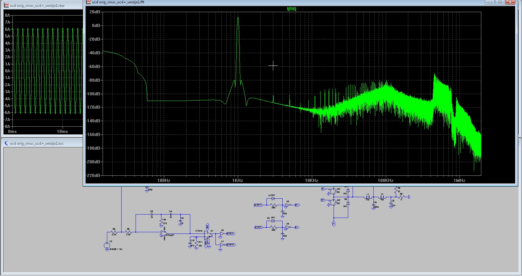

I have done some sims, but the UCD version and the delta sigma are the best, delta sigma is even without postfeedback low in distortion.
Here some results, also with squares, maybe time to duild one to see and discover the sound, I am curious about this technology.
Nice to see that current trough mosfets looks the same as with a stereo coder for fm hehe, much more liniair here..

Part two, was out of time here.
I did use 24dB octave filters on output, then can use low switchfrequency who is better for linearity, these two types of class d do quite wel, include the coil in feedback give indeed more control who you can see on the sqare test.
Make myself a power comparator and modulator on separate board for testing, if this do not make trouble afcourse, using coax for signals help.
The little peak on 3 Khz is proberly from sim and not present in real.

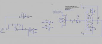

here I did a full bridge, with a single ended input, a trhee level is also option, but then we need pulses on the zero transistions otherwise we get crossover distortions, we can clock these pulses and inject them there, did see something about the a while ago, do not now where.
The full bridge does supress the even harmonics but I see more uneven harmonics with it, of this sounds bad I do not now, mine ciclotron has also this problem, it is due of balanced technology.

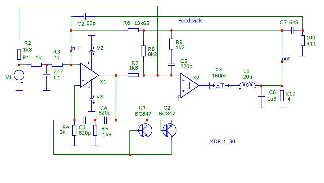

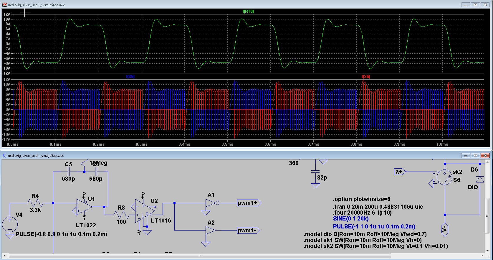

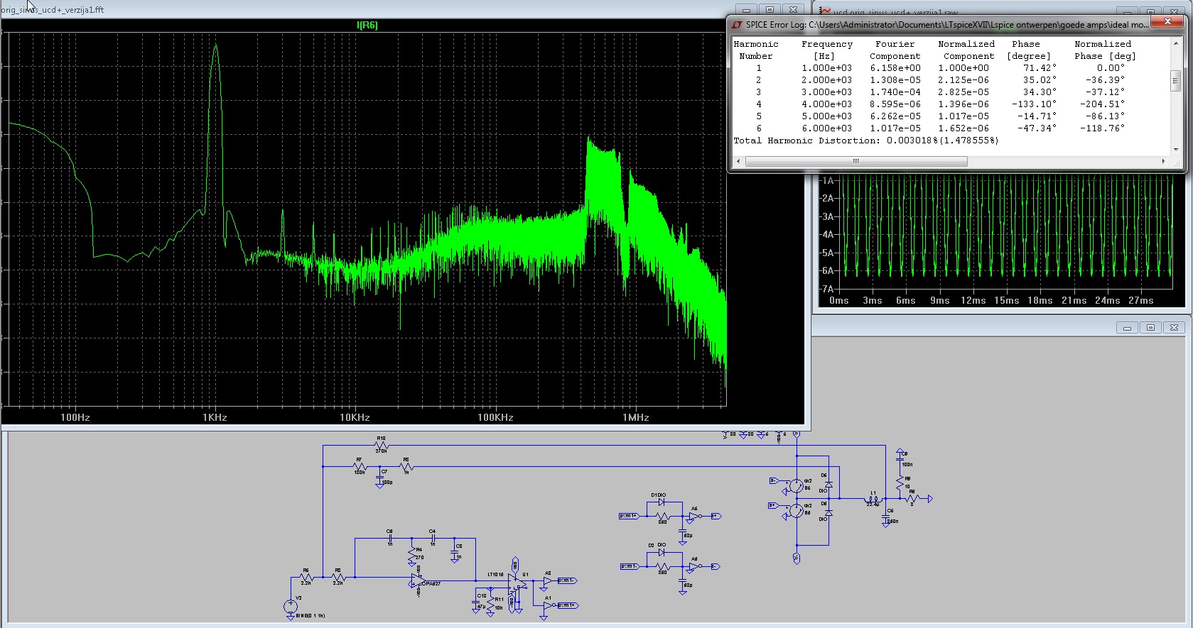

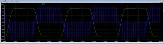

Today when get sober again from al that beer and stuff, I did some hobby here, trying a transistor feedback bridge who do have kind of proportional feedback, it does change feedback with signal voltage, I think Ncore is such a way, as Frizlek did mention if I remember.
The feedback hysteric bridge is from a old paper, adjusted for here.
There is a low distortion and stability even when driven very hard, when signal is high feedback get,s lower, it keeps the carrier quite on his place.
Overdriven it do stop the oscillation of the amp, but do not see uge amps, only a square..
polarity of signal is important for right working on feedback, so it stays negative otherwise it go osclillate on 3 Mhz. when keep capacitance low in this bridge it will
