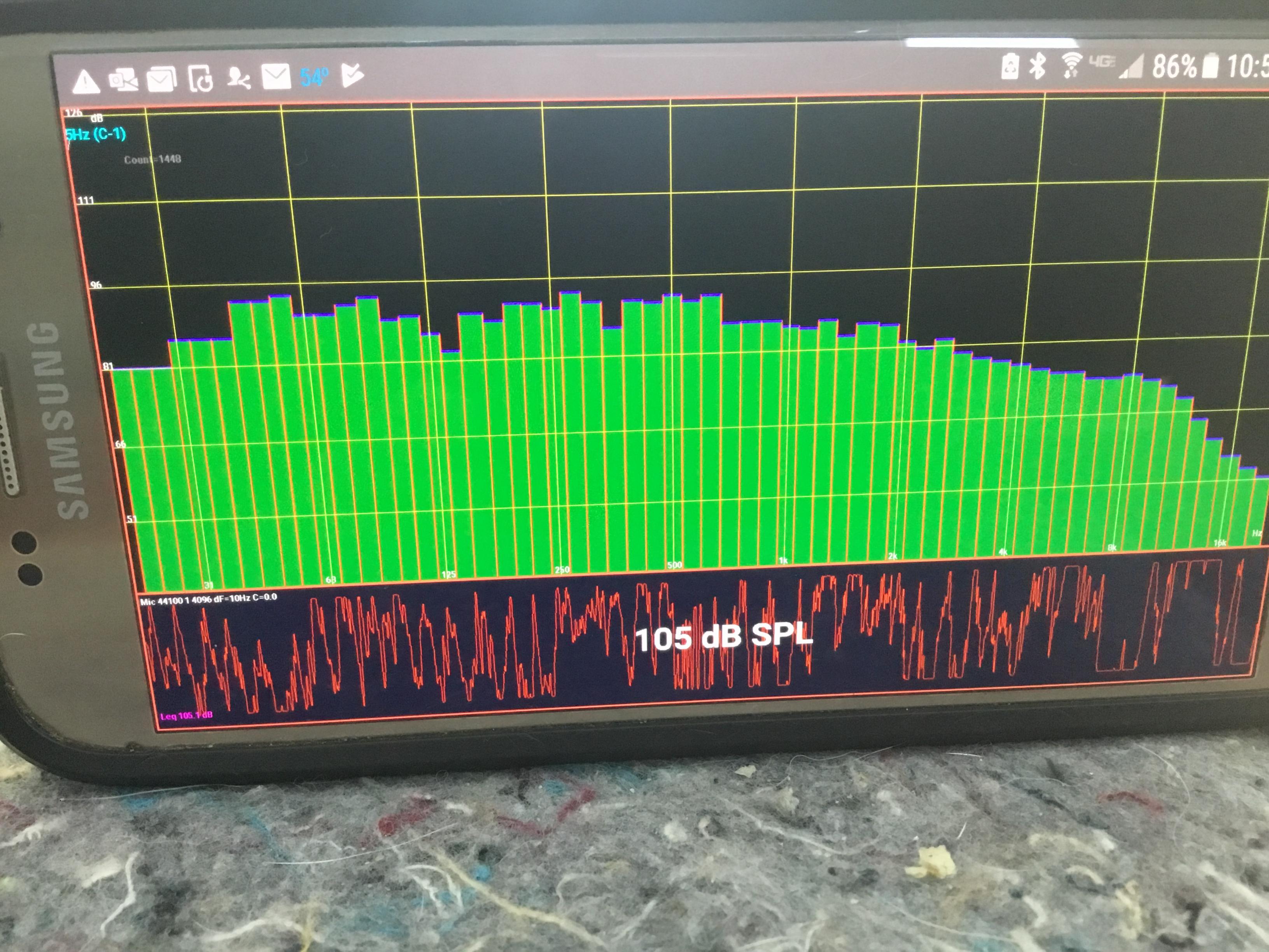

Have some drawed the spl curve they like the most at listening position - say from 40 hz to 20 k hz- ?
I like it to start dropping @2k
This is @ lp (about 9’ center stage)
One song average, I think the abrupt drop @ 10k is just lack of source material.
I find @ higher volumes this drop from 2k helps tremendously with listener fatigue......I could not listen very long at all if it were flat.
Edit.... and yes I know that’s too loud but it was during testing and it also relates to my normal listening levels of mid 90’s @lp.

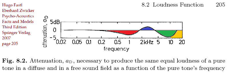

I think there maybe frequencies which many of us are overly sensitive to, perhaps related to the shape of our ears. The attached was something I grabbed from somewhere in the ‘net about the best subjective FR based on human trials.
