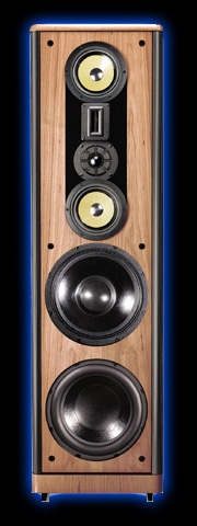

Wseaton said:But....wouldn't that show up on a simple response measurement as a spike at 6-7k? Or, is the sudden radiation over a larger area just not picked up by well by typical measurement equipment, but more obvious to our ears.
Well, I was probably too restrictive on my frequency range estimate, as anything from perhaps 3-7k can probably cause some of what you are describing - although a 6k ribbon resonance (much larger ribbon with a cavity resonance) has caused sibilance and enhanced guitar articulation noises and really harsh female vocals on a friend's pair of speakers.
The broadening directivity issue will not show up on a single gated on-axis response plot, but it would probably show up on an RTA measurement with pink noise if you have good enough resolution on the RTA - 1/3 octave or better. It would also be visible on a polar response plot.
Legacy speakers look neat, but it is really hard to integrate lots of drivers. From the response plots in reviews I have seen, they don't always measure that well, but get fairly decent reviews as "big sounding" speakers. Difficulty in speaker design goes as something like the number of drivers times the number of crossover components raised to some power. This is to say it is probably 100 or more times as difficult to design a 4 or 5 way as it is to design a 2 way. On a similar vein, I have never seen measurements of a VMPS speaker

Stereophile's measurements on this speaker can be found here: http://www.stereophile.com/loudspeakerreviews/104legacy/index5.html . There are some peaks in the response that could explain what was heard.

Hmmm. From the Stereophile article:
...I, on the other hand, suspect that possibly 'PB' may be a little lacking in his top-octave hearing, or maybe the amplifiers used (none of which I have familiarity with) in the review emphasise midrange at the expense of anything over 10K Hz. IMO, of course.
In the treble, PB noted that the speaker was, if anything, a bit forgiving and soft, yet fig.5 suggests a rather exaggerated top octave. I suspect that what is happening is that, given the weighty bass, the ear latches on to the level of the Legacy's top two treble octaves as its reference, identifying the lack of energy in the upper midrange and low treble as relative softness and lack of aggression.
