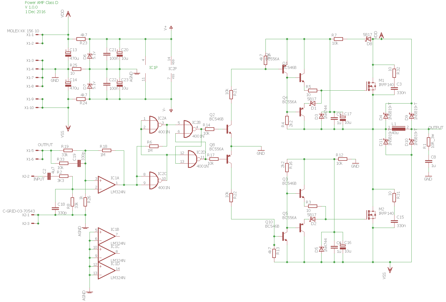

Whatsa matta you don't like mosfets? You could build a little Class D amp with the Mosfets. I'll attach a schematic.
This can be bridged to double power by replicating the output section and driving the second section from opposite phases from the CMOS gates.

Build a little Class D amp with the Mosfets. I'll attach a schematic.
finally posted schematic. The Op Amp sucks for audio, but here it is a comparator. LM311 would be better, but you said LM324. Mature technology for sure. The transistors can be whatever you have, small signal, and any pair of N channels. I tried hard to use a power resistor, put it in the Zobel network on the output. This would probably sound good if you build it on a PC board with power and ground planes galore, but like any switcher would be hopeless on a wired breadboard setup.

Thanks for posting the class D schematic! Very nice. To be honest though I've done switching/digital stuff for a few years so I just thought it would be neat to try analog for a change. I'm not opposed to including switching elements, too, with this project (for instance I'm not insisting the power supply be a toroid transformer) but I am curious to see how far I can go with linear mode parts. Plus, I've been hanging onto some of these TIP31s for 20 years waiting for a use for them. :D

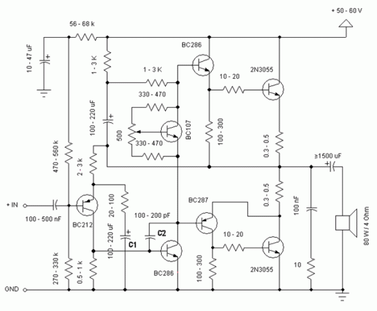

If you don't like AX6, this is pretty simple from bilb. It is quasi comp, no TIP32 needed. replace the 2n3055 with TIP31, turn rail voltage down to 20-24. Your pn2222 and pn3904 are suitable for that voltage, not a lot more. If the TIP31 don't have a C suffix, limit them to under 40 v rail, too. The transistor with the adjustment pot, that is mounted on the output heat sink to decrease bias current when the outputs heat up. Use insulators and heat sink compound on the output transistors and that one. As you see in my AX6 post, I use heat sinks on the drivers and VAS transistor too. Cut & drilled out of scrap window frame, they are free.
You'll notice I'm posting single supply amps schematics for newbies. that is because if one solder joint pops, a split supply amp, however good sounding, can toast your speaker with DC. That 1500 uf or 4700 uf capacitor between the amp & speaker is the greatest $3 protection device made.
With a bit of insulating board and some wire, you could build this in a couple of evenings. I use a yankee hand crank drill & #46 bit to drill the holes, and a #28 the holes for the #6 mounting screws.

One question on the cheap quasi with TIP31's, which of the transistors (e.g. Q5?) can I actually use TO-92 case transistors for? I have to build between 2 and 4 stereo pairs if I want to have an amp per driver, so I want to make sure I distribute my power transistors well.
Use TIP31 for the VAS, the second transistor bc286 in bilbo of sydney's design. I use a salvage heat sink, many don't. The input can be pn2222 or pn3904. The heat sensor transistor can be TO92 if you use enough heat sink goop and clamp it to the heat sink with a tie wrap. Metal can 2n2222 were used a lot in the early seventies for heat sensor transistors (Vbe multiplier they call it).
Everybody uses a PNP lower driver. If you've got some old TO5 can PNPs like 2n3906, or metal can TO39, you could put heat sinks on those, one dynaco PC15 is still working with TO5. Else just keep the rail voltage and volume low and use TO92 everything but the outputs.

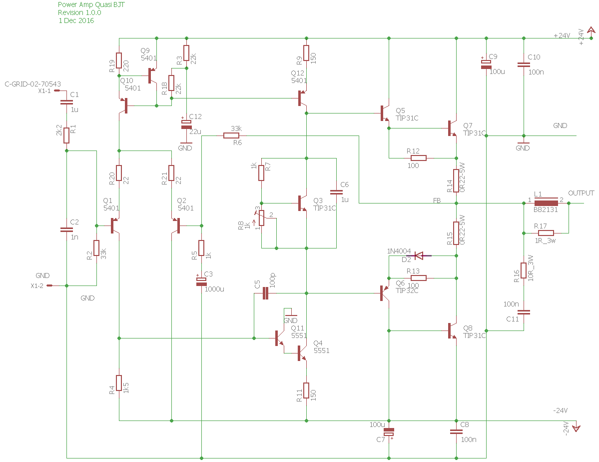

I used the TIP31s to excess simply because you wanted to use them up. You can use smaller transistors for everything but the outputs, and I show an example below. Most currents are in the 1-20ma range and voltage is not much of an issue with +-24v, although you can't use 2N3904s full swing, just in the front end. Dissipation is an issue, so TO92s are a little weak for the predrivers, though I have seen people parallel them as I'll show. For convenience, I like a screwmount transistor for the bias generator. You can use a TO92 part there but it needs to be clamped to the same heatsink as the outputs. You can use your 40v 2N3906s for the front end, but since the power supply is 48v we need higher voltage parts elsewhere. I show 2N5401/5551s but any transistor rated 60 Vceo is OK.
As an illustration, I post the attached schematic. I would not recommend this for new design, but for using scrounged parts it should be fine. This is a paper design, not simulated nor built, so beware.
