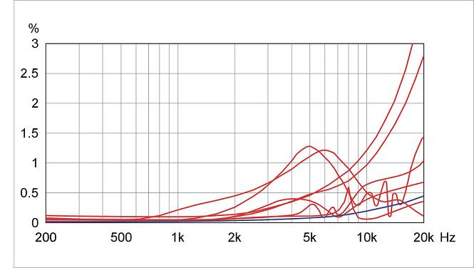

Here's some of the material from Sennheiser. The blue is one of their MKH mic's with symetrical capsules. Most mic's have non symetrical capsules which gives more even order distortion and also more IMD. By making the capsule more symetric the distortion is decreased.
Leaving Sennheisers claims aside, what's interesting here is that we can see the increased distortion for all mic's towards higher frequencies.
/Peter
/Peter
