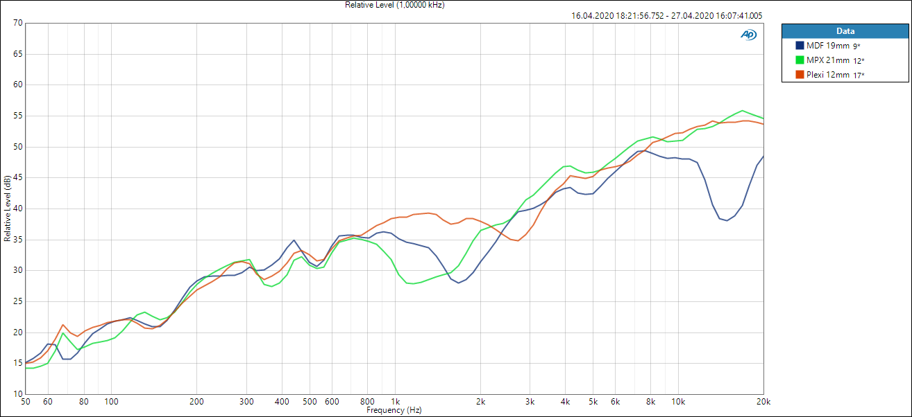

But you could do some measurements to know where wood has it's problem frequencies. And some measurements of the cabinet itself to see if you actually have resonances in the passband of the woofer. Or play some sines in the passband and listen/measure if there are hearable noises from your cabinet.
Then you could show us about it :geek:
A woofer housing needs to be STIFF. Get those resonances out of the passband. You can do that with wood perfectly.
When you need it heavier (e.g. decoupling with sylomer pads) put some concrete/stone slabs on it.
(Coincidence frequency of standard wood panels is way out of the range of woofers. So there is no specific material weekness of wood in that area. Brace it as much as you can. And when you want to improve the knock test - use 40-50mm woodpanels)

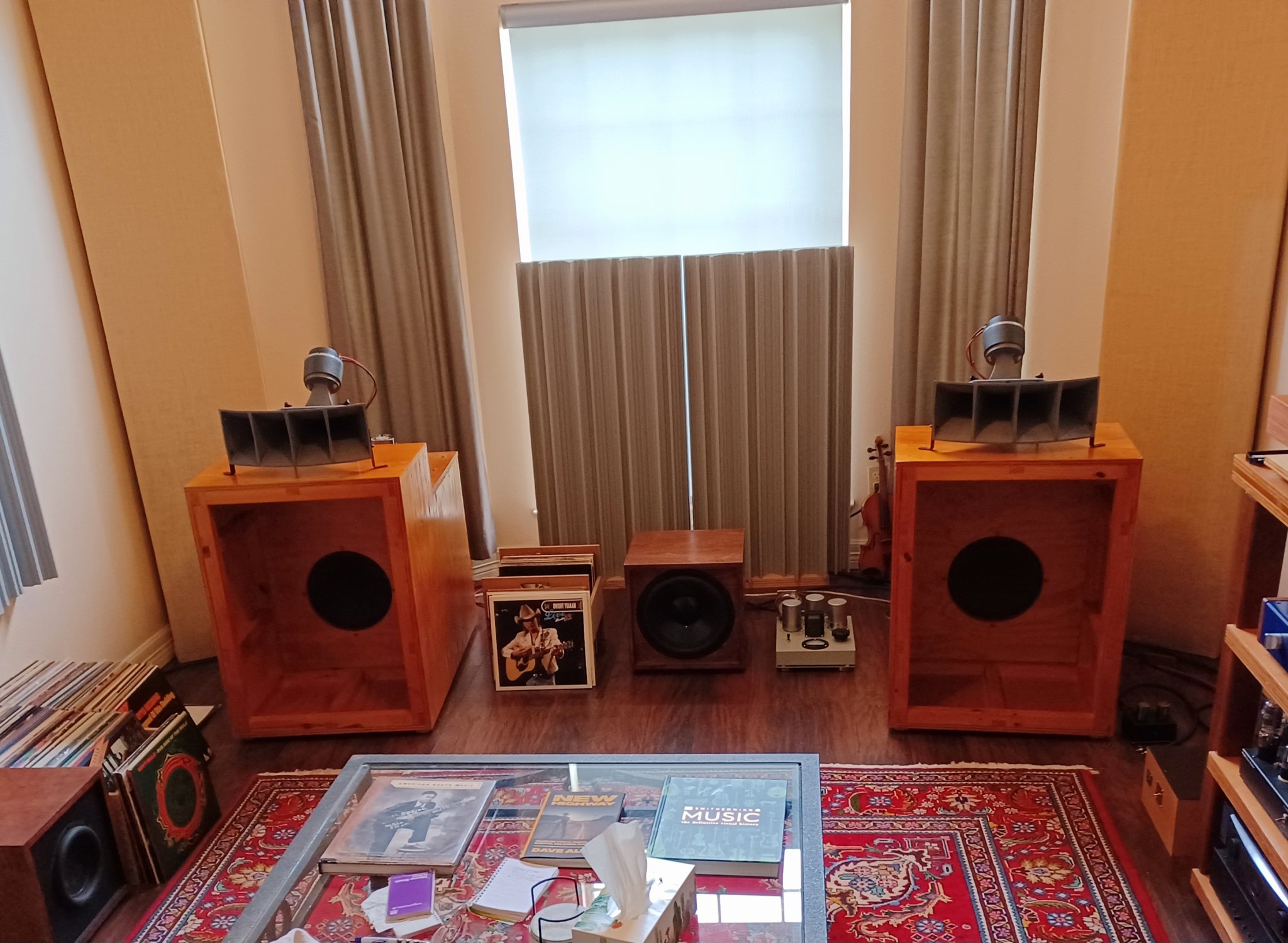

I'm using a different method of multiple sub integration that isn't supported in available tools, atleast none that I have found. I think it is great, but it seems I'm the only one doing it. So I'm treating it like a research project. Being able to test in multiple rooms would shw that it "actually" works. Testing in only one room only really means that it works in this room...and nobody will believe it because of their preconceived ideas. I'd like to demonstrate it at a speaker competition, but there is work to be done before I do that!
One of the issues in general, in more recent home decor trends, is the move away from wall to wall carpeting and large window curtains, both of which help to make a room less "bright". It's hard to compensate without special acoustic treatments and that may run counter to the "WAF".
