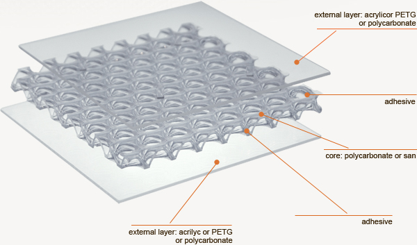

How about using something like this to build a loudspeaker ?
With some luck i may be able to get this material surplus.
Even if it's only "okay" i think it would be a lovely material
to make something that looks totally different from the average
wooden enclosure.
A video demonstrating how strong the stuff is:
Bencore :: Prodotti per Design di interni
