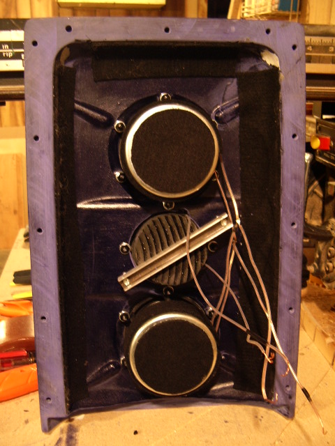

I just finished building bass bins for my actively bi-amped setup. The panels are two layers of ply glued and nailed together: the inner is 3/4" crappy CDX grade, full of knots and voids. I filled some of the voids by inserting small pieces of thin wood coated with glue. The outer layer is better 1/2" ply. Walls are damped with 1/2" wool felt. The bottoms are filled with 2" of very rough finish concrete. The top panels, which support the mid/tweeter enclosures, are attached only with a layer of silicone caulk. The baffles are two layers of 3/4" ply, glued together.
I'm sure there are resonances, but I don't hear them. Bass is incredibly tight. Here is a pic of one bin, early in construction.

That enclosure does look impressively solid. Am I seeing 6 panels + baffle there?
I should have been more clear. The panel adds mass, while the void in a panel of ply decreases stiffness. Although, I must admit that I don't believe small voids really decrease stiffness all that much. I'm not sure BB ply is all it's cracked-up to be. No apologies for the pun.
As I wrote in the previous post, I think voids may actually serve to break panels randomly into smaller sections. I am more concerned about loose bits inside voids rattling around. That's why I stuffed most of them with glue-coated sticks, pushed or pounded in as far as they would go, usually all the way through. Most voids are pretty straight, and the thickness of a single ply.
I should also take better pictures, and more of them. Yes, it's six sides plus the baffle. Only the top and bottom are parallel, and the bottom is covered with 2" of rough-finished concrete, sloped from thin at the front to thick at the back so even those aren't really parallel. The inside of the top is covered with Deflex material. Four of the six panels are quite narrow (4-6" wide), while the biggest two are about 10" wide, still small by bass bin standards. Mating edges of ply are mitered, with matching angle solid wood ribs glued and screwed into each joint. This is NOT a beginner's woodworking project.

In order to achieve a unique profile that would have been difficult to execute with wood, my latest project employs molded polyurethane for the baffle of the mid/tweet enclosures, and that seems to have worked out pretty well.

Ive considered doing something like this using casting polyester resin, the idea of making a near perfect mould seems a little daunting to me. nice work!
