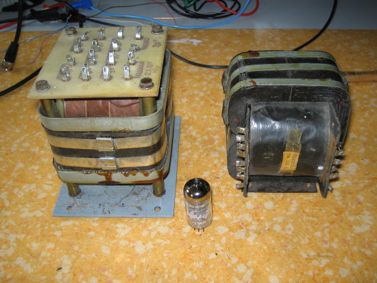

In addition I've got two unknown salvaged "double C" transformers, one for power(unfortunately low voltage, see attached picture at the left) they is an ECC83 in the middle for size comparison, and one for output, that are not yet tested (the right side is OT PPUL).
Is there something special relative to doubleC to keep in mind during measurements estimating them ?

One other minor item: you can peel away some of the inside layers of a c-core if you need more bobbin space or build up the bobbin and find that it has become too large. Just start at the flat surface with an exaco or other sharp knife, and peel away a few layers at a time. I also use needle nose pliers to sort of wind up the unwanted layers, after I get them started.

one additional item: a lot of cut-core transformers were used in ferroresonant power supplies and magnetic amplifier units. they may be gapped and are useless for anything except using the core as a part for something else. Its harder to get tight coupling with cut cores compared to a transformer stack of lams. the surfaces have to be matched, with no nicks, and no foreign material, etc. They are better suited to applications where a gap is intentional. So, when you salvage a pair of cut cores, be sure to mark them so they stay matched and together.
