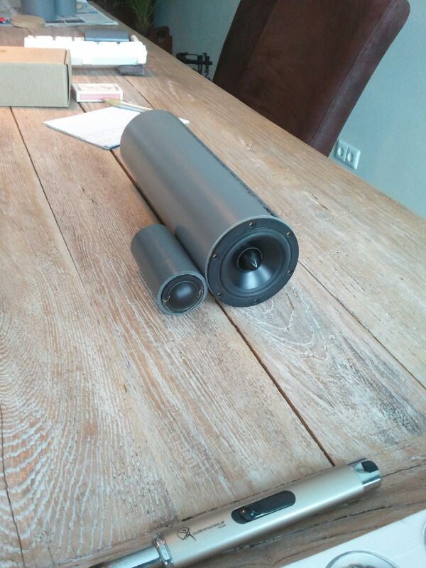

Those look nice. Ikea bowls? I'd like to see measurements but I'm not sure what to do or look for to find diffraction. Off axis, maybe?I recently finished my speaker set with 10F/8424 in minimum diffraction sphere. 20cm diameter, around 2l sealed filled with wool.

I recently finished my speaker set with 10F/8424 in minimum diffraction sphere. 20cm diameter, around 2l sealed filled with wool. My measuring space is limited but I'll try to measure them if anyone is interested. Which measurements would be preferred?

It was your project that triggeredmy comment earlier.

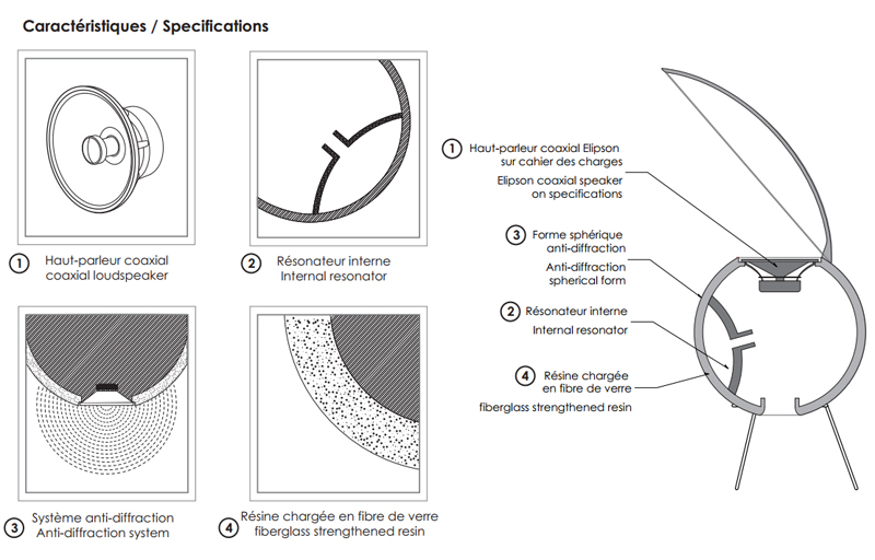

... Seems that it would only require some 'objects' inside the cavity to break up the internal mode without fancy anti-resonators.

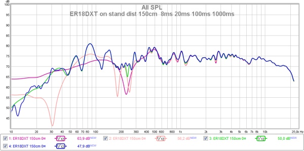

Here a floor bounce at various IR gating - from same measurement
