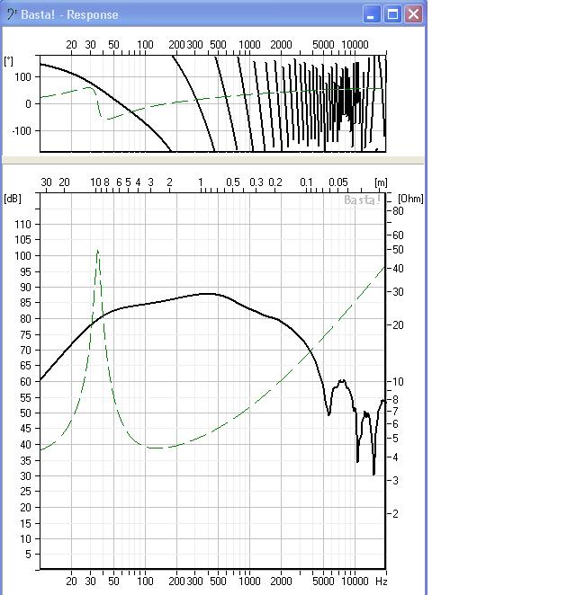

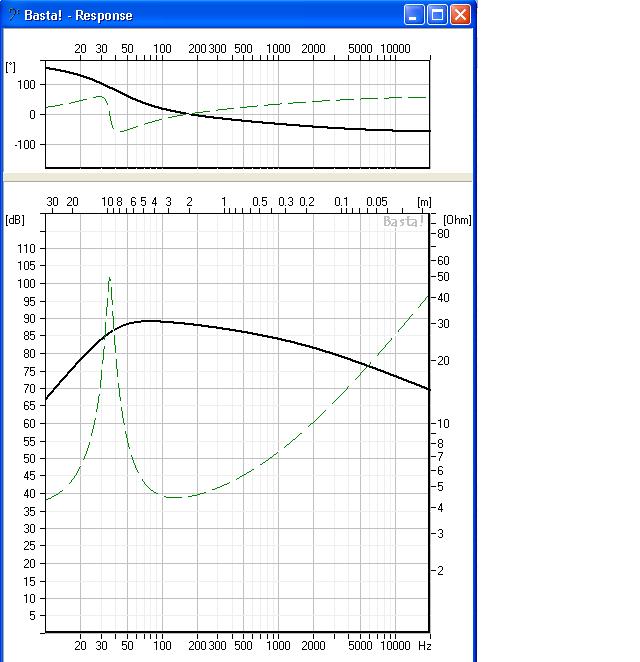

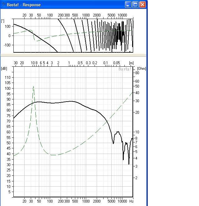

The first is the response as shown in Basta! (what a great software package!) The sealed box is 76 liter with 50% Viso, box in the wall (no diffraction). The second is with diffraction and a baffle of .65 m tall by .4 m wide. Mic distance of 1 m from driver, box in free space.
