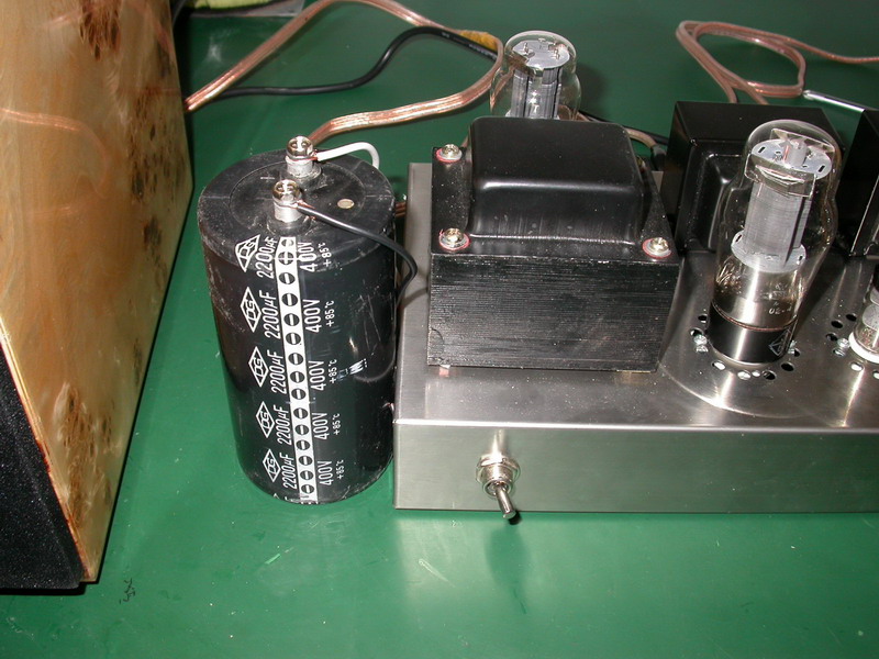

I tried the large cap on my little amp this morning, just connected it in parallel with the 330uf. All I can say is awesome. I don't have golden ears to distinguish the difference between silver cable and copper cable, but I'm pretty sure all hum was blown away to mars. The bass was obvious strengthened.

A friend works in a equipment company sent me a huge box full of huge capacitors. It weight more than 70kg, 200 pcs 2200uf/400V capacitors in it.
Rail gun?
Rail gun?
You need a lot more capacitance for that !!
More like 2500 units with at least a 200-350V charge and some huge *** bus bars XD
A friend works in a equipment company sent me a huge box full of huge capacitors. It weight more than 70kg, 200 pcs 2200uf/400V capacitors in it. It's almost as big as a cola bottle.
I have no reason not to take this huge free gift. I think these caps may be used for tube amplifiers, but for most of the tube amplifiers I have seen a 470uF for power supply is enough. How can I make use of these huge capacitors?
it's not for sale, do not expect to see in the store.
One 2200 uF / 400V cap would be nice to power B+ of my Gubernator (parallel 4P1L SE) amp. I used a couple of 4,700/200V in series, it sounds like battery powered. Dead rock quiet.
I guess the diode will burn when power on with this cap?
I have 20 Ohm wirewound in series with primary that relay shunts when sees rectified voltage for filaments. Since all secondaries of the power transformer are feed from the same primary, voltages on all rectifiers go up proportionally to each other, so it is enough to sense one of them to know that all caps are charged. Why I sense voltage on filament rectifier, because if the amp is switched off filaments still draw current discharging filter capacitors.

Hi All,
It depends on the type of diodes you are employ. Today there are loads of different types of diodes on the market which able to handle thousands of amps for a microsecond. And on the other hand the inrushing current will be limited by sum of all series resistances. Rmains, Rprim, Rsec and ESR of the cap.
In my MC-3500 clone I use 8x 470µF/400V in 2 groups of 2 parallel , 2 in series giving a total capacitance of 940µF /800V.
The inrushing current in the mains (230V) is abt. 100A for 0,1 sec , which trip the 16A CB on the mains panel .After I replaced the CB against one with the C caracteristic the CB stay on. The former CB had curve B and trip at abt 5 times inrushing current.
The bridge rectifier ist an 800V 5A version with can withstand abt. 250A for 0,1A sec. I have no current limiting components inside , except the natural given resistances.
So if I had such capacitors like the one siliconray got, I would use them I in my Amp. But now that my amps are finished, I wouldn´t change my circuit design anymore , because it works to my perfect satisfaction.
