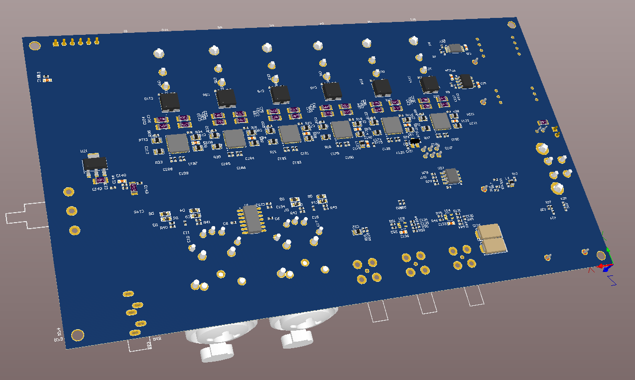

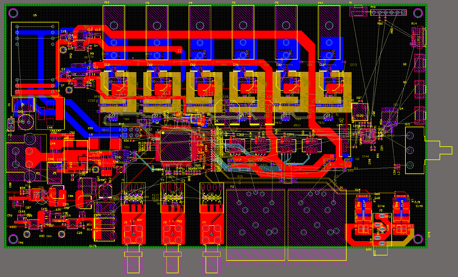

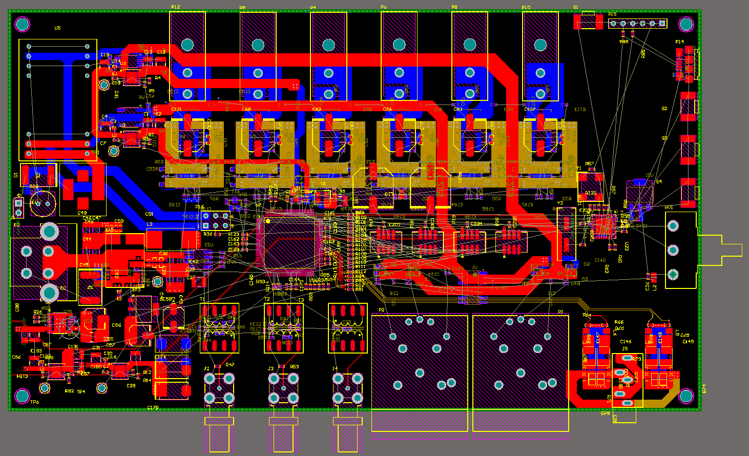

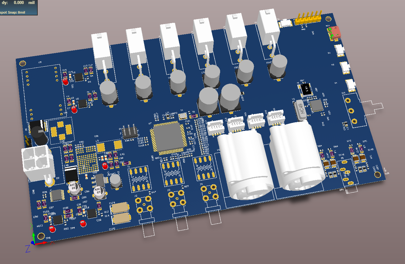

Progress update.
I know that it's difficult to estimate costs and all that so not going to ask about that, but are you considering selling kits or ... ?
Depends on the interest really.
So far...
8-60V input supply
D2Audio DAE-6 DSP
6x SSM3582 in mono mode - 24/96 TDM.
XLR input / THAT1280
2 x isolated SDPIF in (micro bnc)
1 x isolated SPDIF out (micro bnc)
1 x stereo headphone out (filtered PWM from dsp - might add op-amp here)
12 x PWM out header
1 x PIC32MX (with attempt at n-channel i2s connection into DSP).
1 x 6-ch i2s/HDA/DSD I/O header.
Volume control knob and some buttons.
Still need to move things around. The BNC/XLR can come south a bit so the panel mounts are in the right place. Next is a little beautifcation of layout.
