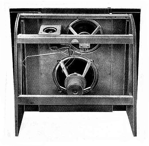

I've found the overall dimensions but I want to know the exact location of the 10" and 12" drivers and hopefully someone who has one of these open baffles will be so kind to measure it up and post it here.
Thank you in advance! AM

There is a piccy of the rear of the SFB in post 42, if memory serves me well. but here it is again. the dimensions of the SFB are 34"W by 31"H by 12"D. Also, the 12" and 10" units are wired in parallel, probably 15 ohms each and without a high pass filter on the 10" to limit the lows. This may have been safe in the days when 20 watts was a lot but with todays arc welder amplifiers, I'd limit the lows to above 70hz (first order) or 50hz (second order). The Super 3 tweeter is high pass filtered with a 2.2uF cap, (PIO) paper in oil but any decent 50 volt NP cap will work and P-E has plenty. Of course, if you're using modern drivers, they can handle a lot more power than the old Wharfies.

This is what I arrived at. Baffle is narrow since the W15 is in a U-Baffle and cuts out around
250HZ. W12 is full range as in the original SFB3. W10 is trimmed a bit at the top end.
Super3 has a 2uf cap. The W15 gives excellent tight bass and I suspect better than the original design. In addition I biamped theses drivers (W15) so they can be attenuated with the chip amp. All other drivers driven with a 5w SE Ampex Tube Amp. Some of these videos have different xover components. IE: 2mh coil on W12. This website is a huge inspiration. Can’t thank Robert enough.
