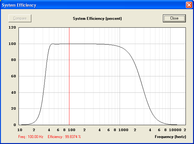

...the ability to approach 100%...
...as demonstrated in the attached example simulation.

As for the simulation shown by Mr David McBean, I would like to see the design portion of that efficiency sim, to see if I could build it!

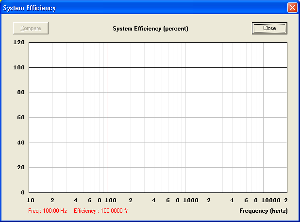

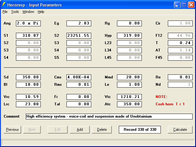

Hi 1audiohack,
Hornresp input parameter details attached as requested.
Building the horn itself shouldn't be too difficult, but finding the specified driver may prove to be bit more of a challenge. The voice-coil and diaphragm suspension are both made from Unobtainium. As you can see, the values of Re and Rms are rather small...
I have also attached a chart showing the efficiency of a system using high-grade enriched Unobtainium rather than just the standard grade. For the enhanced system, the values for Re and Rms both become zero, resulting in 100% efficiency at all frequencies .
Kind regards,
David
That would be an interesting DIY....So as long as we super-cool the voice coil we should have no problem...

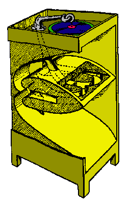

Your mention of Victrolas reminds me of where I have seen the Western Electric curved horn before (the big one that started the thread). It looks somewhat like the horn that Victor (RCA Victor) used in their high end Orthophonic Victrolas. These came out in 1925 and were to be used with the new electrically recorded 78's. Sound quality was said to be a big step up. I've heard one and they are much better (and louder) than the morning glory horns on the old Victrolas. WE was involved in the design of the electrical recording sstem for all this so maybe there was a connection on the playback side?
