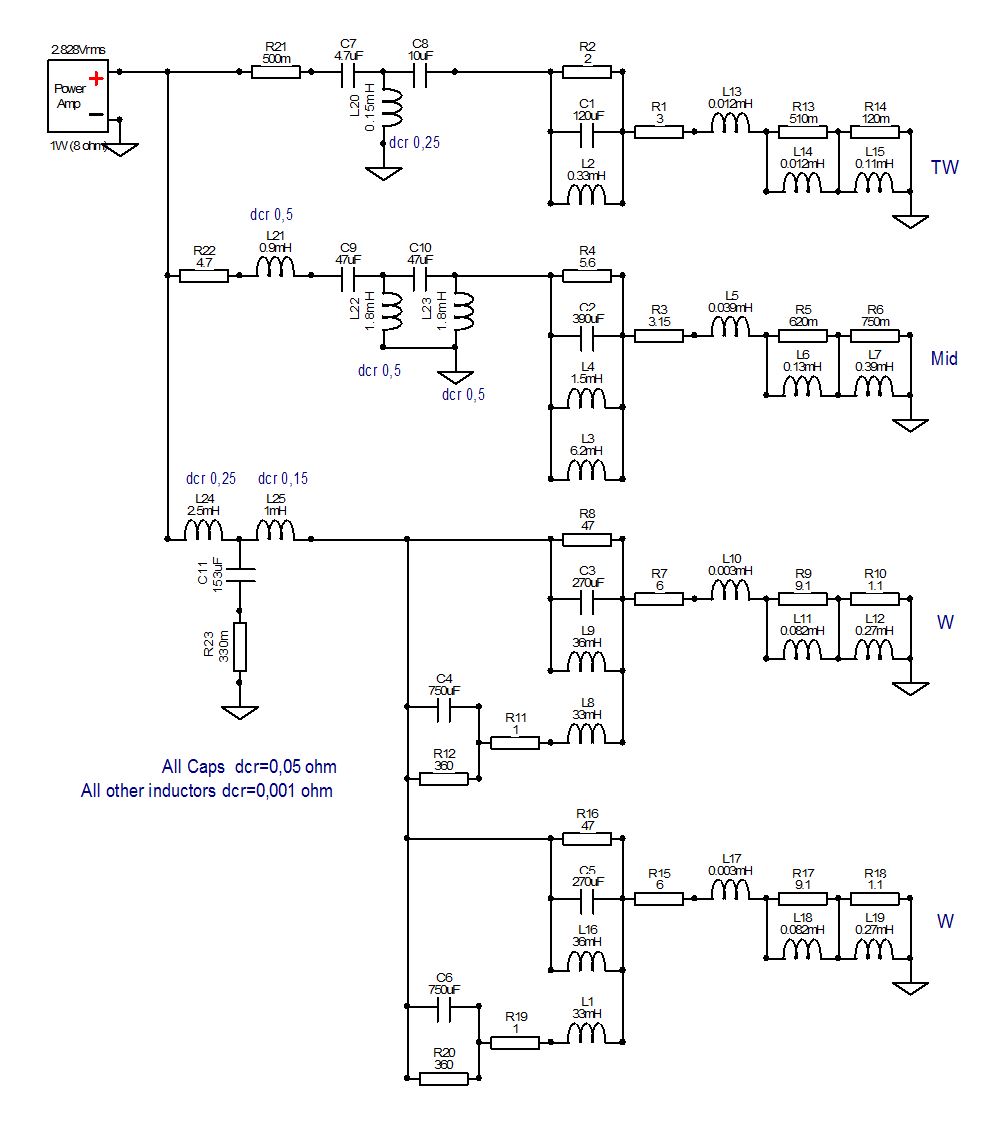

I was trying to make a load that was something like my B&W.
Your model has zobel (low impedance at HF) but I cant see it in the crossover?

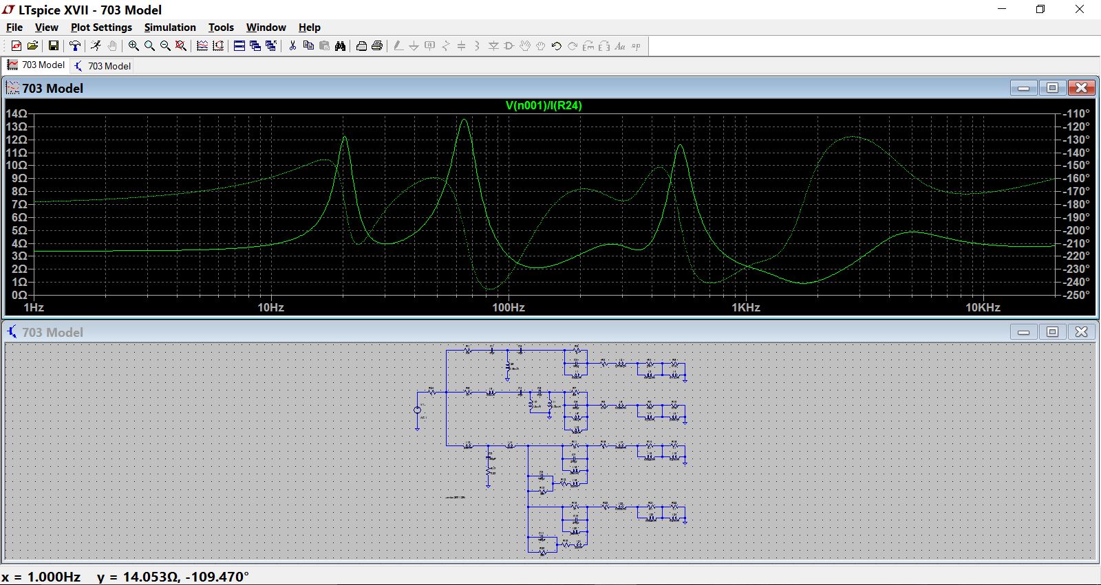

Simulated B&W 703 system impedance
Found B&W data on Göran's Audio Excite web for the tweeter and woofer which I adopted almost completely except for woofer Re and Le. The FST midrange was traced from Zaph Audio measurements. After that I have been adjusting values in XSim until I thought it matched well enough to the traced plots.

Using Lojzek's brilliant diagram for my 703's I have created a subcircuit that can be called up.

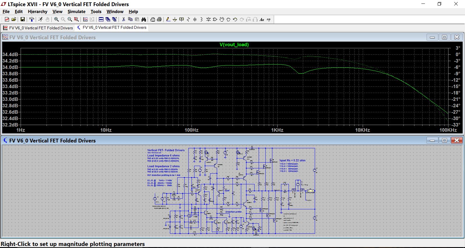

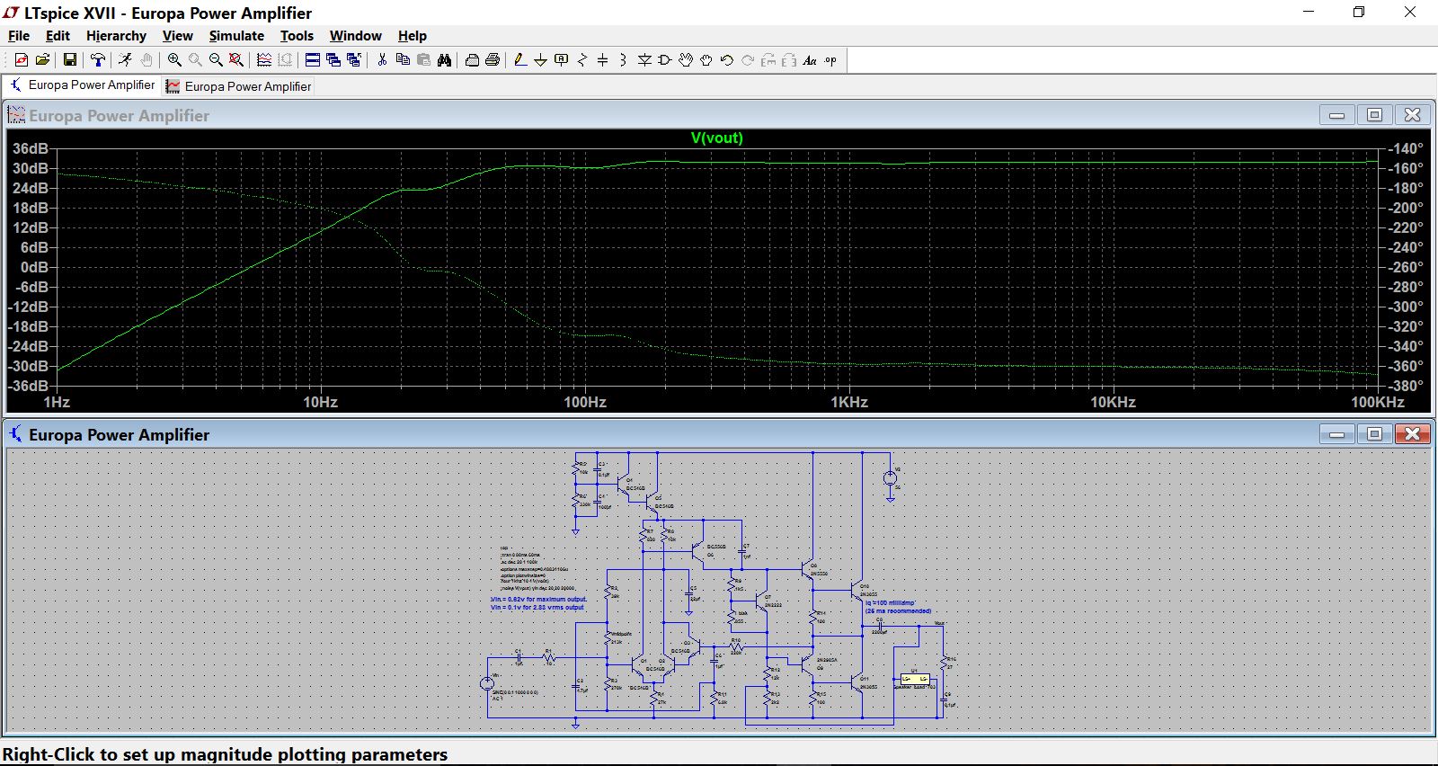

The results on the JLH are interesting and the varying impedance of the load certainly upsets the response. The Europa looks amazingly good considering. Go figure that one out . The FET amp... well look at the scale before judging.
All interesting stuff. I must try my relatively simple lateral FET design in all of this at some point.

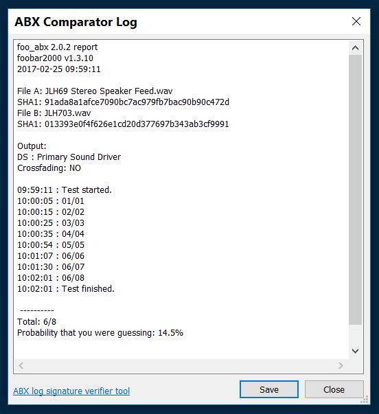

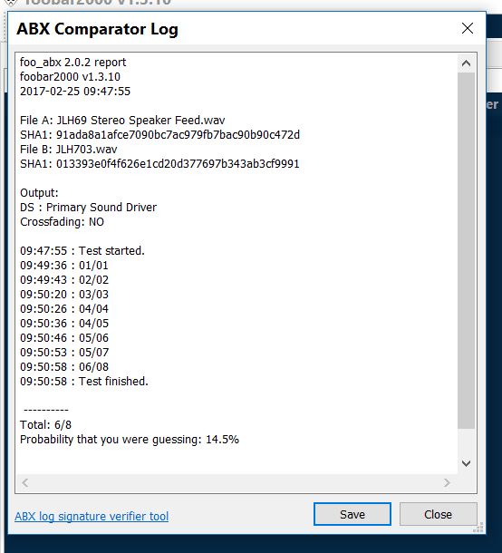

I was curious to try this simulated load and so I picked the JLH as guinea pig
Three Foobar results all came out the same, maybe I was losing focus at the same point lol When you flip between the two versions there does seem to be a difference but its subtle. In some ways the tough load seems to give a more expansive sound stage, better left/right separation perhaps, which is plausible if you imagine the load distorting the different info in the left/right channels. I also felt the dynamics were softer with the tough load, and at one part where the vocal comes in (this bit)
It was almost as if there were a limiter in place (like the old auto level control on cassette decks). Very subtle but there non the less.
This is the tough load file (Dropbox) and the original 8 ohm test.
Tough Load Test
