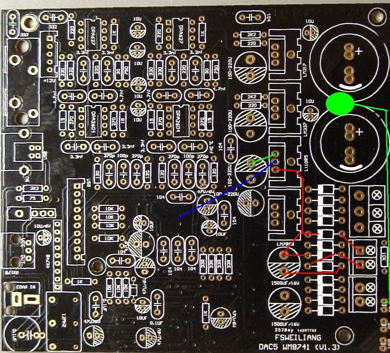

These are the continuity paths for the LT1085 reg as I can decipher them. I swapped the two 100-220 caps thinking one might be defective but got the same readings. This is a replacement 1085 I had on hand and thought it was new but I'm ready to order a new one.
Is there anything in these photos that would affect the output of the regulator? It is still reading 13.3 in - GND - 0.0 out.

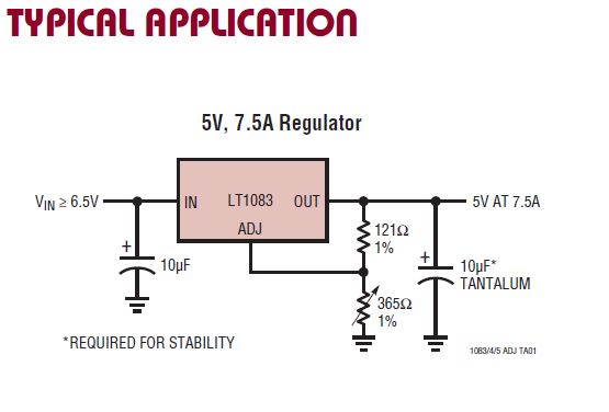

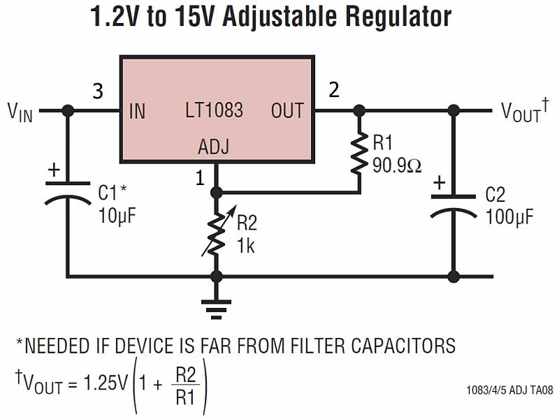

Bob,

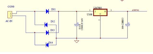

It looks as if the LT1085 is being used as shown in this circuit from the datasheet, where R2 is set to 0 ohms. In that case, the given formula says the output should be 1.25V. You're not far off with 1.46 V. Note that I got the pinout confused. The WM8741 needs 5 V, not 1.46 V, so I wonder if LT1085 is the right part. Although my board uses an LM7805 in that position, the LM7805 has a different pinout, so it is not a direct substitute. I wonder if there are any 5 V, 3-terminal regulators with a pinout such that pin 1 is Gnd, pin 2 is Vout, and pin 3 is Vin. It seems that such an IC would be the right part. I would personally be tempted to fit an LM7805 but bend the pins around to match the board.

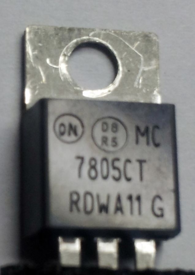

I thought about substituting a LM7805 but it looks like this may be one of those version differences. The print mask clearly has the LT stamp, so it would appear the designer used it intentionally. I'm open to trying the swap if you still think it is necessary.

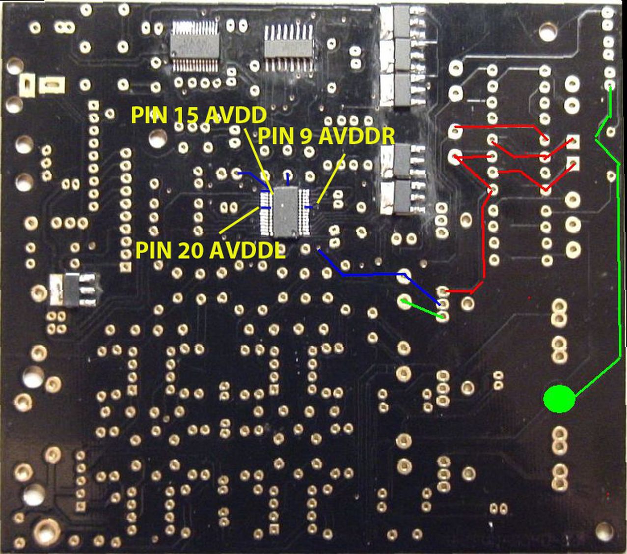

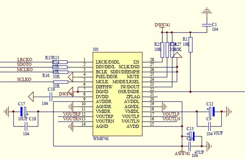

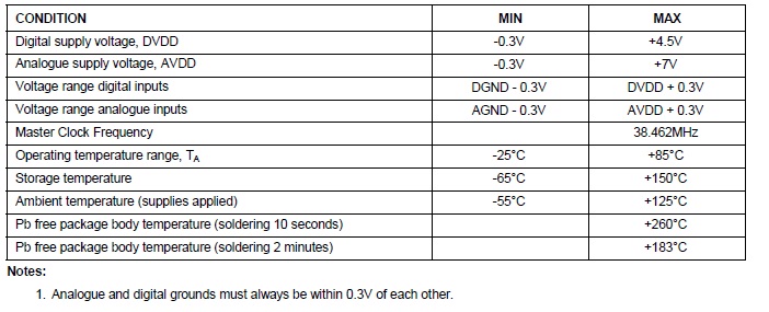

Also all the AVDDX pins show a range for voltage. Are there any other pins on the WM41 where 5V might show up? Don't want to be probing where I shouldn't be.:eek:

These boards only have one way to change filters, and it changes the oversampling rate, too. There's a DIP switch that sets pin 22 on the WM8741 either high or low. I think you should be able to cut traces and add your own DIP switches to use hardware selection of the filter.

Those are the absolute maximum ratings you show from the WM8741 datasheet. Look on the next page, and you will see the recommended operating conditions and test conditions, which both show 5V as the normal analog supply voltage. I don't think there are any other pins on the IC that should read 5V--just the ones you traced out on your own board.
It is possible that your board is somehow defective being that pin 1 of the LT1085 is grounded on your board. Is there any evidence of that? Are there any resistors connected to pin 1, that should be there for normal operation?

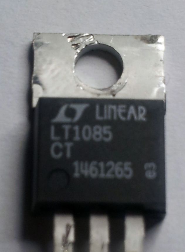

those with label ending with CT are adjustable version.
The fixed voltage label ends with LT1085CT-5 for 5V. You need it in TO220 package.
LT1085CT-5 Linear Technology | LT1085CT-5-ND | DigiKey
LT1085/1086 have better specs than the common 7805. Not sure the difference will be audible though :rolleyes:
BTW, given the low current needed, LT1086CT-5 should be sufficient in this application. LT1085 is the high current version, up to 3A. I wonder why Weiliang picked this one ! As the price is similar, it does not make a difference anyway.

Got good results with the new reg but still not there yet. Audio is being produced on both channels - Hooraaayy !! :D
However the quality is very poor. There is a static mask plus distortion the makes the signal unusable.
