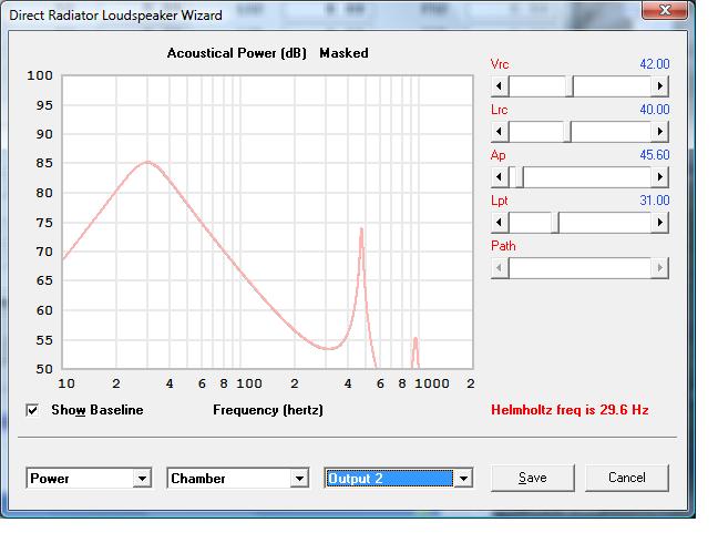

Box and port were calculated in WinISD software. Port is tuned for 30hz in 42 litres enclosure (7.5 cm (3in) diameter, cca 31c (12in) length - flared)

Box and port : 42 litres enclosure (7.5 cm (3in) diameter, cca 31c (12in) length - flared)

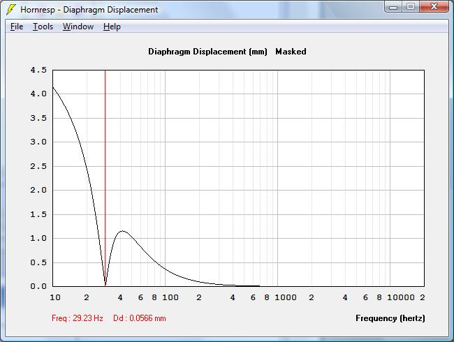

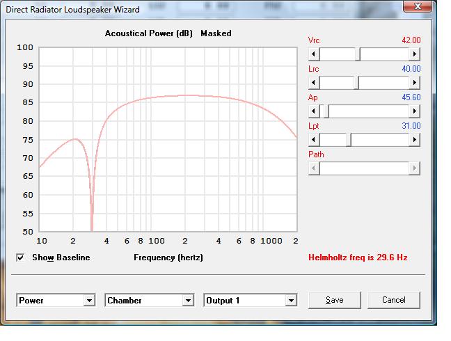

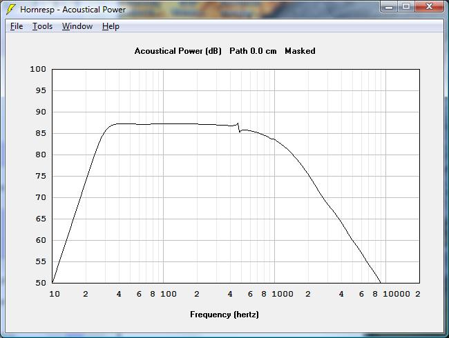

A quick run on HornResp to check your design tuning (pic#1 and graph#1) and it looks fine. However it does not include bafflestep effects.
To check your LF tuning / construction use a s/w freq generator (like in REW) to look at the woofer movement (graph#3) at the box tuning freq (30Hz) the woofer will barely move. It's a very rough indicator of leaks and construction issues. Measurements are much, much better if you can provide it. I should add that a 12" port tube makes your box deep, or possibly limiting the space behind the tube to operate properly.

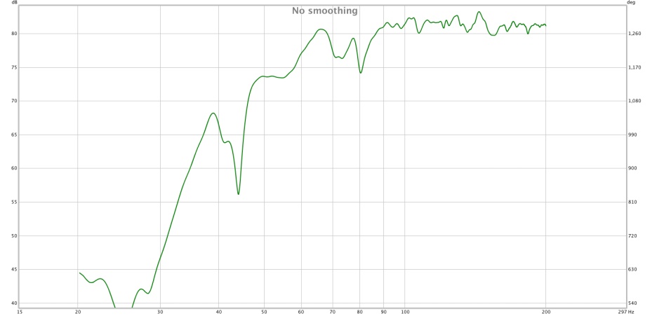

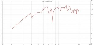

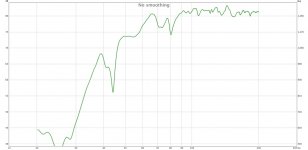

I have measured response of the drivers and following are the results.
Response of the speaker port (20-200hz) measured from 10cm
Response of the speaker woofer (20-200hz) measured from 10cm

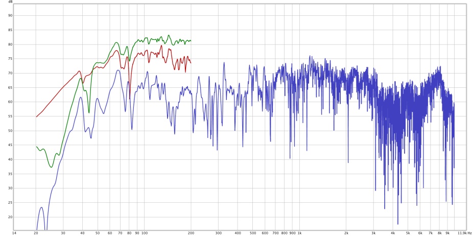

I am much happier with the performance, however I think something is still not 100% OK. Probably it is the port. Although WinISD suggest 30cm depth, it is installed 30cm with one flared end. Effective length is thus probably slightly lower.
I have noticed that the subjective bass intensity was much higher on the sides of the speaker than in front of it. When I was in the hallway 4 meters left to the speaker (which was perpendicularly positioned to me) I have felt ground trembling under my feet. Could this be because of front positioned port?

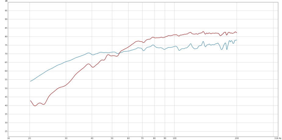

It should not matter if the port is in the front. It does look like the tuning is higher than predicted. In your graph#2 the dip is around 45Hz and it should be around 30Hz (see graph below). I've attached a HornResp sim for the driver output. You will get a better graph of just the driver if you measure closer (4cm).
The box tuning may be higher due to a smaller volume (its <42L) or the midrange is not entirely separated and is acting like a passive radiator, or the port tube is restricted. How much distance from the rear tube to the rear cabinet wall?
If you measure with the box against the wall or on the floor you will get more bass. It's better to have it on a stand, away from a wall (1m) for more accurate measurements. You may also want to apply an IR window (-20,40ms) and smoothing (1/12 octave) to your graph to make it less noisy,.. everyone has their favourite settings.

Thanks for advice,
Box itself is 42,8l, however port itself as well as woofer should account for 1-2 litres volume substraction. I have made new measurements with speaker standing on 50cm stand and cca 80cm from the wall.
Blue is the response of the port and red is response of the woofer. As you can see. SPL is -10db in the range 35-55 db.
That does not look right. You should see a port peak at 30hz and a driver dip at 30Hz. It looks like the box is leaking. I added the port output below, and the driver output was in previous post.
Try to open the IR window (left 50, right 100) and enable FDW=6. The window may be too small.

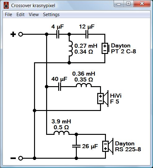

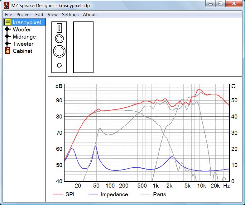

I wouldn't worry about the bass as long as mid and tweeter levels are too high.
Attached is a simulation of your current setup. Due to baffle step the woofer only reaches a sensitivity of 84 dB.
Beside the level issue, I also think that the first order crossover in the midrange section doesn't work satisfactorily.

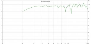

If you want to measure port and woofer bass output, you should place the mic very near, some half cm from the membrane. Only in this case you won't catch the unwanted box reflections effect.
If your box works as intended your measured curves should look like here (green and blue curves on the fig 4): Monitor Audio Silver 300 loudspeaker Measurements | Stereophile.com

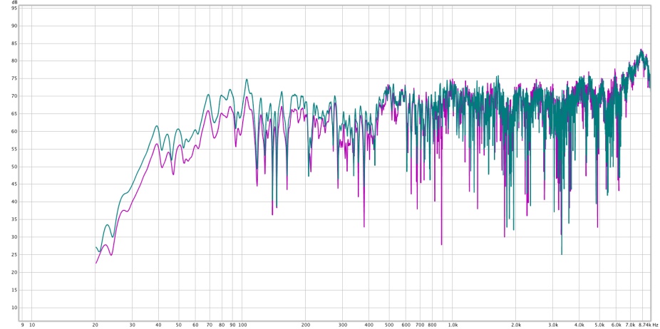

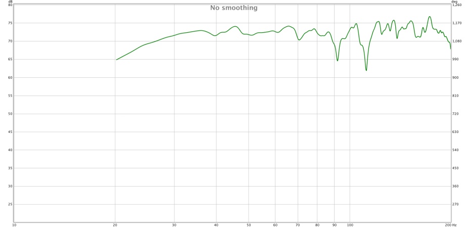

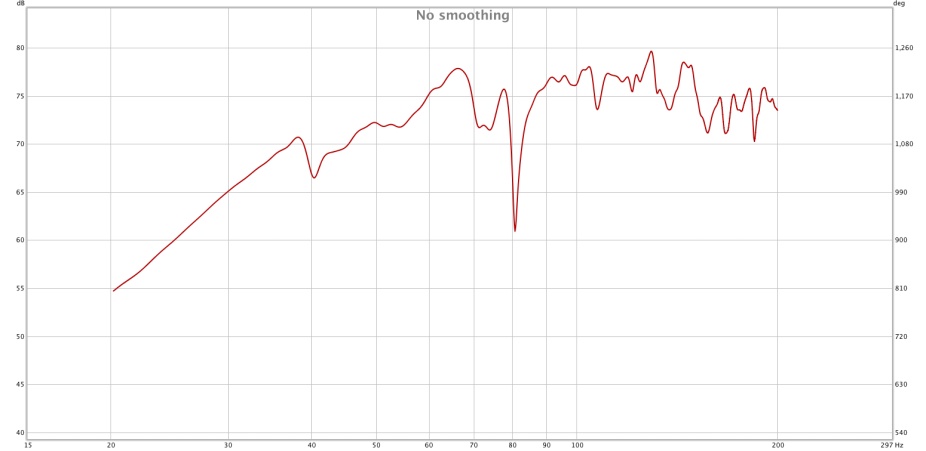

It took me a while but I have adjusted the speaker port, added knee bend and made it slightly longer.
After subjective hearing test , one must note that the bass situation has improved. When i added +4-5 db on my preamp, it has started to sound just right.
Measurement confirmed that the speaker port is now performing as it should have, started fully kicking in at 30hz frequency.

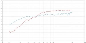

What is however still puzzling me, is why the system response without adding 4-5 db on pre-amp so weak untill approx 60db.
Attached are measurements of the port (2cm distance) and system measurement with and without 4-5db adjustment on pre-amp (1m distance) in room conditions.
Can anyone please adwise where could be some hidden error? I was guessing whether this could be caused by slightly lower port diameter (approx 2-3mm) compared to original port, or by adding a knee on the port.
