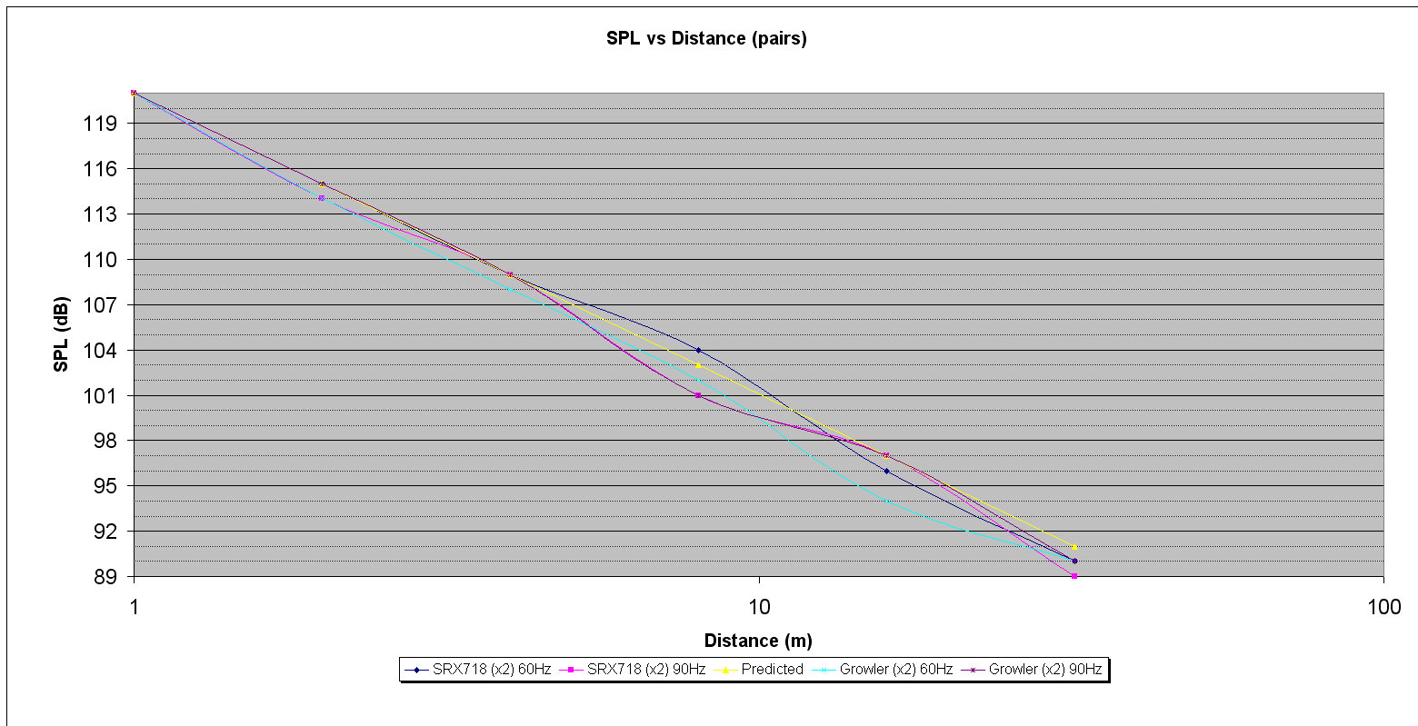

I think it's helpful to look at graphs rather than raw numbers to see what's really going on and whether the measurements deviate or not, so I took the liberty of putting your measurements into an excel spreadsheet and graphing them, which I've attached as two images.
The yellow line is the predicted theoretical inverse square law fall off. The first graph has a linear distance axis while the second has a logarithmic distance axis, which is convenient because it makes inverse square law fall off a straight line, making it easier to see how the measurements deviate from the predicted response.
There is a huge periodic wiggle in the readings between 2 and 8 metres, presumably from a building reflection. The magnitude of the deviations is far greater than the small difference we're trying to measure which is probably only on the order of 2dB or so. Even at 32 metres the slope of the lines have not converged at the correct inverse square law fall off on 3 of the 4 measurements.
The fact that the horn at 125Hz follows most closely with the predicted response suggests that the directivity of the horn at that frequency is reducing the magnitude of some off axis reflection.
The inescapable conclusion is that there is far too much experimental error in the measurements (probably reflections) to provide any meaningful confirmation or denial of the facts being argued over. I have to agree with Wayne that your measurements in this particular instance don't prove anything one way or the other.

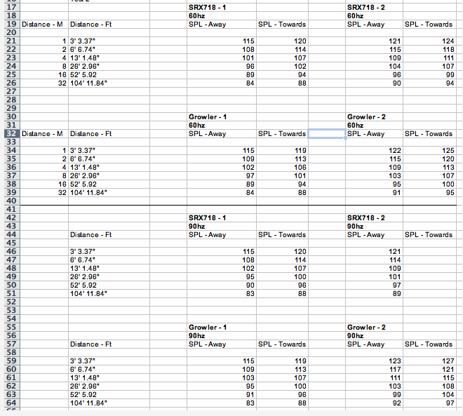

I've done an initial graph of some of the figures, and there are some discrepancies in the results, but I'm unsure about which sets of figures I should be using, and what they represent so I'll get some more details from you first.I prefer to refer to Phil’s measurements, which were done with no buildings in the vicinity.
They were performed with subs of similar radiating surface, also an important consideration, and two each of the subs, together having similar frontal area to a 12Pi.
Thank you for taking the time to review my data.
I would really appreciate your putting Phil Lewandowski’s data into the excel spreadsheet and graphing them, that would be quite informative.
In particular - the significance of the "towards" and "away" columns of measurements - I presume towards was a normal on axis measurement, while away is from the back of the cabinet ? If so I'm not sure that we need to graph the backwards facing response, as its not really relevant to this discussion ? (Too many lines on the graph just makes a big mess that's hard to interpret)
Then there is the - 1 and -2 version of each measurement - eg Growler -1, Growler -2 etc, is this just two sets of measurements of two different cabinets of each type taken one at a time, or is -1 with one cabinet by itself and -2 with two of the same cabinets stacked and both in operation ?
If so, the figures for SRX718-2 at 90Hz are missing, making any graphing of the -2 sets of figures incomplete. (In my first pass graph I graphed the "Towards", "-1" figures for both frequencies and both drivers)
At what distance were the SPL levels matched for the two different cabinet designs ? At 32 metres or 1 metre ? It appears that at least for some of the results, the levels were matched at 32 metres, but my graph shows a lot of inexplicable fluctuation in readings between 4 and 16 metres that cast doubt on the 32 metre readings.
Lastly, I'm not familiar with either of the speakers, so I've googled them to find out what they are, so just to confirm, is the first one a JBL SRX718 18" bass reflex, and the second one the JTR Growler horn ?

Simon,
You are correct, the cabinets are the JBL SRX 718 18" bass reflex, and the the JTR Growler .
Wayne has tested the JTR Growler and the JBL SRX 728, the “big brother” of the 718 in some of his Pro Sound Sub shootouts, so these tests are relevant to the discussion in many respects.
In Results - Small Horn vs. Small Direct Radiator SPL fall-off [message #551418 is a reply to message #548404 ] Thu, 27 May 2010 15:53
Phil Lewandowski wrote:
“When I went from 1 to 2 subs, I kept the drive voltage the same from the previous single sub test I just ran.
For starting at 1M, the single sub SPL 115dBC. And the starting SPL at 32M was 88 dBC.
From looking over the data very quickly, the total fall-off ranged from 30dB to 32dB. Where 30dB was the "theoretical" book value.
Interestingly, the only pure 30dB fall-offs where with 2 subs, while going towards the sub. We forgot to do the 2 SRX 718 going towards so that is why there is no data there, unfortunately.
Honestly though, I can't see anything conclusive to come to any real conclusions, from what I see. Maybe someone else will be able to point out something interesting!

Phil’s tests give a much larger data set than my flawed test, the “Away” test is the same protocol I used, set a level at 1 meter, then move the dB meter away from the front of the cabinet doubling distance up to 32 meters.
The “Towards” is basically the same test, but the level was set at 32 meters, and the dB meter towards the front of the cabinet halving the distance each test till 1 meter from the cabinet front.
The JTR Growler is “compromised” as is any horn with a mouth under a full wavelength in diameter is.
Obviously, that compromise is one accepted by any builder of portable bass horns, an 8.7 meter diameter mouth for a 40 Hz horn could not be carried on our roads.
Fortunately, horns still “work” down to a 1/4 wavelength, so a 2.2 meter diameter collection of compromised horns still provides decent 40 Hz response.
In singles, as can be seen by any of the 12Pi graphs, the 40 Hz response will be far less than at 100 Hz, as in any “compromised” FLH.

As I understand, Phil's data was gathered using a Radio Shack sound meter. It is maybe useful for course measurements but I'm not sure how useful it is for this sort of thing. The meter bounces all over the place.
In a measurement system like LMS, the fundamental is tracked with with a steep bandpass filter when doing a sweep. That greatly improves the signal-to-noise ratio because the only thing that is being sensed is the frequency of interest. But when using a sound meter, this isn't possible. So noise immunity is a problem for a SPL meter, unless sound pressure levels are high.
Ok that does clear up a few things, particularly "Away" vs "Towards", which I had completely misinterpreted.Simon,
Take Care,
Phil”
From that I've opted to graph the "Away" figures which were level matched at 1 metre, both for consistency with your measurements, as well as the fact that one of the "towards" measurements is missing. I've also only bothered with a logarithmic scale this time, as I think it's the more useful of the two scales visually.
I've used all the figures as presented with one slight adjustment - although Phil has level matched the JBL and the Growler to 115dB at 1 metre as individual units, according to his description and as is apparent in the figures, the levels have not been matched again after switching to pairs of units.
Since we're looking for any differences in fall off rate between the JBL and Growler with both starting at the same SPL at 1 metre, I've subtracted 1dB from the 60Hz Growler pair figures, and 2dB from the 90Hz Growler pair figures so that they all start at 121dB at 1m.
(As an interesting aside, I assume the fact that the 2x bass reflex cabinets only gain the expected 6dB over one cabinet, whilst the 2x horns gain 7dB and 8dB at 60Hz and 90Hz respectively is because the larger total mouth area is making the combined horn less compromised, thus raising their individual efficiency )
So what do we see ? In the first graph there does appear to be a difference in the slope of the fall off between 1 metre and 2 metres, with the JBL showing a steeper line which would suggest that the measurement position was closer to the acoustic centre. (Since the rate of increase of SPL with distance accelerates as you get closer)
I would caution though that since all the figures are rounded to the nearest 1dB and the difference at 2 metres is only 1dB, it's within the experimental error...
The other thing I notice is the wiggles in response from 2 metres onwards which in some cases amount to a 2dB p-p variation. If the measurement was done well away from any buildings this wiggle shouldn't be there, unless there was a ground reflection.
So do we know whether Phil had the microphone on the ground to eliminate the ground reflection, or was it up in the air a bit ? Because the error is +/- 1dB it could again be rounding error, or +/- 1 error from the SPL metre if it only had a 1dB minimum step size. If the SPL metre did report fractional values, it's a shame we don't have those more accurate figures to see if the wiggle is really there or whether its just a +/- 1 digit error. Their periodic wave shape does tend to make me think they are real and caused by a "floor bounce" ground reflection though, especially when the 60Hz and 90Hz peaks and dips occur at different distances.
The second graph shows similar but different fluctuations, reaching 3dB p-p in one case. None of the graphs show the correct figure at 32 metres - in most cases the difference between measured and predicted value is 2dB, with the measured figure at 32 metres always being too low.
While interesting, I'm not sure that we can conclude anything from these graphs. While there are differences between the speakers, the magnitude of the difference we're looking for is probably in the order of 2dB or so, yet we only have figures rounded to the nearest dB, along with what looks like a ground reflection.
I'd have to call it inconclusive.
I would agree with you that Art and Phil's data is inconclusive, and doesn't prove or disprove anything. But since I have a great deal of experience with measurements of this sort - and I know that 1M measurements are much further off the line-of-scale than this - I am easily able to draw a conclusion, and that is the data is flawed. It may be that the meter movement was misread, or it may be something else. But this data is off, way off.
In Phil's test, he was using a Radio Shack sound meter, which should probably only be trusted to within about 6dB. At close ranges, the acoustic center problem makes measurements ambiguous. At greater distances, the signal-to-noise makes measurements ambiguous. The meter moves all over the place, so if you stand there and look at it bouncing, you can sort of pick a value between the high and low movements of what is a pretty large window, like about 4dB to 6dB or so. Then add to that the fact that Phil already assumed he should find a constant falloff:
Here we see that Phil's expectation was that the fall-off would be constant. So when the meter is bouncing up and down 6dB, I can understand why he might pick values that met his expectation. As I said earlier, I think Art and Phil were working with a preconceived notion, and that they saw what they wanted to see.
Phil did not understand that the "theoretical" book value actually includes acoustic center ambiguity, and so each cabinet should probably be off-scale at close range. Had he known that, I am not so sure he would have picked numbers from the bouncing meter movement that appeared to maintain the inverse-square relationship when the microphone was very close.
The "theoretical" book value tells us that the inverse-square law applies several meters back, but at close distances, the measurement will appear to deceive us because we do not precisely know the acoustic centers, so we do not precisely know where to place the microphone. In some cases, it will be one meter from the face, but in most cases it will be either closer or further and in many cases it will be impossibly close, like inside the cabinet.
At close distances like one meter, the acoustic center offset isn't just a few inches off, it's often several feet. Sometimes - often - the distance error is greater than the measurement distance, which is why the numbers can be so far off.
Accurate measurements confirm this. That's why I have been so amazed at the length of this "argument". It's over ten pages now, just on acoustic center ambiguity. I have measured the same cabinets Art and Phil measured, and I've done it with a calibrated LMS system. I am telling everyone reading that the 1M measurements are nowhere close to the more distant measurements in scale. In fact, if you make a measurement with the microphone tip placed one meter from the cabinet face, the numbers are so far off you'll think the measurement system needs to go to the shop. But move back to a more appropriate distance and the numbers fall in line.
