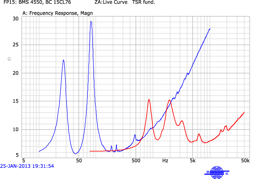

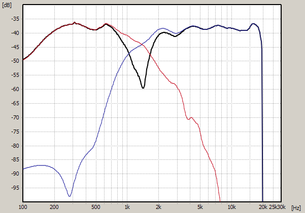

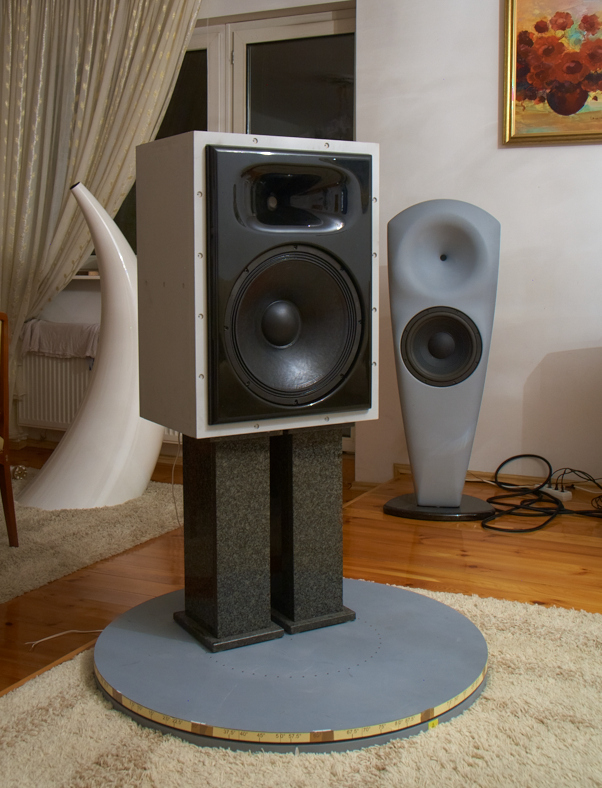

FP15 prototype ready for crossover measurements.
Drivers are: BMS 4450 and BC 15CL76. Surpringly there was little interest in SEOS-10 Front Panel so Autotech decided sell complete speaker. Probably same will be with FP15 - time will tell :)
That's because there are no measured project available to copy. The only really popular WG is SEOS12 so if you'd make Seos12-front panel, there should be much more interest (myself included :)
