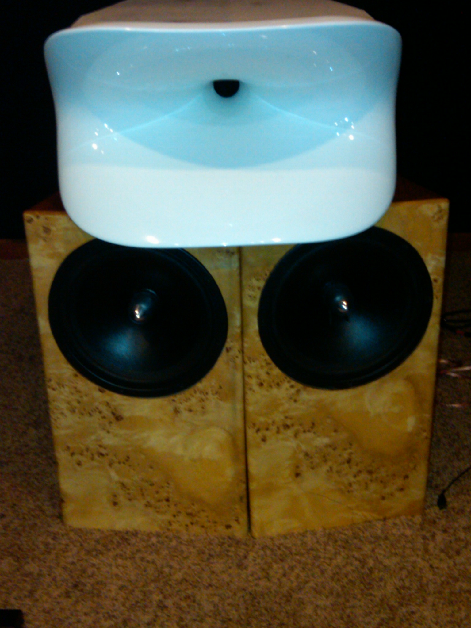

Thanks to Erich and his group buy I have a pair of IWATA 300s. Having a free afternoon I hastily pieced together a system to listen to them. In this case I matched a stock JBL cinema bottom sporting a JBL 2035h driver to a IWATAs bolted to a pair of JBL 2446H compression drivers. The diaphragms in those drivers are not JBL. They are an unmarked 3rd party aluminum product. In any case here is what they look like.
IWATA 300s
I used an AP20 to create a 24dB per octave crossover at 550Hz and then Dirac Live to flatten out the room response. The top PIC shows the 'averaged in room response' before and after Dirac Live was applied. The bottom PIC shows the measured impulse before and after Dirac Live was applied. Altho a super tweeter could be easily justified, the end result is very listenable. I really, really like they way the IWATAs sound. There is no honk or harshness whatsoever. Even tho I am applying aggressive EQ in to upper most bands the IWATA/ JBL combo is not at all tiring on the ears.
The IWATA 300s are keepers! I wholeheartedly recommend them. My next purchase will be a pair of Truextent Berylium diaphragms and see if I can smooth out the jaggies above 8kHz.
Here is a shot from the front.
Those look GREAT!!!!
So I guess everything arrived in good shape on the pallet?
I have a pair of those JBL mounting brackets and the compression drivers as well. Maybe someone could use them like you did.
I love the way those look, good job!
Thanks to you Erich!
I really appreciate your hard work organizing and servicing a group buy. I am really happy with the results from the IWATAs for what was an afternoon of pulling together goodies from my stash. I am looking forward to experimenting with the SEOS-15s that you are organizing for now.
If anyone is interested that is a JBL 2509A bracket that Erich is talking about. It works especially well in this application.

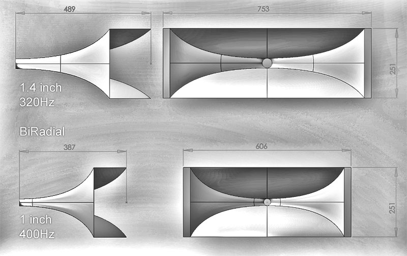

Biradials go into production this week. If you have any suggestion let me know.
