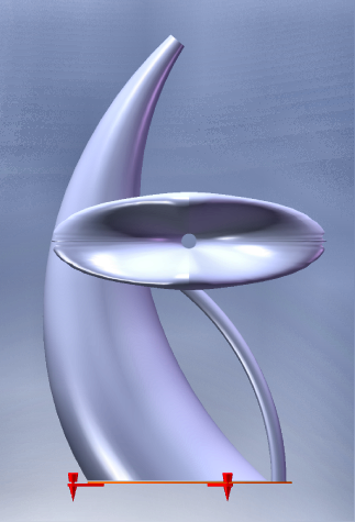

Time to think about new ejmlc300 and Universe. Driver+horn ca. 30kg requires stable support. Maybe nicer is to bend the pipe backward. Speaker spikes done...

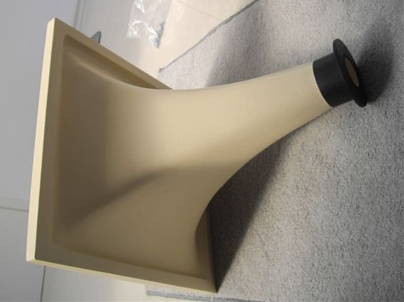

The waveguide/horn Group Buy came in about 2 weeks ago. I've been busy boxing everything up, but thought I would post photos here. Let me say that these different sizes were packed really well and every space was filled with something. Very impressive.
The SEOS waveguide was designed last year by some pretty smart forum members. Even Zilch had his thoughts go into the design and he was really looking forward to trying out the 10" version. He liked both sizes, but thought the 10" was pretty neat. Zilch was actually going to be the one testing these before he passed away earlier this year.
The project started out as a way to replace the QSC waveguide used in many Econowave style speakers that you could no longer purchase. I promised to get it prototyped and produced if a design was agreed upon. I've never done that before but thought it might be interesting. A few forum members figured that if we were going to make a prototype from scratch, we might as well try to make something even better. As the process went on, it turned into a bigger group buy for other waveguides and horns spread over a few different forums.

I had already removed some packing material a few Iwata-300 horns from the top when this photo was taken.
Here's what the Iwata looked like, notice the tape on the front saying there were more horns inside!
I felt like a scientist removing something from an alien's belly as I cut open the tape. :D
They managed to get some big items on this pallet too. Here's a monster 38" diameter horn, with another "small" horn stuffed in it's mouth. And there's yet another one inside the mouth of the smaller horn! (I put a hammer there to give an idea on size)
Couldn't move those big boys until I took out all the small ones filling the other spaces. You can't see this in the photo, but there were even horns inside the shrink wrap on the larger ones as well.
And here's a pair of the infamous "Mummy" speakers that almost became a group buy at one point last year. Someone just wanted to get the empty cabinets. I gotta say, these things are heavier than you'd think and made super strong. I placed a dollar bill on the front to give you an idea of it's size. A 12" pro woofer goes on the bottom and the top is a OS-12 waveguide!
Check out how thick the mounting flange is. You can see the bracing and the rear ports too. I'm not going to unwrap these any more than this. Yes, there were smaller horns inside here too!
Photo of the massive JMLC-200. I'm not going to unwrap these any more either. :D

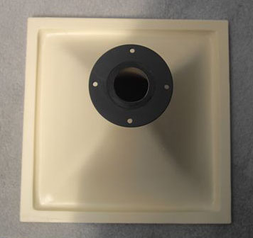

JMLC-200 in the background. Iwata-300 upper left. JMLC-400 upper right. 10" and 15" SEOS prototypes lower left. Elliptical JMLC-1000 in the middle. Regular JMLC-1000 lower middle. OS-12 lower right. I didn't unwrap the JMLC-350 which is larger than the 400 model you see in the photo. These are sitting on closed cell foam, don't worry!
Back view to see the Iwata and JMLC:
Some with color:
And finally the SEOS prototypes:
