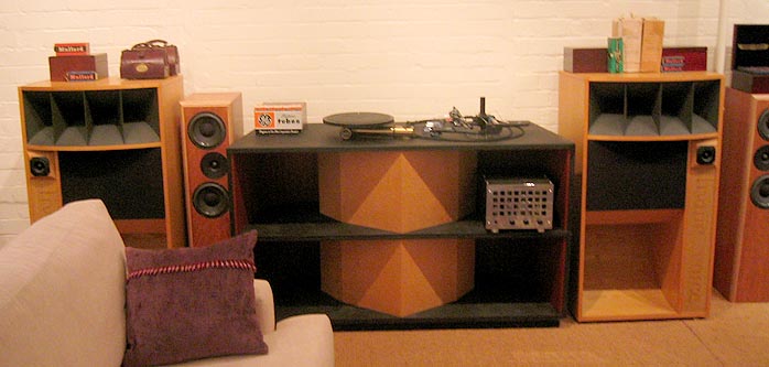

I am thinking Iam not going to talk you into building multi cells am I? Please don't give up on multi cells. 100hz birradial would be a biggy. Bought some biradial tweeters today. evt350s. 200hz hz multi cell would do. Have a look at the living mid horns here. This is what I was trying to explain to you about a simplified multicell. I am sure there is a more appropriate name. E-jmlc-300sound interesting btw.

I think multi-cells create more problems than they solve. It was just an old school way of creating wider dispersion before the engineers figured out constant directivity and directivity control. I think everyone is better off with one of the designs already available then for Jack to make a multi-cell design only one or two people are interested in.

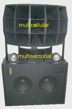

Hello
What you show on the pîcture are most probably multisectorial horns.
Here attached a picture of the 4ways Onken system with a low-mid multicellular horn and a mid multisectorial horns.
Best regards from Paris, France
Jean-Michel Le Cléac'h

Yes multisectorial horns is what I was trying to demonstrate.I love both multisectorials(new sticky too) and multicellular.
