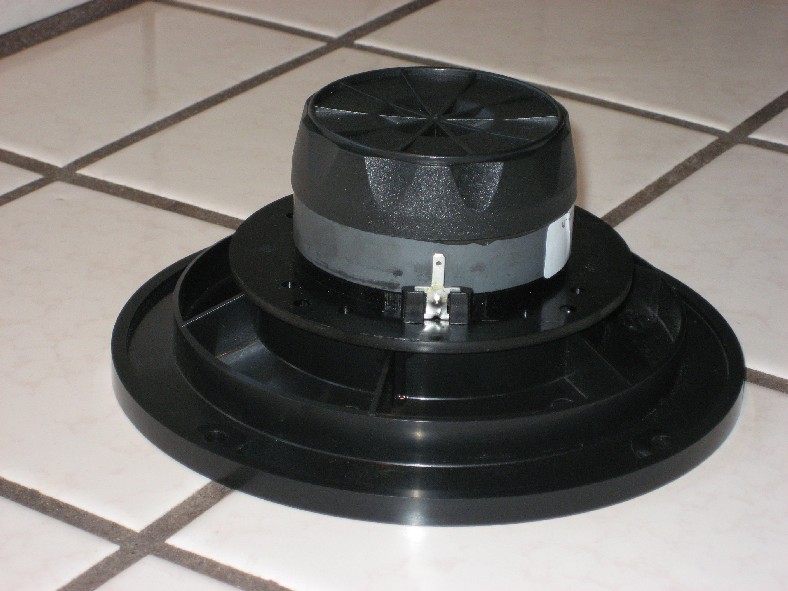

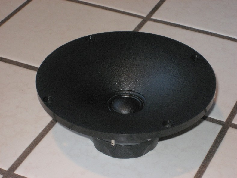

I have been building Zaph's waveguide TMM the last two weeks.
Just finished the tweeter mounting with a new twist (see pics) !!
The TDFC tweeter has been bonded in place with epoxy.
The type of epoxy is critical (I used high impact golf shaft epoxy) but something that has a good bond and is not brittle should work !!
I find this was easier than the original method and may be what keeps many from this design ??

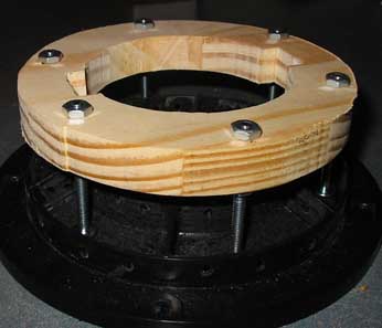

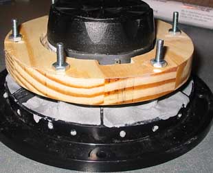

I took the waveguide and made a jig to hold bolts in place in the correct locations, with a nut on top and below the jig it can be positioned high enough to put epoxy in to hold the bolt heads, I ruffed up the surface with a Dremmel tool and drilled small holes to help hold the epoxy. Oatly epoxy comes in a roll, cut the portion and knead to mix. Then with jig removed just set the tweeter in place, put on the jig and secure with nuts. Tweeters can be removed , switched and reinstalled without removing thre baffle.
