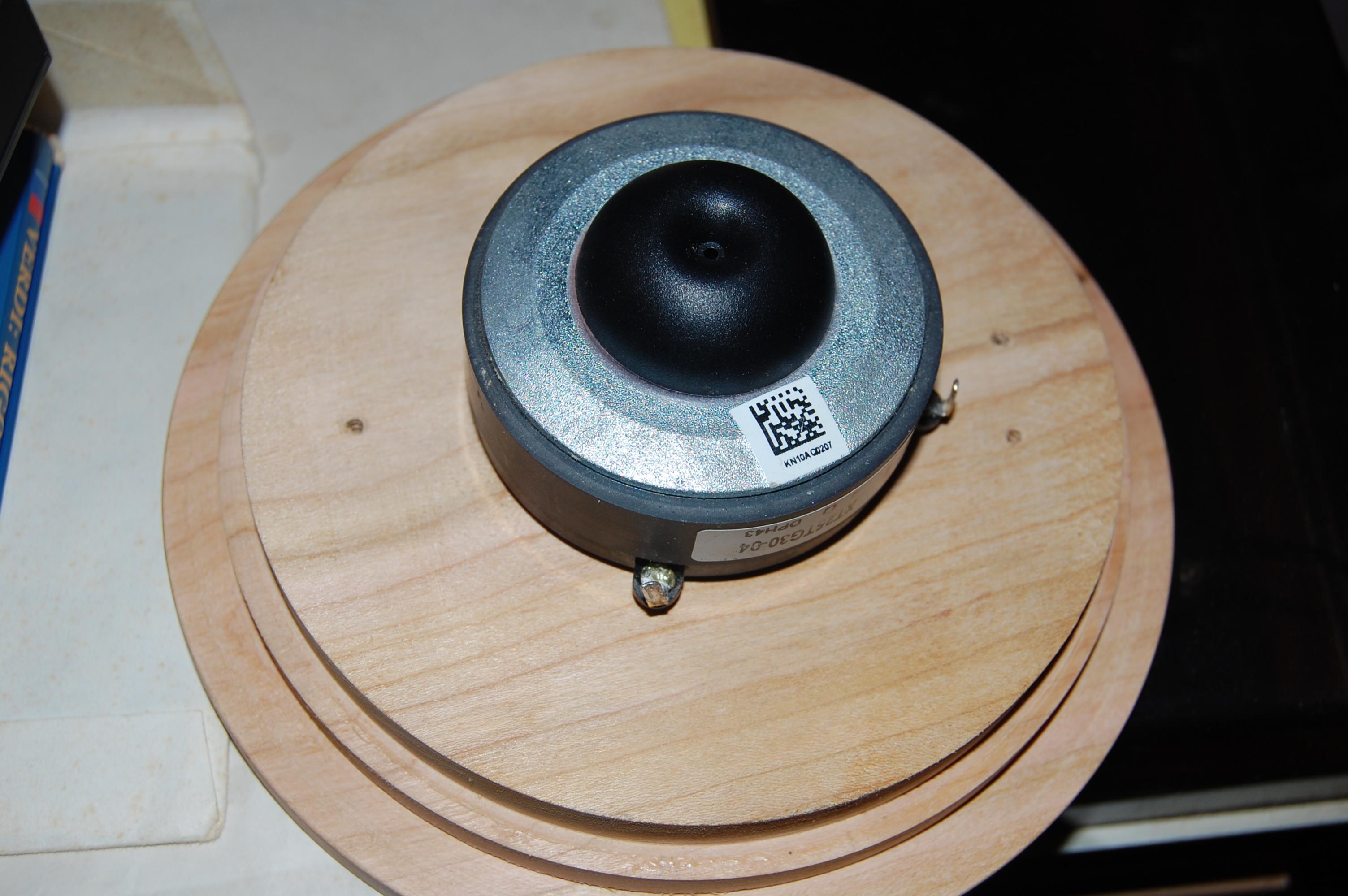

I found a profile on Zaph Audio website for a 6.5" waveguide and turned a couple yesterday. I made the overall diameter 7" by adding a 1/2" edge to the profile.

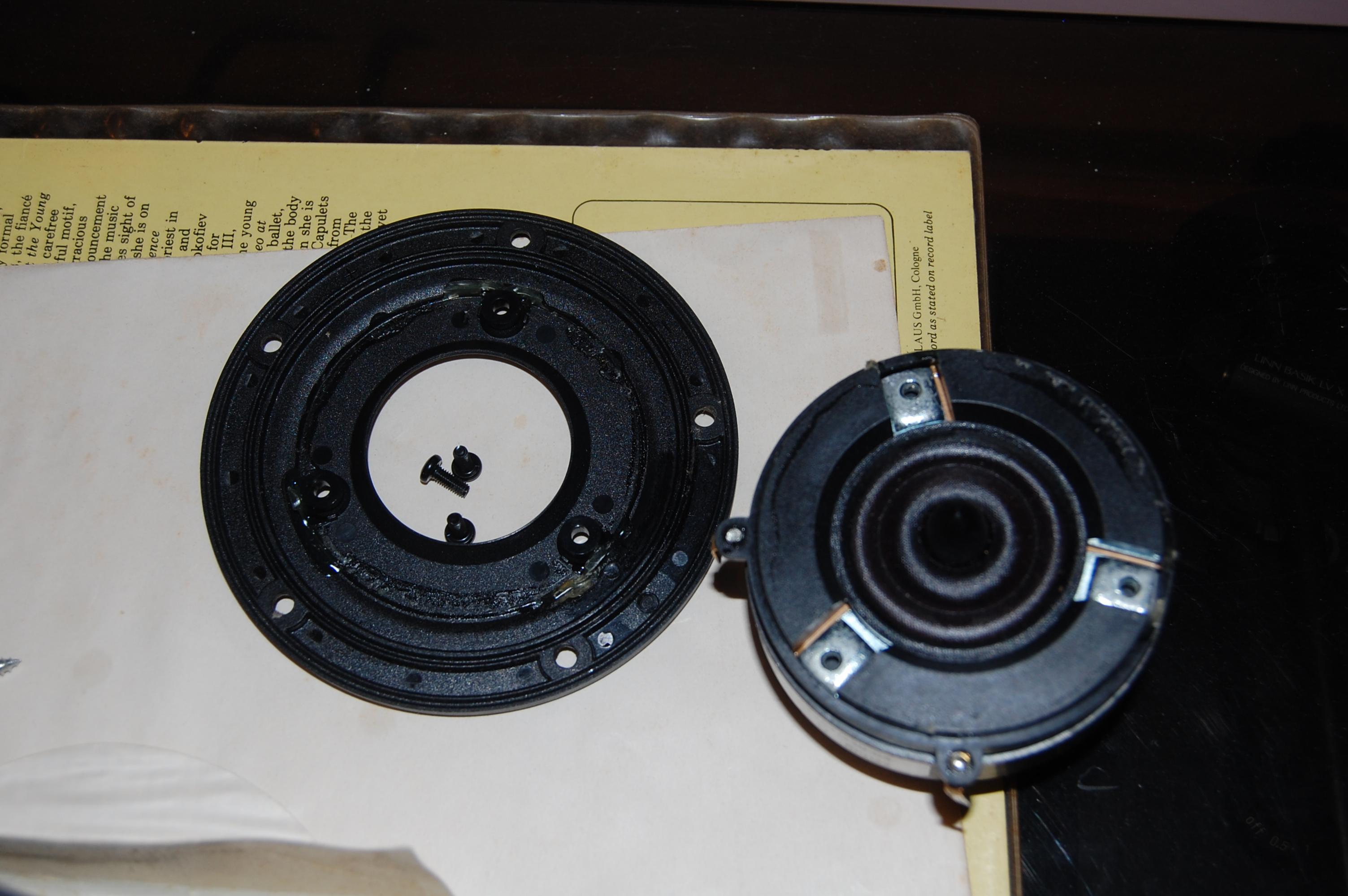

Some people think the later XT25 faceplates are glued to the tweeter body. Mine aren't. After removing the 3 screws that attach the faceplate, the separation of the faceplate required carefully inserting a sharp knife at the joint and the plate slowly separates.

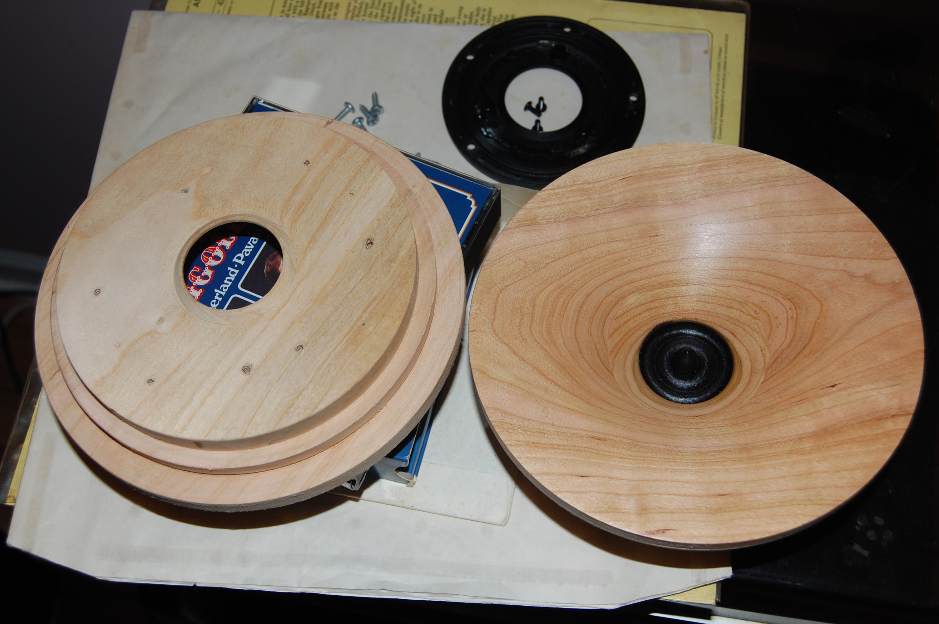

Here are 3 pics, one shows the small bevel required to closely fit the face of the XT25. This detail came from Troels' website. I now need to make a couple of wood plates to be located at the back of the tweeter to secure them to the WG.
Test assembly will have to wait until next week.
Peter
